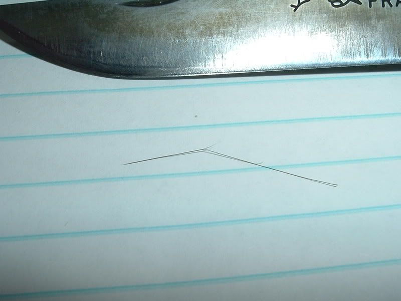

Here are some pics. I did this with the Victorinox Soldier in my pocket. I sharpened it this morning on my sharpmaker and finished up with the UF rods, I even used it a couple times today before I whittled the hair. You have to hold your hands very steady to keep from cutting through the hair.

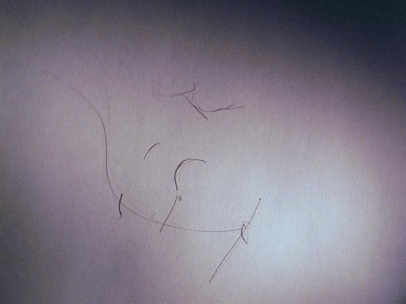

My first try at getting a blade hair whittling sharp. My hair is short and thin so it was annoying to hold onto it. I also didn't to cut too much into it because before i ended up cutting right through it.
Started with a DMT coarse, then spyderco medium, spyderco fine, and some white stropping stick on some cardboard. Knife is an Opinel #6.
