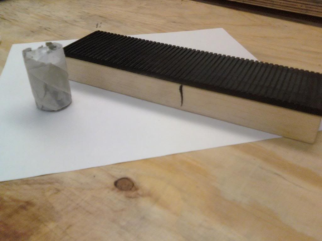

A little late to the party, but thought I'd toss this in anyway. Have had pretty good luck working higher carbide steels using silicon carbide both in grit from a stone,and in various blends of graded SiC as I tested my home brew compounds. I have no idea what size the carbides in s30v are supposed to be, but I am not seeing any tear out, nor when working with D2 (though D2's chromium carbides are not quite as hard as SiC, so not surprising). Had to take a closer look as the conventional wisdom doesn't quite support my observations...
Anyway, have been doing a bunch of follow-up as time permits on an s30v Bos HT. Best results at very high polish have come from EEF diamond plate followed by diamond lapping film. Stropping with 1u diamond paste was barely distinguishable in use from my silicon carbide compound, though 1u lapping film did work very well and produced a much higher polish than the 1u compound. This steel is quite tough once the particles size drops down into the single digit micron range. Easier and a bit faster with diamonds, but mostly when using lapping film. On the strop, both minerals seemed to have some issues though worked fine.
Last test I did was to simply do my usual Washboard (had to use 800 grit 3M instead of the 600 grit Gator brand), in any event, a medium finish on the wet/dry, then a heavy dose of WB SiC compound on a sheet of paper. Did just like the 'best practices' video and rubbed off most of the binder and larger abrasives - finished off on the fine stuff. I had to use a bit more elbow grease, but then the WB is made for a heavy hand. I generally work on grinding media at between 1 and 4 ozs, on the WB with paper and compound it can go as high as 4 lbs. Had to lean on this one, but it came around nicely. Could just treetop some leghairs and I don't believe I could have gotten it much finer with this set-up (I grabbed one of the cosmetic blems from my latest run of boards because they're just plain nicer than my old prototype).
The D2 came around a bit nicer, treetopping leghair with authority.
I have no idea how this would work on s90 or s110v, but the s30v edge doesn't really look a whole lot different from other edges at this level of finish - no evidence of carbide tearout, or even much in the way of edge micro rounding etc, at least that can be seen with an optical microscope. The micron calibration strip upper left is just under 4u at 400x, and 1.5 at 1000. Not exactly sure what is going on, but for a fairly refined edge the SiC appears to capable of playing ball a bit longer than the conventional wisdom might allow.
And the WB - finally pouring my compound into a nice mold, no more lovin' spoonfuls!

For a truly high polish on s30v, higher than my "utility" SiC compound, the 6u/1u diamond lapping film on my Washboard did a nice job - better than my DMT EEF even followed by 1u diamond paste on strop. With a small splash of soapy water it really felt just like a waterstone. I'll have to take a few more pics when time allows.
All said and done, it seems to prefer a medium grit finish in much the same way a high RC carbon steel prefers a finer finish.
