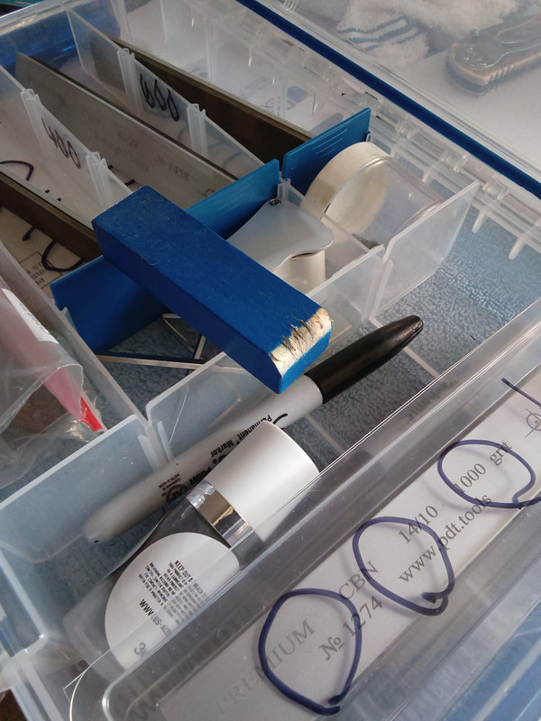

I deburr using a Jenga game block. But my Jenga pieces are the knock off painted ones.
I remove the paint on the end across a sanding belt. Get it bare wood, end grain.
Some steels will really burr. The Jenga block will wipe the burr off. After 400 grit when it starts to matter. Jenga rub on 600. Rub after that on 1000.
You can see the burr metal stick in the wood. So you gotta run the block over the sanding belt again to clean the burr material out of the wood. One Jenga block will last forever until you get tired of sanding the end down.
I see... Jenga (wooden) block.
So you don't use any stropping compound on the block?
No Sir.
Let's say you've finished with the 400 grit. There's a good burr you can snag a paper towel on. Before you move to 600. You wipe the edge from heel to point and then point to heel. Two total swipes. Repeat after you're done with 600 and so forth.
Plain wood. No compound. End grain. Here's the current Jenga piece I use. (It needs to be cleaned again.)
Now I see. You are not using the wood as a strop but you cut into the wood to tear off the burr.
Right?
