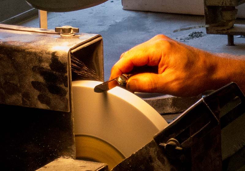

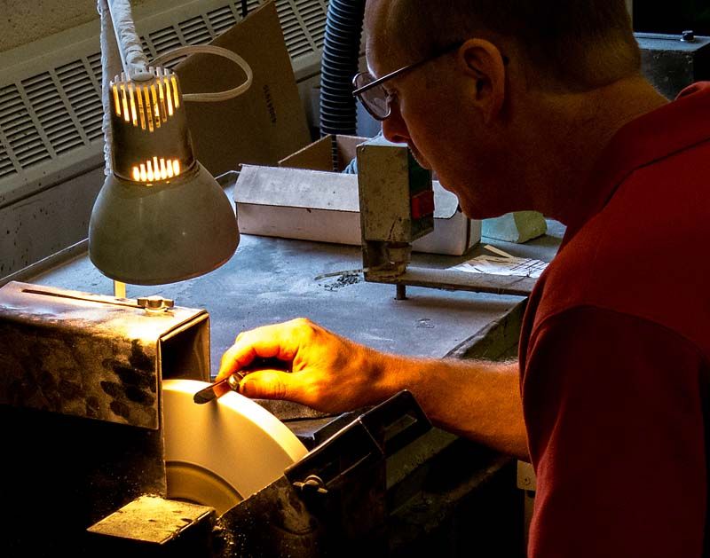

Here's a shot of Bill of GEC putting an edge on his son...Bill's...knife
IMG_1684.jpg~original
IMG_1685.jpg~original
very nice work he did as well :)
