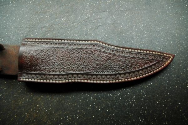

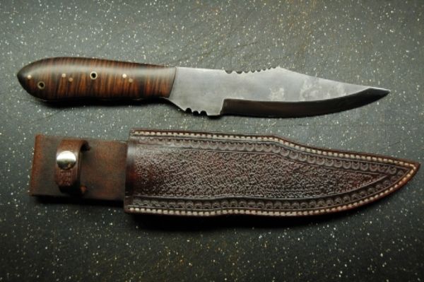

Gonna throw this one in. Just finished it up. It is made using 8-9oz double shoulder veg tanned leather, dyed a reddish brown and hand stitched using artificial sinew and finished with Montana Pitch Blend leather dressing for waterproofing and conditioning. The first pic is a tad dark, crappy weather prevents outside pics.
Sheath is looking good so far rotte. I don't think there is a benefit to free handing .I'd prob be much better off with a plan but it's just not me. I dont really plan anything I make or carve . Things would prob come out alot better if I did plan.

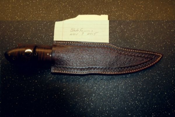

Very nice sheath and cool knife. Love it. Stitching looks great. ...but, doesn't qualify for the contest. The first picture must be of the materials prior to assembly, along with a dated tag that says "Bladeforums". Sorry to be a stickler, but I want everyone to be sure that the sheath was made as part of this contest. Thanks; there is plenty of time to enter your next sheath!

Lol no worries man, I will have another ready for sure. I guess I should read more. This one was just completed but I did not take the starter photo so I will step up with another.

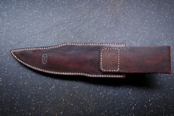

I finished sewing the sheath this evening. Then treated it with some Neatsfoot oil and then some Montana Pitch blend for water protection. Finally, topped it with a bit of Lincoln Wax for a little shine and a tad more protection. Burnished the edges with an old dowel.
My belt loop got canted a bit....uh, I did that on purpose, yeah; I like a 5º reverse cant in case I'm working from horseback, yeah, that's it.
I think I need to do a little more finishing work before sewing in the belt loop. In this case I skived the ends and ended up skiving some of the end off. I should have stopped, re-cut a belt loop, and then finished it up before sewing in. Live and learn.

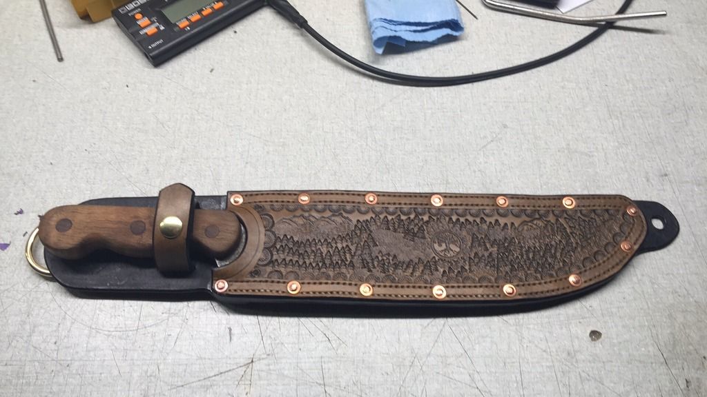

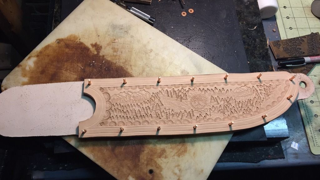

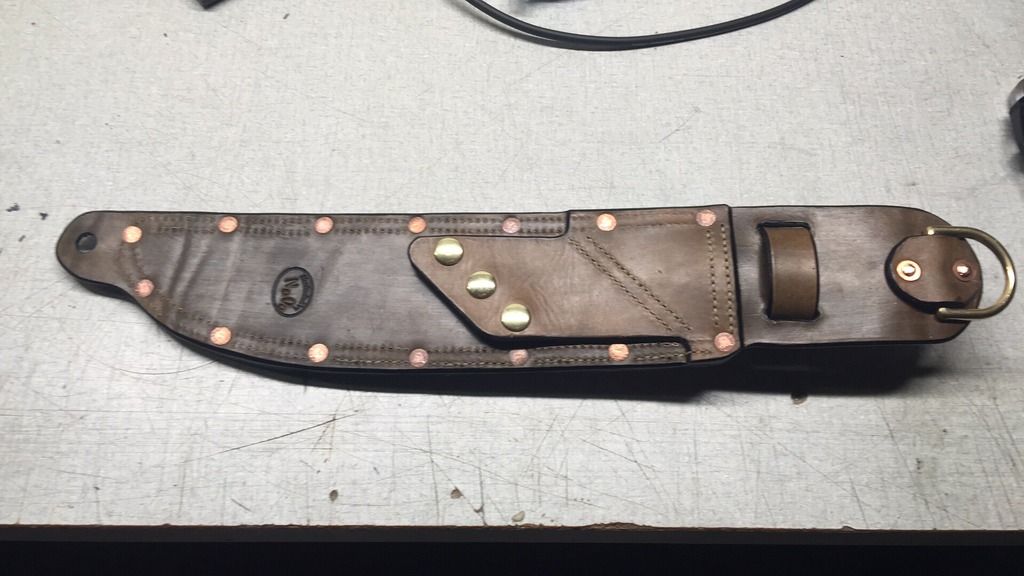

here is my latest project. Made it for a good friend who works for USDA hunting asian longhorn beetles. Left-handed cross draw machete sheath. 30 sections of hand stitching and 16 hammered rivets....
