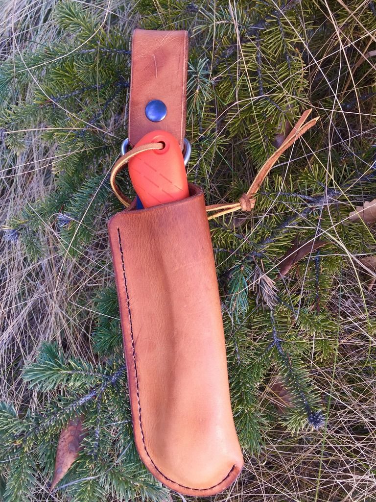

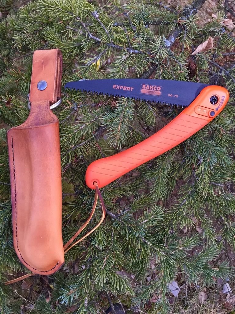

I missed this one. Very cool. I recently made one as well for my saw. I made mine a scout carry though .

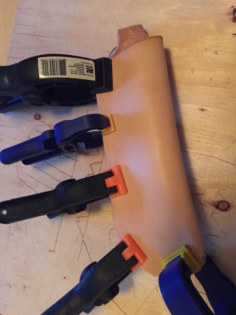

I also gave up on the clamps when glueing the sheath up.
Contact cement on both pieces and allowed to dry, then stuck together, will stick fine.
I give those glued edged a tapping with the mallet as well.
