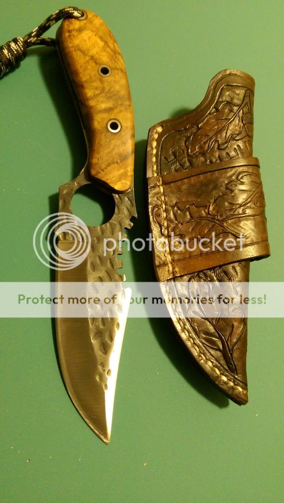

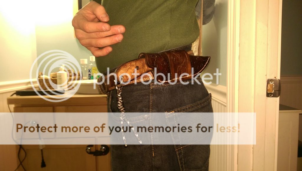

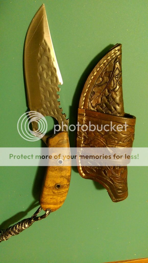

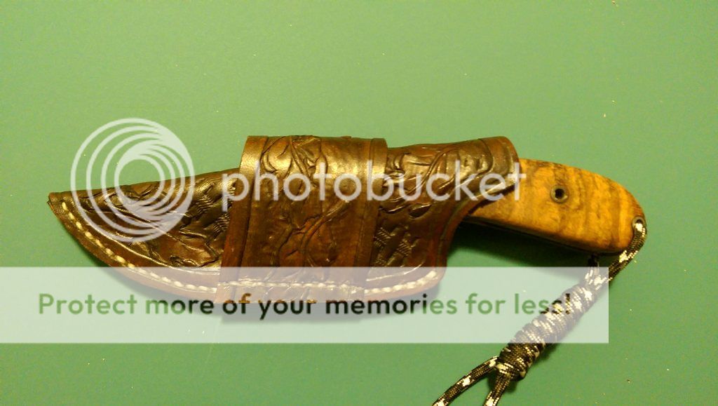

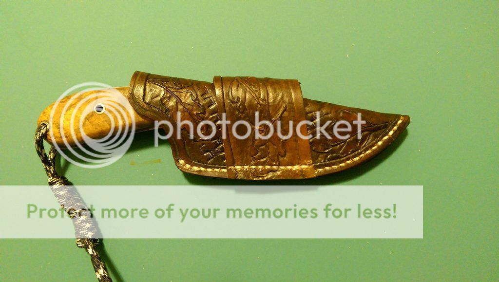

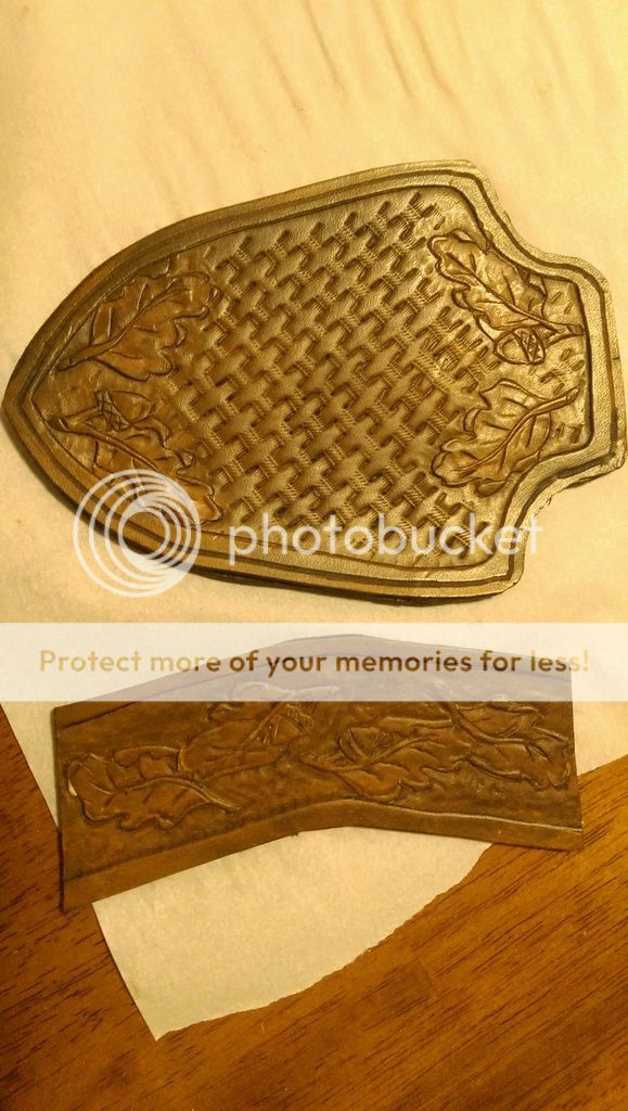

all parts are glued
saddle stiching
knife is made by friend,his take on Mora knives
wet forming the sheath
finaly,beeswax is used for waterproffing
Great looking sheath....and knife, rinos.

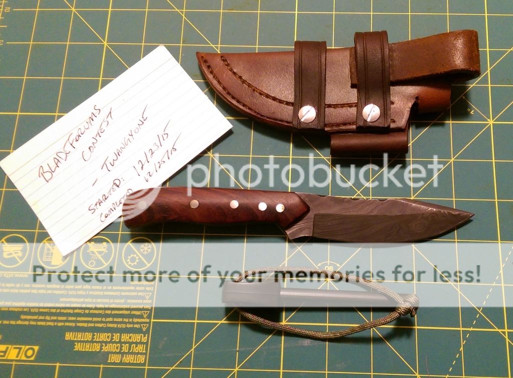

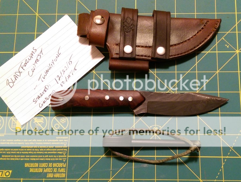

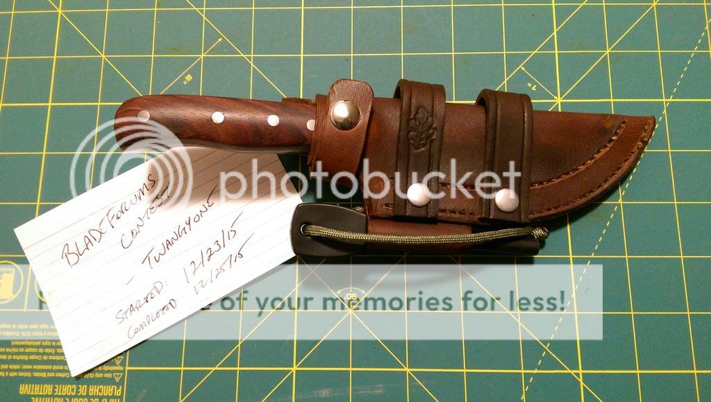

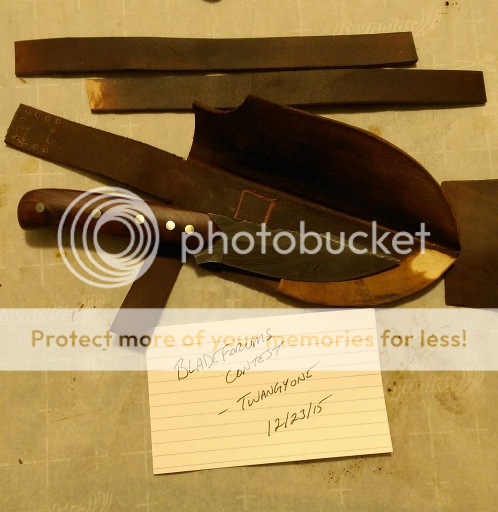

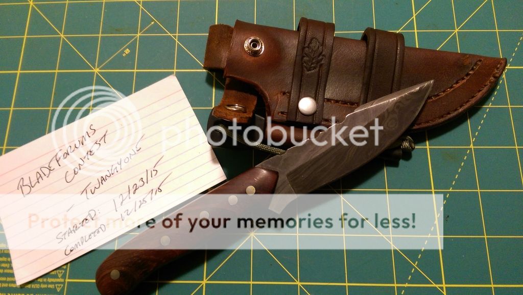

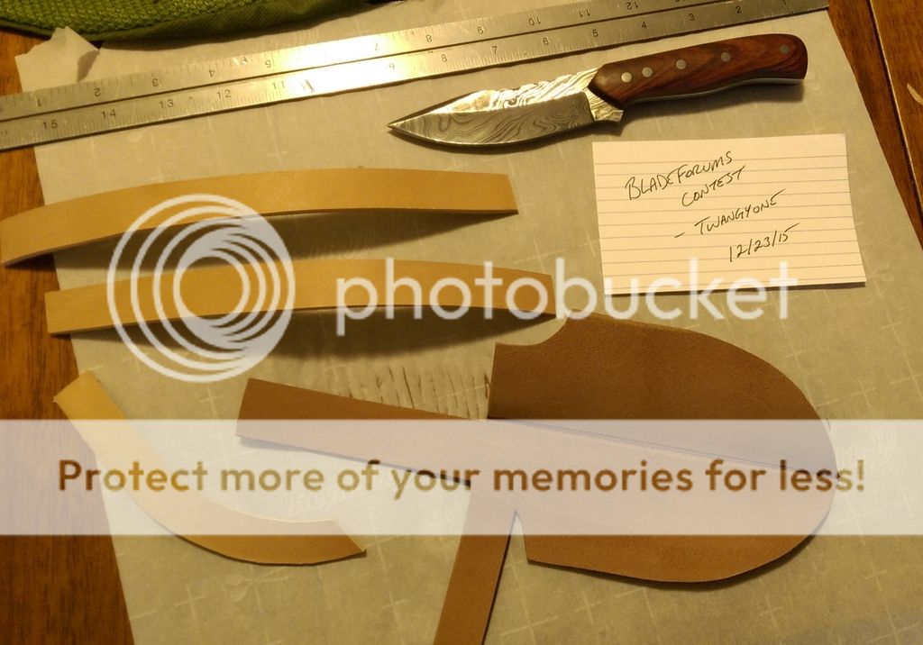

Wow! some great projects in this contest. Unfortunately I didn't know the contest was going on, but I was already making my first sheath for a Christmas present. Here's some pictures, unfortunately I don't think I can qualify for the project since I didn't date the photos (and it's already wrapped and under the tree) but I had a blast and can't wait to give it to Dad. Still on the fence about the lanyard... I'll leave that one up to him.
Alright... I unwrapped Dad's gift to get some pictures with a sign. Then I realized what you meant on the last message so lol. I thought you were inferring that I use this one for my entry. I plan to make another soon so maybe it will be finished in time. If not, oh well, it's a fun hobby regardless of prizes!
