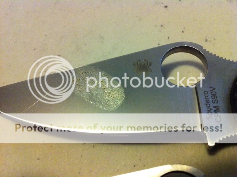

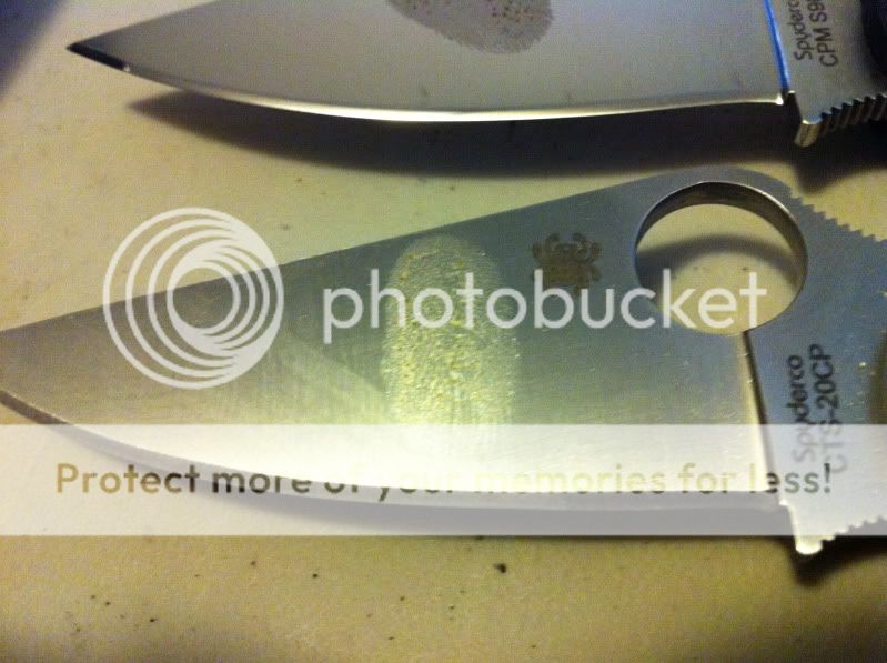

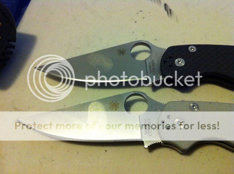

As promised, I touched my sweaty forehead and pressed it onto the blades of both knives with my finger(so there's sweat, and whatever oils are on my skin). Here are the results about 12 hours after I did that:
Both knives faired about the same, and the resulting crud was easily wiped off with soap and water. I did check about 2 hours after applying the sweat, and found nothing much aside from the fingerprint. I wouldn't take the knives to saltwater, but it's stainless enough to hold up to all but the most abusive negligence. So unless you're cutting citrus and you leave the blade unwashed for over an hour, it's all good:thumbup:.

Interesting but gross, :p
