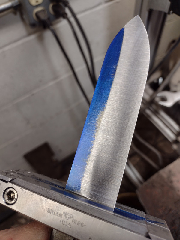

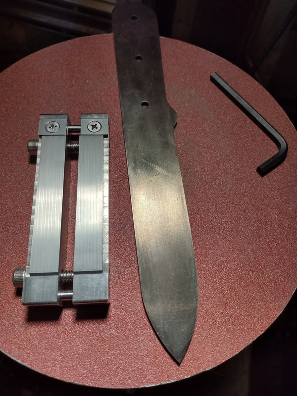

Seems spine and handle are flat I glued this piece of micarta to jig so I don t need to adjust blade position every time I switch sides .I grinded several bevels in different angle and then all that grinded on slacked belt .........with my jig of course .
Forgot to take a picture of all those bevels. they looked so cool :)

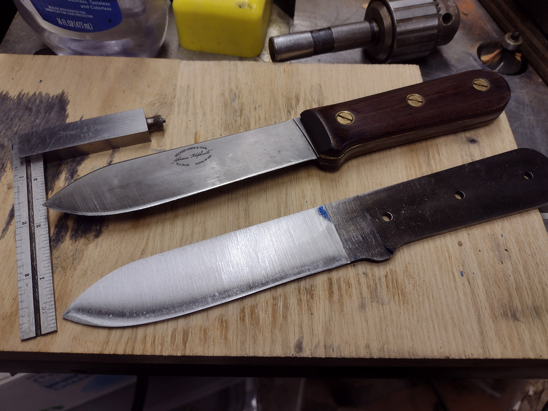

And here it is ....................it is 0.10mm on edge , I will sharpen it in normal way on 20 degree and then flush everything with hand on soft backed sand paper ...I like how stiff is blade , if it was full flat it would flex lot
I tapered one side of handle and I after that drilled holes for pins .I almost forgot to do it before I taper other side 😂 What I will change are pins , I will use one 3mm then 6mm and last one 9mm .I also drilled that two holes to remove some weight from tang . I have scale from walnut only 10 mm thick , that is not enough to make that *guard * ? It is to late now so I will taper tomorrow other side, thickness would be 1.5mm .
I forgot to mention . . .. .. . When I grind bevels with jig on grinder I never pass over with tip of blade center line of belt for several reasons, but irrelevant here .So when I switch to grind on *slack belt* ..when tip of blade came in the middle of belt ......................tip of blade was GONE 😂 the tip disappeared / about three millimeters / in a millionth of a second !! I understood why, but it was already too late :( I reshaped the tip of the blade and done job ...... live and learn :(
Ready for handles and for convexing edge .I tapered other side and since now both sides are equal, I surface ground in one pass the other finished side with 40 grit belt so epoxy can hold better .
It is 1.5 mm. on butt
110 grams

Finish on bevels is from 40 grit ceramic ...one of advantages of using a jig :p
I like how it cut ......blade thanks to angled cutting edge *stay* in that area . it does not go forward towards the belly while cutting ...
