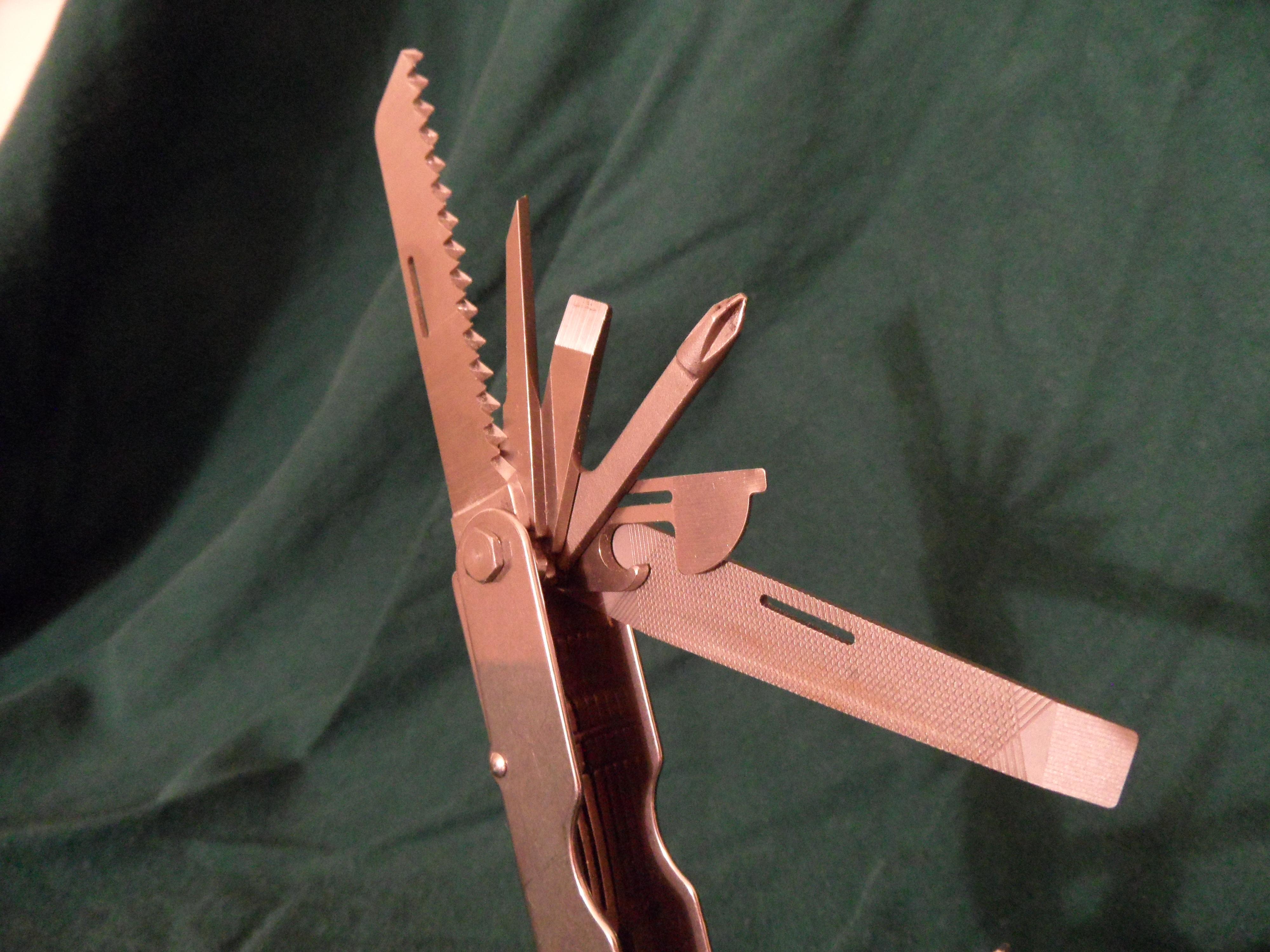

What do have against curves! those 90 degree edges will dig into your hand and the straight handles will not be comfortable. folding saws are actually really nice tools, they are light, and cheap and work really well. Saws in knives are never a good idea. nice work with the CAD though that's really nice.
Also if you will have to have some abrasive machining, if nothing else the edge will have to be abrasively sharpened, so the straight edges and other design features may be unnecessary, or nonfunctional.
On whether or not my saw design is functional I direct you towards SOG
Just a heads up, the teeth on those are at a much Higher/Lower angle to the "side" of the saw, then yours are. I hope that makes sense.
With your blade standing upright on the pommel teeth facing you...Measure the hight first tooth on the right and then the first tooth on the left. Looks to be around .120" difference. That would make around a 26.5 degree angle. The SOG looks more like 40+ degrees.
