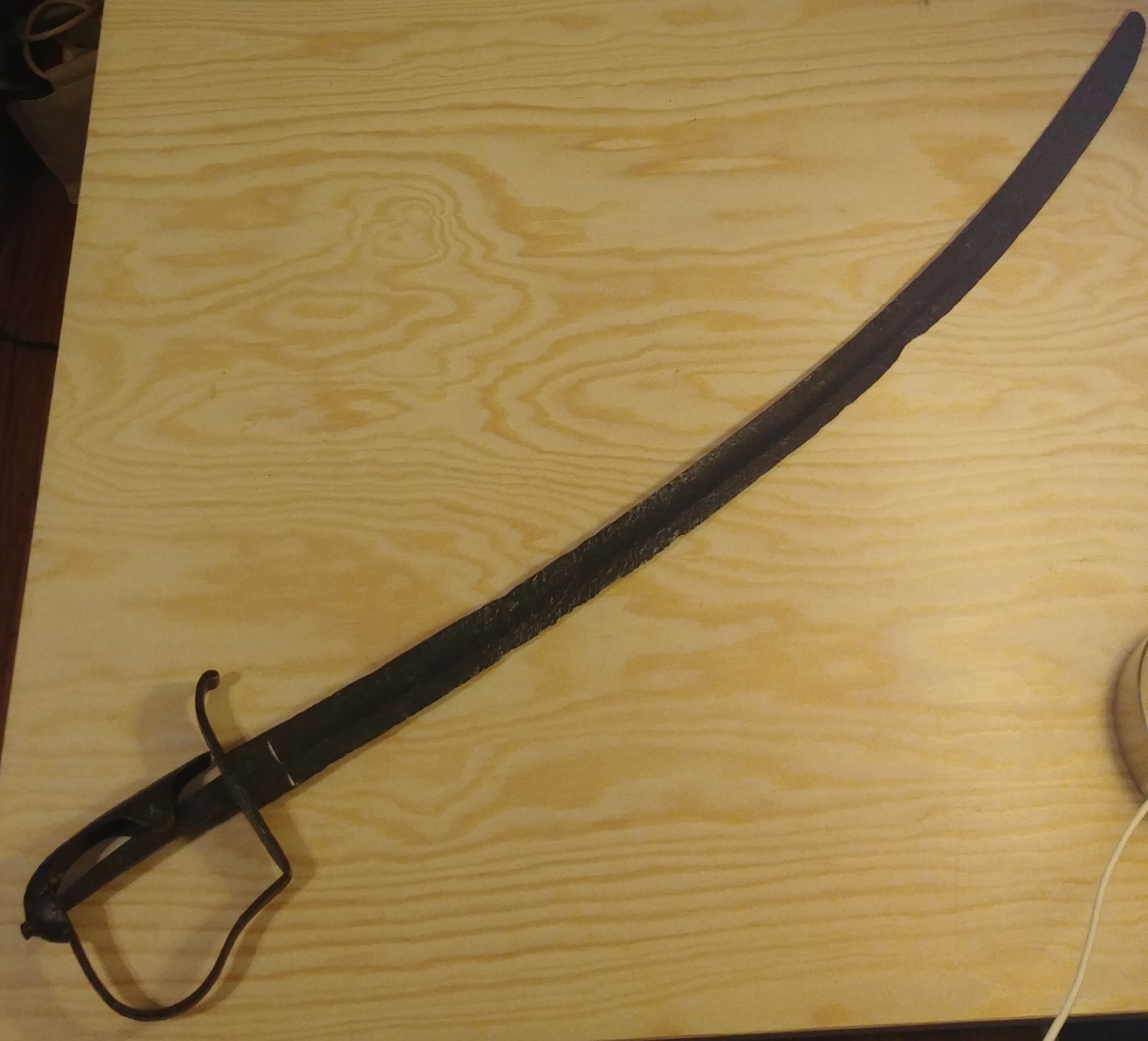

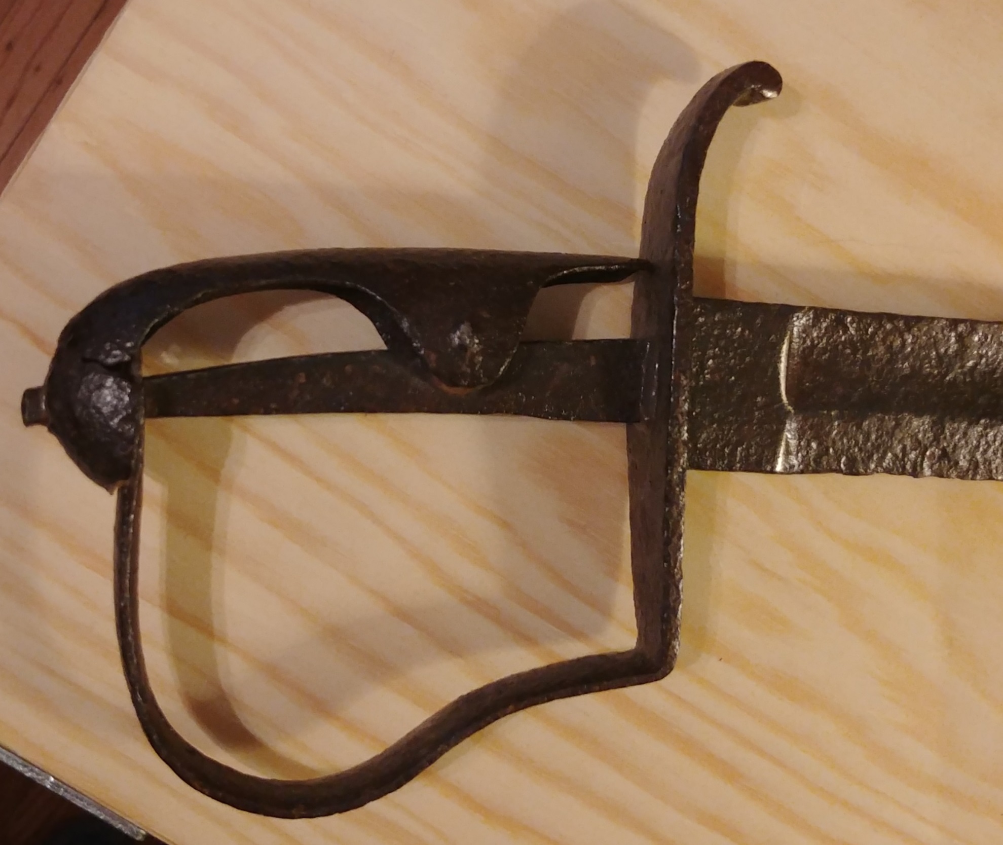

I'd be very curious to see a military sabre with a U shaped handle. I've examined a few antique military sabres, and I've never seen a U shaped handle on any of them. The tang of the blade goes through a center hole in the handle, and the metal backstrap is a separate piece on top of the (usually leather-wrapped) wood handle core.
I've done a tiny bit of Italian classical dueling sabre and heavy sabre training (these are adjascent to the martial arts I primarily focus on), and I can't imagine a U shaped handle surviving very long given the force they cut with.
-Tyson
Edited to add photos of a river-find condition antique sabre (probably Portuguese, but who knows?). This is helpful because the non-metal pieces all rotted away, and the metal all rusted together. In the hilt close-up you can see the tang of the blade, distinct from the backstrap.
