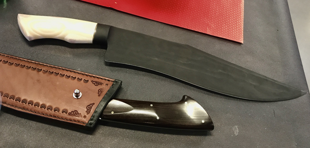

Made this for a customer in the martial arts field. My interpretation of a bowie knife.
The Kaiju
Z-Finit @60HRC by peters heat treat (with cryo) 0.226 thick
7.5 inch blade full flat ground handle grip is 4 inches, the customer has some big hands!
Has kukri like handle angle and chops exceptionally well. Rear hook for knife retention (requested by customer)
He currently uses this to impress gis students at his martial arts studio. But mainly he uses it instead of a cleaver in the kitchen. Chops through bone with no damage.View media item 1391View media item 1389View media item 1388View media item 1387IMG_20170307_172801.jpg IMG_20170307_172801.jpg IMG_20170308_203758.jpg
