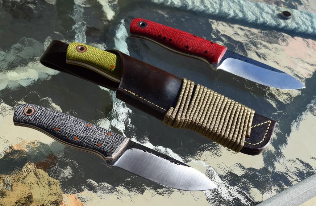

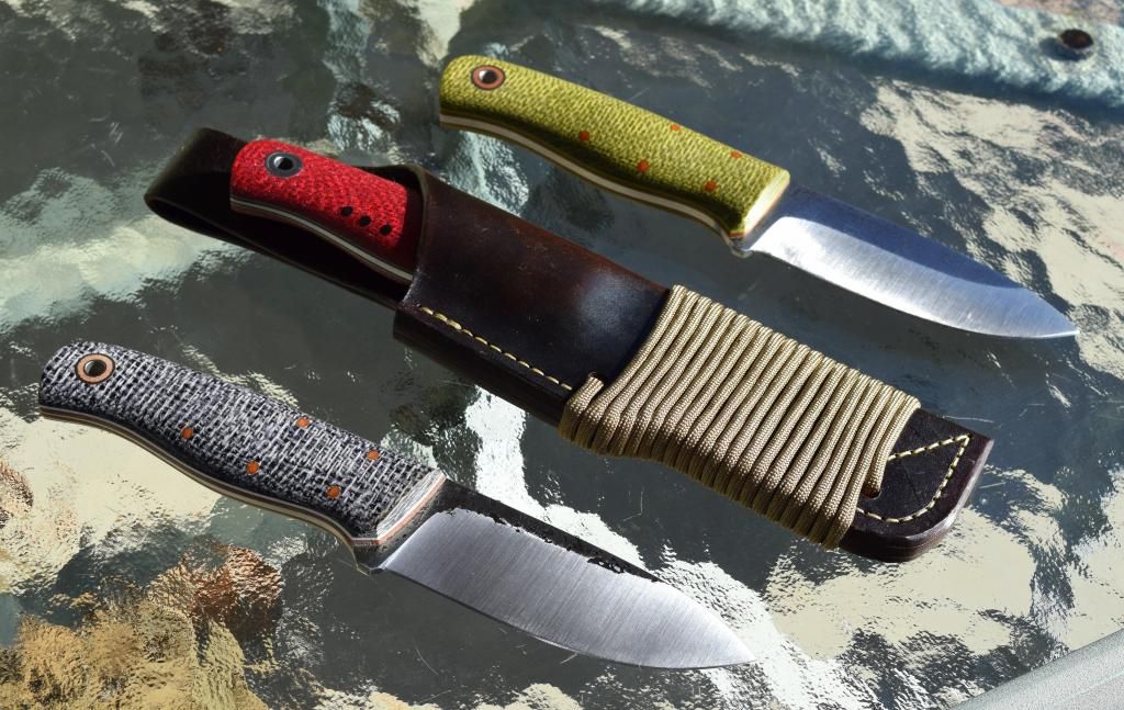

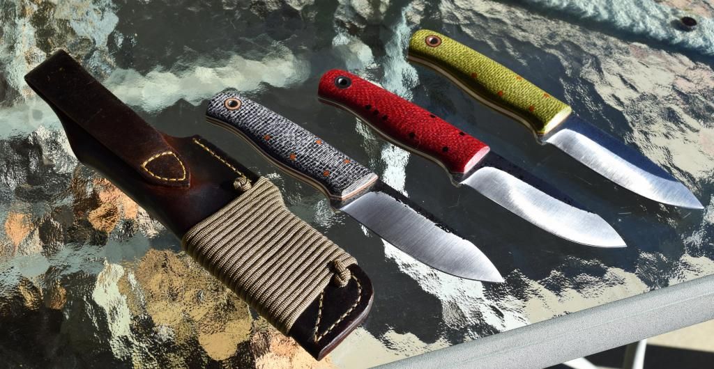

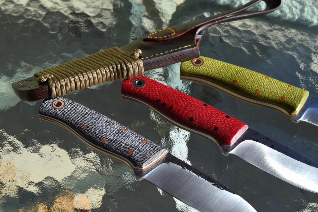

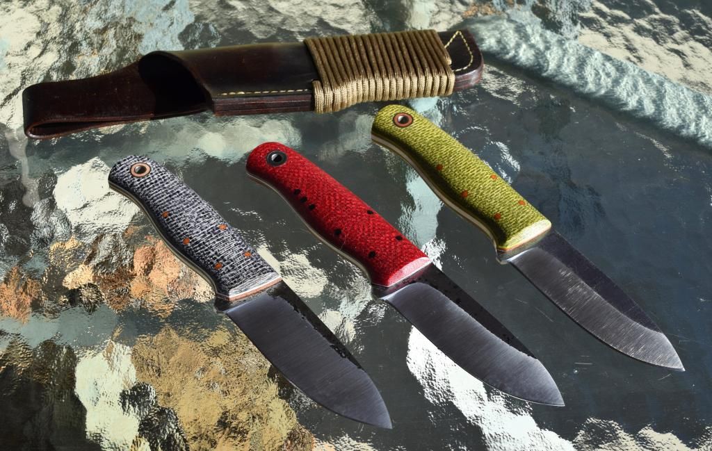

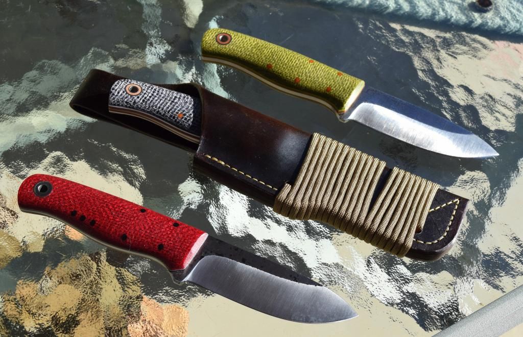

I received a very nice surprise box in the mail last week. It was sent by my friend Phillip (a.k.a. M4Super90.) It was a custom Bushcrafter sheath that he made for me. This was Phillip’s way of saying thanks for a small favor that I did for him recently. I wasn’t expecting anything in return, but that doesn’t mean that I don’t appreciate a hand-made gift from a good friend.
Phillip told me that he followed the sheath making tutorial thread earlier this year. He bought the necessary equipment and started making sheaths. He obviously leaned well because the craftsmanship on this one is top notch. The stitching is very even and tight and the edge finishing is very well done. I like the longer belt loop that positions the knife lower on the hip and provides enough swing to move the knife out of the way when sitting down. It is sort of like a dangler without the extra dangler hardware. He even wrapped some handy paracord around the bottom half of the sheath and secured it through the eyeholes. Overall, I am very impressed with the design and execution that he put into this.
Phillip knows that he and I share a common love for the Bushcrafter. It is the only model that I have multiples of. I have three with only one sheath between them. He has assembled the definitive collection of many more. Since he knew that I had only one sheath, he figured (correctly) that a custom sheath would make a practical gift. The timing was perfect because I was just starting to think about ordering another BC sheath.
The rich dark color of this sheath looks great with all three knives. Now I just need to decide which knife gets to call this one home. It will probably be the Emerald BC because that is my main user knife.

Awesome pics (and pants Phil) & kudos to Phillip for what appears to be a FINELY crafted custom BC sheath. Nice work gents :thumbup:
Well done on the sheath and the thoughtful gift that it is. Cool way of attaching the paracord and some very nice finish touches that I can see.
That thar is one fine looking sheath, and all of your beautiful BCs look great in it Phil. Phillip did a great job.

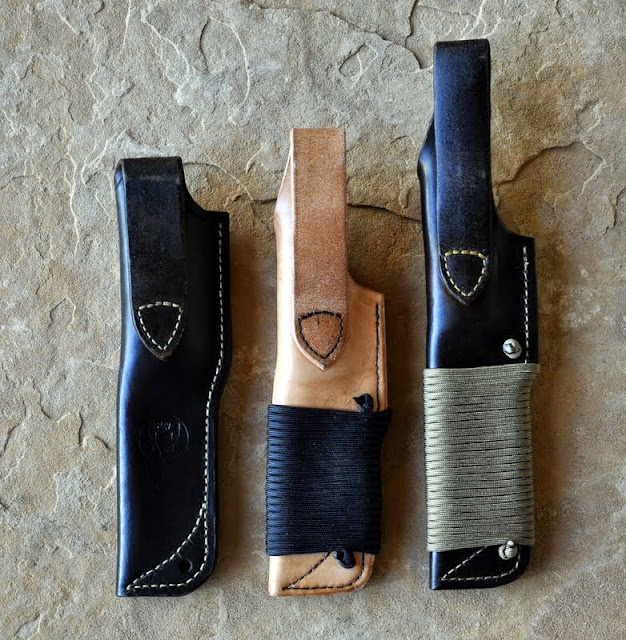

Thanks for all the kind words. Other than the stitching, it takes just about as long to make one as it does two. I made a stretch version for a new to me IW BC Sr. at the same time:

I would have to cut the paracord off (as intended). I took some other photos. Please let me know if they show what you are looking for. The 2 photos below include a second try at a bushcrafter sheath (left), the prototype of the version I made Phil (middle), and the stretch version I made for the BC Sr. (right). The second try was too hard to get the knife out and rode a little too high for me. I eventually started making prototypes that I would use to evaluate in the field and then make another change, repeat. Easy enough to make mods as it was used and then take the carved up prototype and make the new pattern. I stopped spending time on finishing touches, dyes, etc. during the eval process, as that is a lot of time during construction. Eventually, I got the design to the middle one and left it alone. It took about 3 tries from the second to the prototype. In this version I had settled on how much knife handle I wanted exposed. I had also changed my welt to incorporate the upper hole for the cord, as I never found a way that the cord would stay wrapped.
I included one of the patterns so you can see the offset in the current generation. The white is the added offset and the darker part is the original design. As you can see from this picture, the external curve on the prototype BC sheath is lower, but the welt curve is the same. In the BC Sr. sheath everything is the same as the prototype but the length has just been extended to accommodate the extra 1" of blade.
