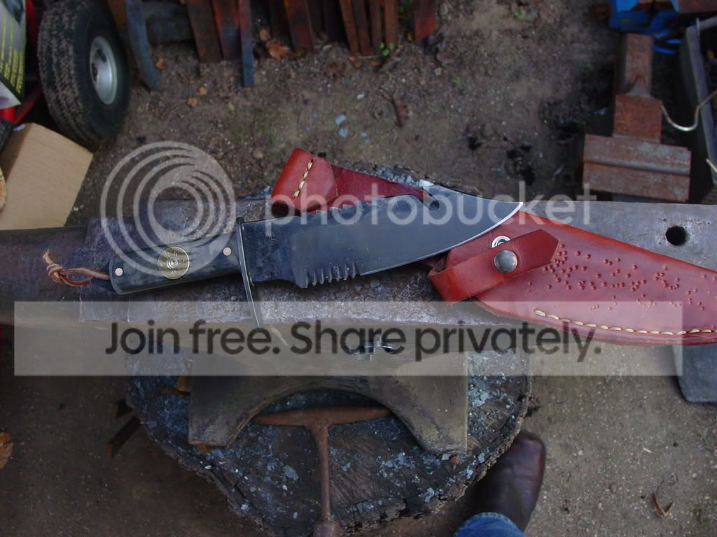

Here was my first attempt. I used a pair of old khaki pants.
Sorry, I can't get the pictures to show bigger than about 1 inch. I will have to figure it out soon.
-Mike

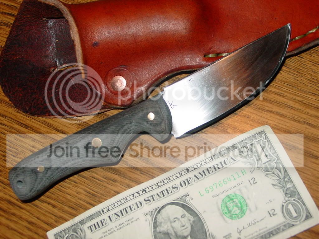

black felt mycarta with red felt liner
black denim
i like the black felt allot, it has an organic look and feel to it. nice and hard. its my new favorite handle material. i dont have a press so i lay up my mycarta on foil between two blocks of wood and put my anvil on top. next time im going to try parking my jeep on it.
