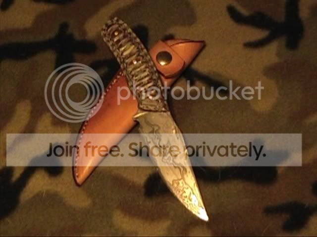

not a great pic but here's some tuttifrutti(?) from Butch... :cool:
Reminds me of fruity pebbles cereal (one of my favorites growing up).
:D
Charlie
I think that's actually from an earlier run that was indeed dubbed "Fruity Pebbles". "Smashed Hippie" is a slightly different recipe I think.
-d
that batch shown on the little hawk was from a batch i had called fruity pebbles
i have no more of that batch
the smashed hippie batch was the bright block i had just made
more colors coming down the pipe including black and bright orange and another batch of burlap

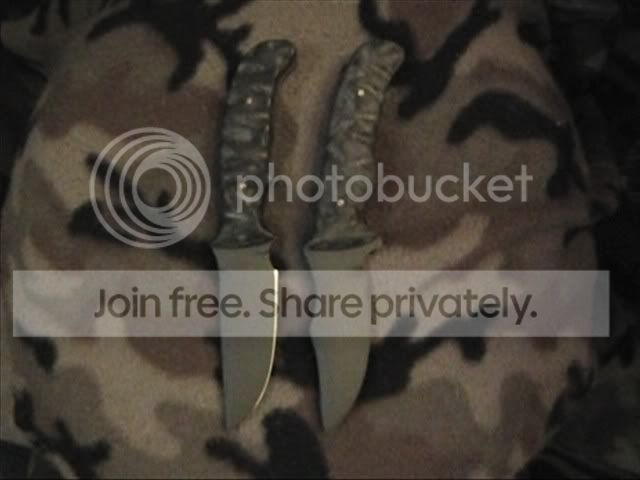

Not sure if this counts, but here it is.
I just received some Todd Combs blue-glow burlap (it glows in the dark!). I inlayed some desert ironwood. It's not finished yet, but it's getting there. This is my first time working with synthetic handle material.
Phillip
