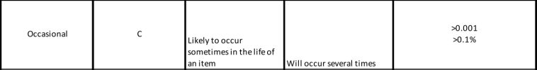

Apparently there is a document (FMECA) circulating that seems to indicate that Sig knew about the uncommanded discharge issue back in January of 2017. They had assigned a probability of .001 that the p320 would discharge unintentionally during the life of the gun.

That's only a partial from the document and does not take into consideration what they did to reduce the risk.
The author of that article got hold of the redacted document and was able to unredact it. He published the unredacted version. (and is getting sued for it.)
I've pulled the risk in question from the document.
That "C" refers to the likelihood using MIL 882 terminology, "
So initially, the minimum risk of it happening was assessed to be at least 0.001% or 0.00001
The way probability calculations work is you multiply the probability by the number of units under consideration.
So if they produce 100,000 of them that's 0.00001 x 100,000 or 1 uncommanded discharge.
Max risk was 0.1% or .001
or 100 per 100,000 produced.
BUT
That was the initial assessment.
Their initial assessment on their Risk Assessment Matrix was "High"
Here are their comments in this report on that line item as to what they did about it to reduce the risk
The Firing mechanism of the P320 is designed to prevent release of the striker in a drop or during
transportation. In case of a failure of the sear to striker interface, it has a redundant striker safety
that blocks striker travel unless the trigger is pulled. The P320 will pass drop safety testing IAW AR-
PD-177. It will pass loose cargo testing with the safety on or off. The P320 has passed drop safety
testing IAW TOP 3-2-045 and NATO STD AC225 D14 without a manual safety, however failed
customer drop testing (notified 2/1).
In their assessment, the secondary safety should have eliminated the risk of the occurrence and gave them a final Risk Assessment Score of "MEDIUM".
The way a Risk Assessment Matrix works is you look at the probability of something happening vs. the negativity of the result if it does.
My interpretation of MEDIUM is they assessed a "very low probability" of the event occurring, but a "very negative" result should it occur. So they assigned it a Risk Assessment of "Medium" based on the severity of the result should it occur.
Bottom Line:
IMO this report shows that Sig Sauer addressed the issue and they felt that they had it under control because of the secondary safety. At the time of the report they had not evaluated the report from the customer that the item failed a test. So that is not addressed.

The report seems to read > 0.1% or 0.001 (at least 1 occurrence per 1000 units).
N2s
We said the same thing. I based it on per 100,000 produced. You based it on per 1,000 produced.
The chart gives a min-max range. Both numbers are in percent. (0.001 - .1)%
But you are missing my point. That's not the final figure to look at. They considered that they reduced the likelihood of an uncommanded fire, with the secondary safety. I don't see that they gave a final MIL 882 assessment after factoring in the secondary safety, but they did provide a final RISK Matrix score after assessing the countermeasures (secondary safety). Look at their risk table below. Their in-house assessment of the likelihood of an uncommanded fire event happening was "Improbable".
And this is exactly why Sig Sauer did not want to publish that report. Without an engineering design background (which I have), it is difficult to correctly interpret the report
