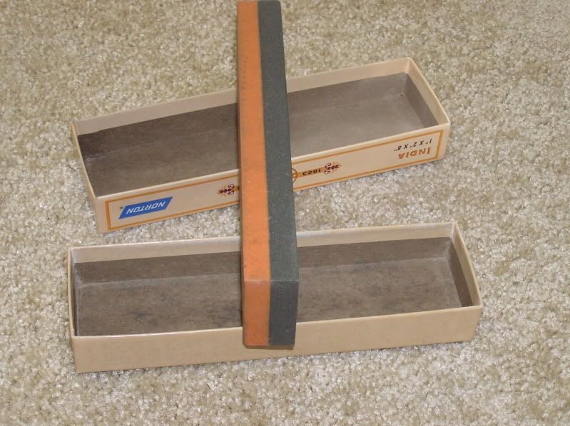

The one I got from HD is brown and grey, but my India is brown and tan (ish), if I remember right. I'll get it and correct this if I'm wrong. Heck, I'll get them both and post a picture...
I have used Norton stones for the last 20 + years and own over two dozen and know the grey to be SiC and the reddish/orange to be fine India and the brown coarse India .

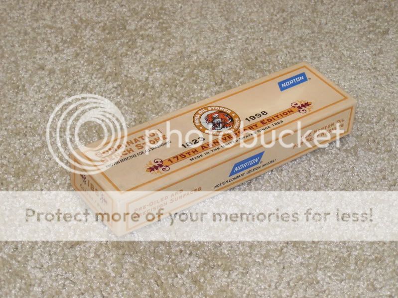

All right, before you go closing this thread, here's a pic of my Norton India coarse/fine. This is not the HD stone, but one that I got years ago on the internet. It looks like grey and red/orangeish/brownish.. It's 1 inch thick, 2 x 8 inches width/length.
