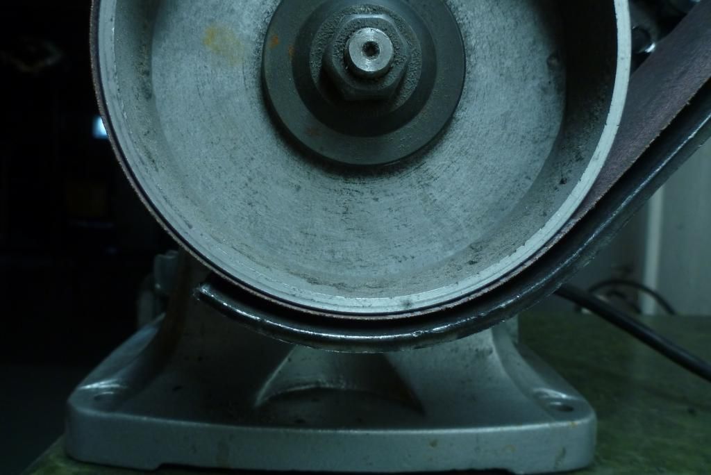

OK back from the VA but still cant figure out why the belt is rubbing in the grinder..
SO i made this video, can any of you with experience tell me if this is a defect, something i need to adjust, or what?? Thanks for any help.

I thought the same thing.. Tried running it, but it bogged down and wouldnt spin. It runs fine without the belt on though LOL
Now i could very well just bend the casing a little.... And i think that would fix the issue... Im just not sure if that would be a bad move or not.

Looks like several other folks have run into that problem with some thicker belts and they just cut off the bottom part of the guard. Sent you a pm.

Got your PM DunkEm, tried replying and it i got the website can not be displayed page... But yea i have seen the same thing. I googled it as well a bit earlier. I just dont have an angle grinder, i guess i could take a hack saw to it, but first ill let James or Todd chime in.
I was able to pry the thing back enough to get it to go through. but.....

So should i take it to sears for a refund and order a new one? Or make this one work?? It seems issues are not all that uncommon for this 2x42, and for the price i cant really complain. I just want it to work like it should, at least work the way it works for others.
WW, that is definitely not right. Mine has all kinds of clearance.
I didn't see any way to adjust that either. Cutting it off won't hurt a thing, neither would bending it. I'm going to cut mine off when I get around to it.

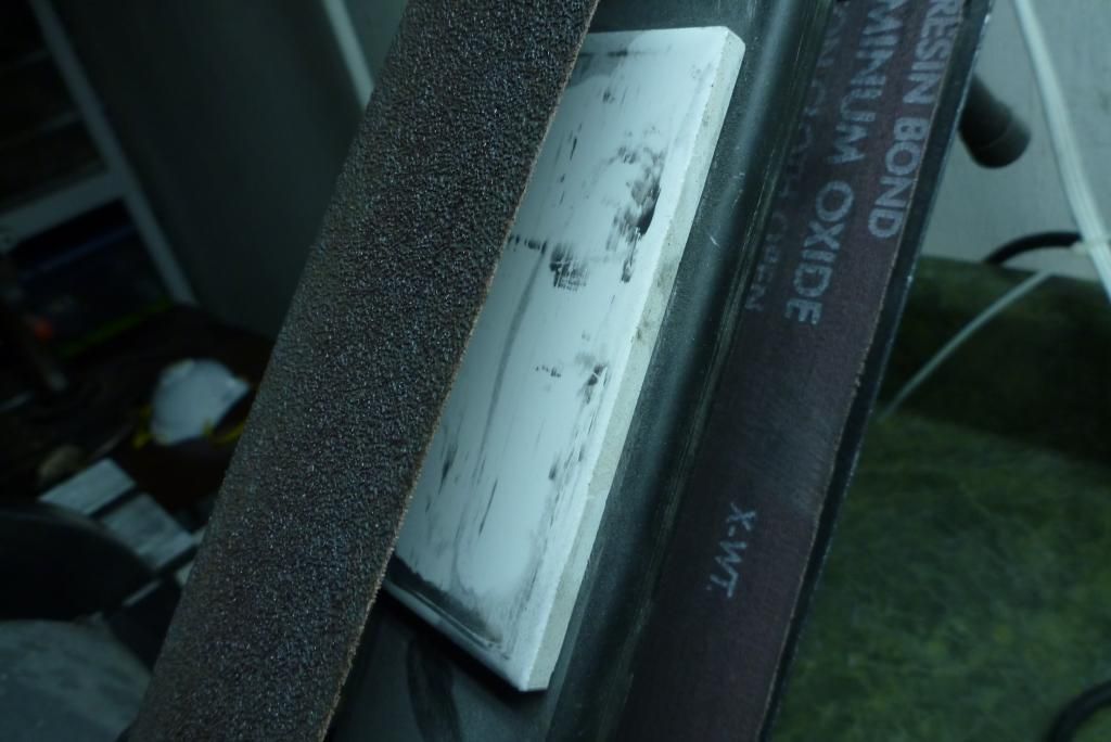

Here are a couple of things that will improve the performance that will cost you a couple of bucks.
JB Weld a 2x4 piece of cerramic tile (a buck at HD) for a ceramic platen. Smooths it out and cuts down on the friction.

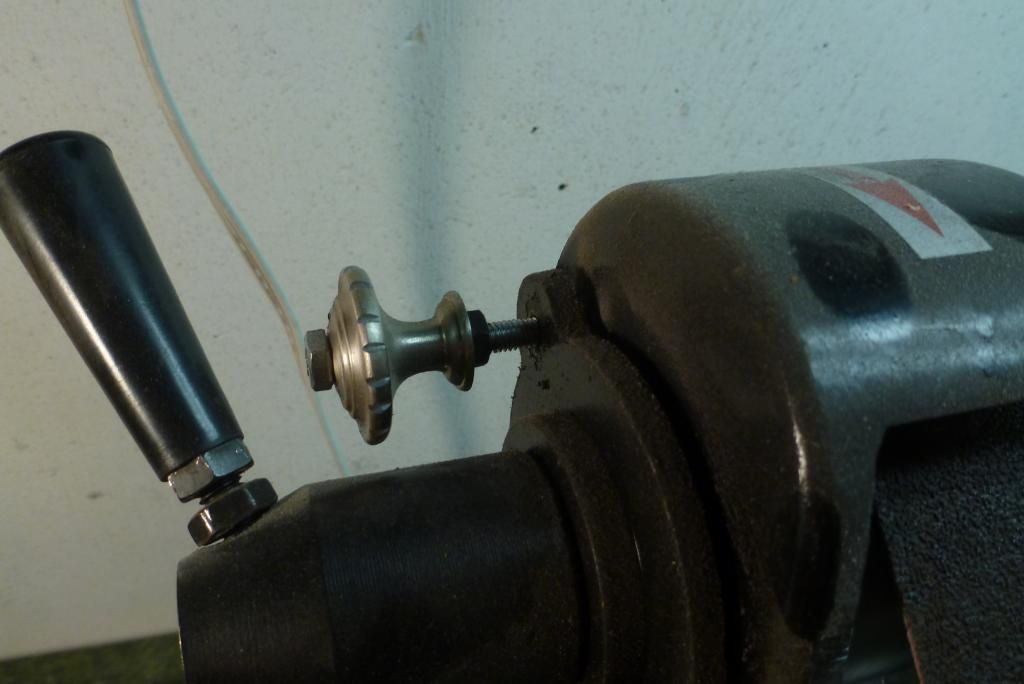

Replace the set screw tracking adjustment with a bolt and knob arrangement.

WW The one I bought had the same failure, and I returned it. Its not normal. It sounded like a jet taking off when it ran and had that craptastic tracking problem also.
I really like that knob to adjust the tracking!! And i will for sure add a ceramic platen soon!
Does your belt bounce around like in the 2nd video?
I have no problems making this one work if its acting normal. Im just not sure what normal is LMAO
I just watched your second video Woody. I'd take that one back.
Well that settles it.
Ill be wiping this one down and boxing it up. Sucks they dont have them in stock for more than 50 miles but i dont want to be stuck with a dud.
