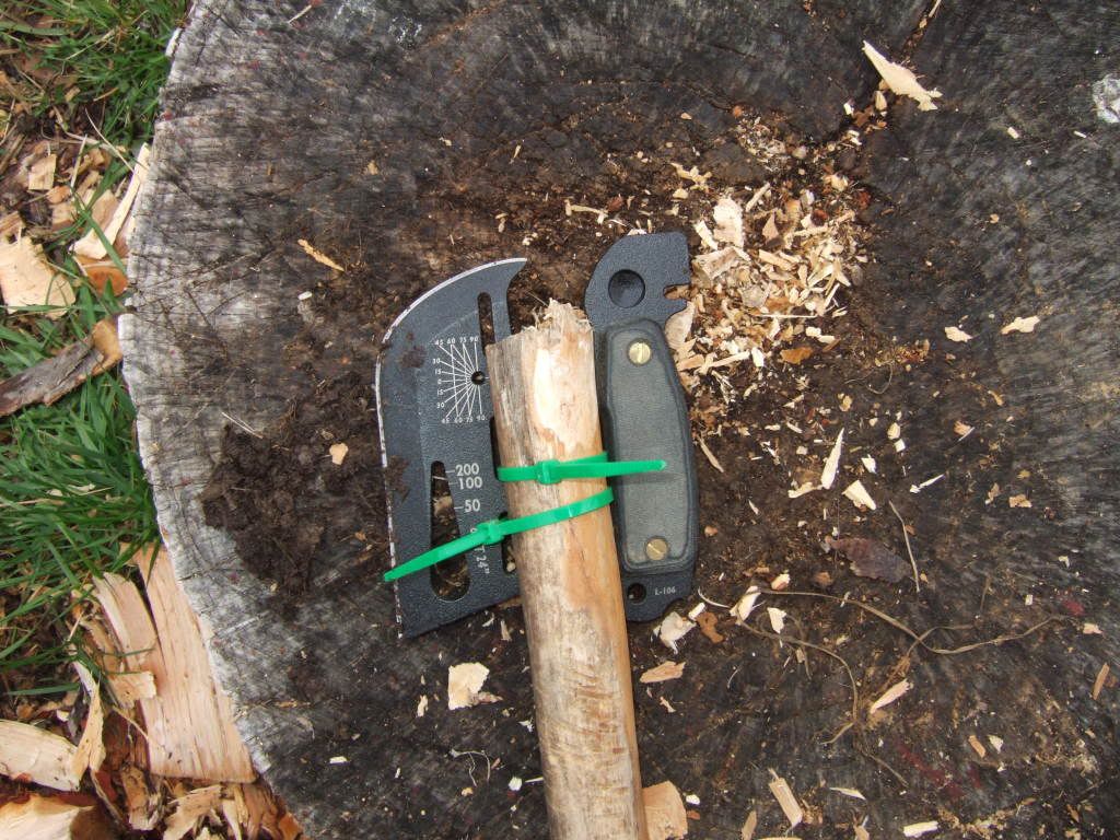

I think you're right.. It might be easiest to go with a attachment approach more like the ATAX (I'll try to post some pics later) instead of the threads. The other thing that I would like to see is more of a hand grip, one of the real strengths of the Skakchet design is the hand axe/scraper/ulu feel... Just my .02
Makes sense, perhaps just narrow, flatten, and/or lengthen the middle. Also, need to throw in a divot for bow drill socket.

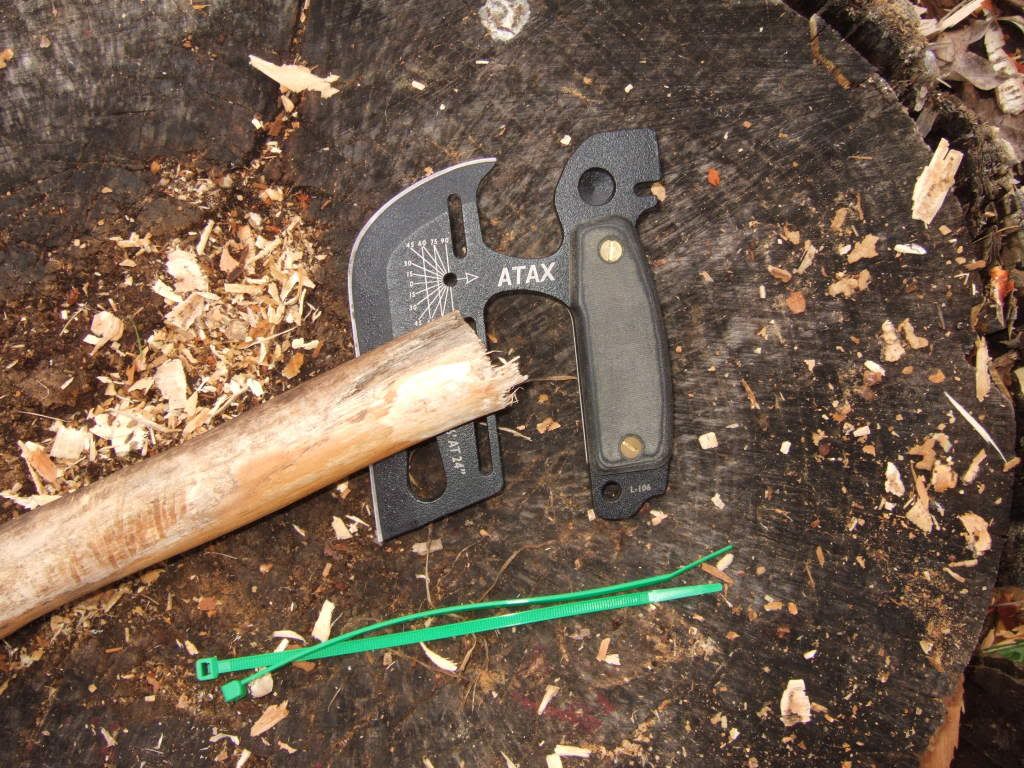

Ditto. I wear the ATAX on my belt above my wallet pocket with a SAK in my front pocket. I use the the ATAX as a hand tool all the time, I consider its ability to be attached to a handle as a bonus.....
In hand:
You split the end of piece of wood (this is a piece of firewood..)
Than you bind with shoelaces, paracord, ties etc.. - very fast to put together..

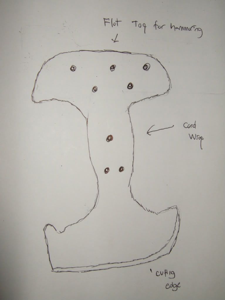

I'm right with you. I like the distance between the attachment and the blade of the Skatchet, the hammer head, and the shape of the edge. The ATAX has more user-friendly steel and a better attachment options. I can't draw for crap but maybe I'll give it a shot.... Anybody else gonna take a stab?
Here's my proposed one.
The blade is a half-moon, like an ulu but sturdy enough to be used as a chopper/ ax head. If another blade design would be more suited to this, say so.
The long part with the holes in it is the tang/ handle. When the blade was being used as a hand tool, wood or some other material handles could be attached using long screws and rivets. The handles would have to be fairly thick to work for the other purpose. The flared trapezoid at the end would be a hammerhead, and obviously would flare in four direction, giving more surface area. The way the blade when being used as an ulu would be gripped would be with the tang/ handle and hammerhead under the knuckles and hitting the palm for straight-up knife use and with the hammerhead over the knuckles when it was used as a hand-ax or scraper.
As I said, the long crossbar is both the handle and the tang. It is the tang in this sense: when you need a larger ax, you could use this tool as a hand-ax and cut a notch in the end of a suitable stick. You could then wedge the handle/tang into the notch and fasten as you saw fit. However, the holes are there for a reason and could be used as loops to pass cord through. Also, if you made the handle panels thick enough, their easy-to-unscrew screws could be used both as fasteners and augers for the ax-head when used as such.
I have no knife-making capability of mine own, nor much woods-bumming or knife design experience. Feedback would be much appreciated.

I had issues with the mass of the original skatchet and have been pondering....
I'll get some design photos up. I hate design sketches. I don't DO design sketches. I never draw! So - I have a couple drawings.....

first, the big one:
and "wrapped"
This ain't small- OAL is about 7.5 inches, with an edge length of 5 measured vertically, 7 measuring the edge around. In this case, you are definitely doing a split haft attachment system. And your 'hammer' end is going to be your stock thickness.
I could handle 1095, but I think this is a design that's going to shine best in 3/16 or 1/4 5160 with an edge quench. And a convex grind, of course. Betcha I could still get a nice shaving edge on that. (Actually wouldn't be that far off from a bushbeater or boar knife)
The choppy line on the thumb ram is actually a one sided jimping. so you still have one sharp cornered flush side for rounded scraping.
For a designated flat pack type thing, I'd do this one in 3/16 5160- it fits into a 3x6 inch rectangle:
cutting edge is still a good 4.25 inches, and in both cases the handle is based on the trail knife handle I do.
Both designs have a flat rear to the blade that can 'rest' on your haft.
Now- forge welding would be a nice answer. You take your basic blade whape out of two chunks of 1/8 1060, put a nice 1/4 inch piece of 1060 in the rear, and put a cutting bit of 1/8 inch 1095 in the middle fo the blade section. weld it all up, then use a drift to round and spread that center hollow section into a goo 5/8 or 3/4 x 2 inch oval. not much more you can ask in that- light weight, handle will be hand filling, and you have a centered val haft fitting.
