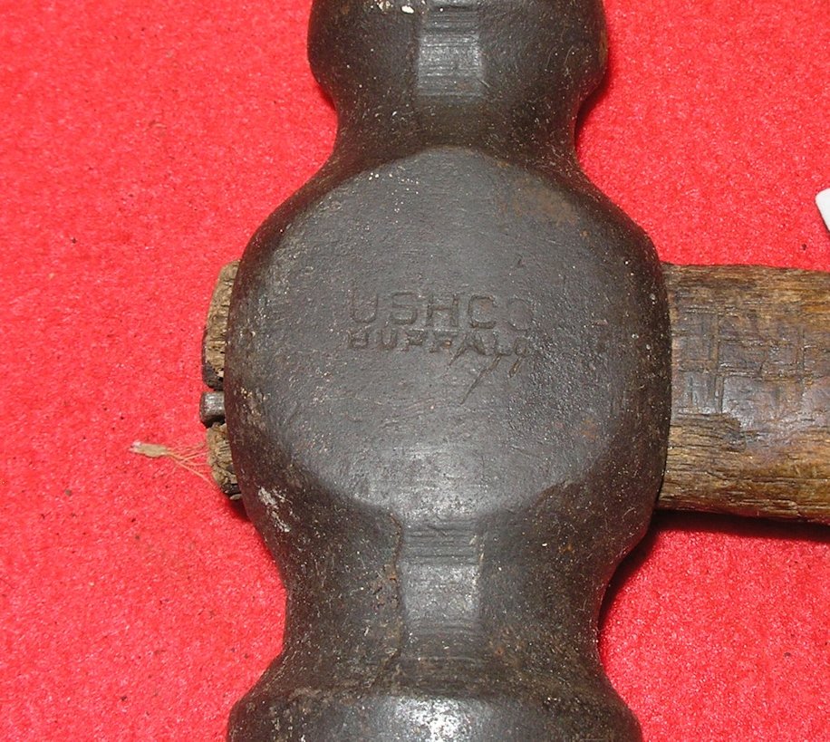

Anyone familiar with u s h marking? 4lb sledge head
Sent from my HTC6535LVW using Tapatalk
