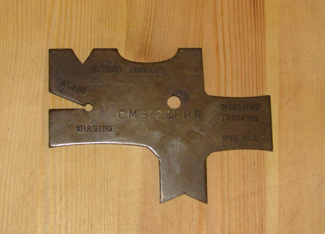

More of a "process" shot. Any tips on prepping the face and bevels on a hammer that was heavily pitted?

Crown the face.
Yes!
A big side grinder does a nice job flattening the face and setting the bevels. As Ernest already noted you'll need to crown the face. A flap disc on an angle grinder can do this well. The railroad sharpening gauge I posted a couple years back will show you the radius of the crown. 42Blades made a nice printable replication of that tool.
Either the spike maul gauge or the track & bolt chisel head gauge should do you just fine.
https://www.bladeforums.com/threads/adze-sledge-gauge.1410074/#post-16256324
For scale the tool is 5" wide.

I appreciate the reminder. The little 2+lb hammer will be crowned.
