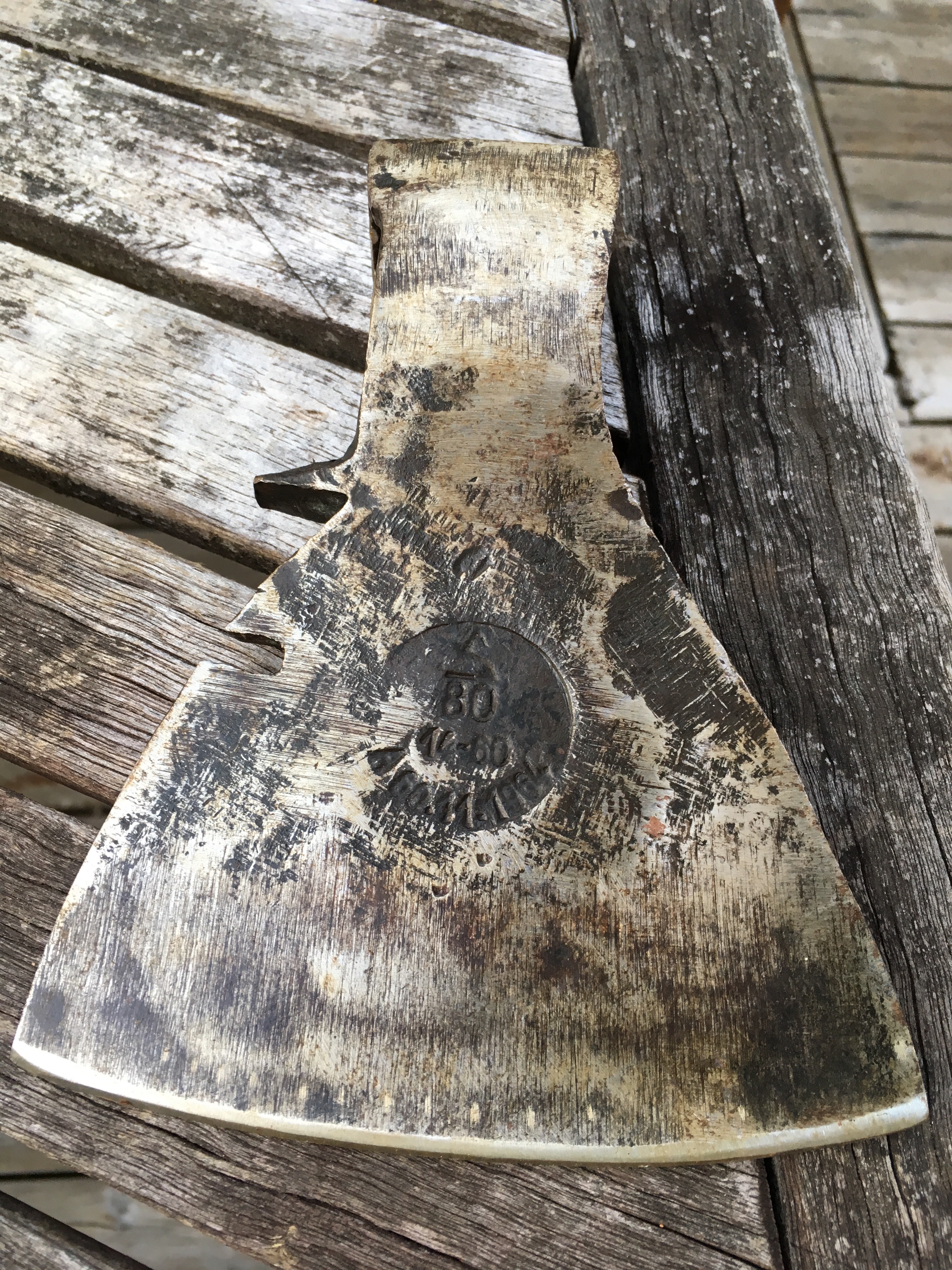

I already show you that this is quality russian carpenter axe.
As I can see it is made 1964.
80 is type of steel- russians call it "инструментальная сталь У8"
The other number is number of the standart according to which it was made.
It is an exellent axe.

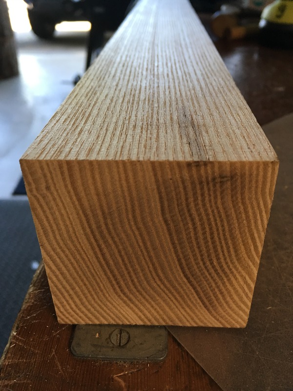

I drove into town this morning to look at the Ash turning blocks that were advertised. There was one to “choose” from and it was on sale – 18.xx – I’d have to find the receipt.

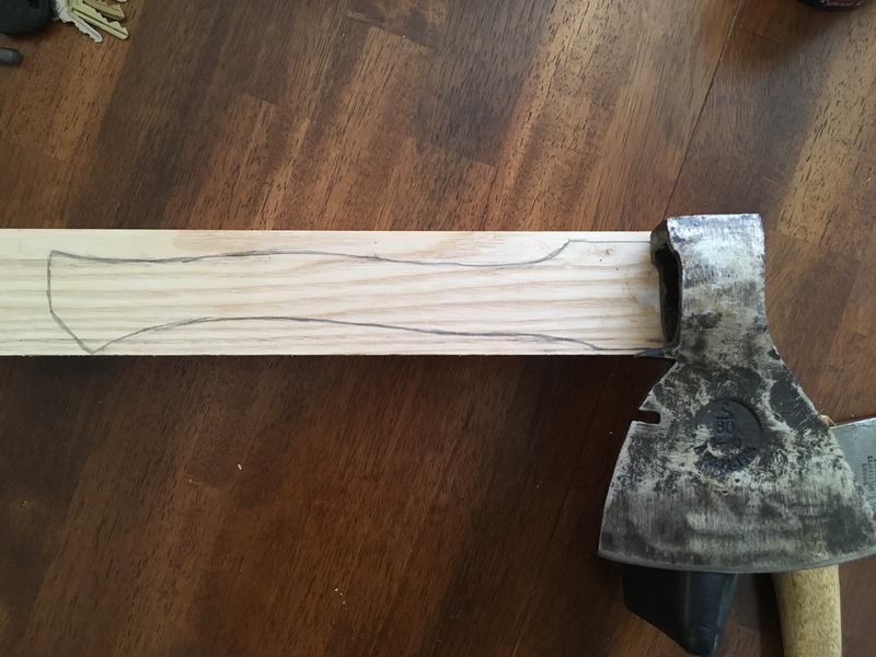

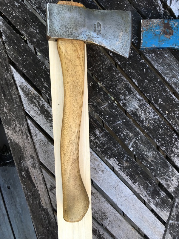

Now, I’m thinking waste not want not with the block. I think I can designate one end to the Russian axe with necessary excess for an extended neck and the other end to a Euro sized eye for a Made in West Germany head. Might even be a 4lb. sledge hammer on the other side.
The head weighs 1lb 11oz. I am used to American handles. Longer eye with some curve behind it or straighter?
Guess I need examples of effective handle shapes for hanging this one.
*Realized I rotated the block out of grain alignment for that last picture.
18" - 46cm sound right?
Agent H,hi.I can't follow the links you've provided(my internet speed+the funk factor often inseparable from russian-related sources).
If you're wondering about this specific alloy,У7(as well as У8,У10,У10А,У12,and on and on),then it's just a "simple" Carbon steel,with 70+%C,analogous to AISI 1070,1075,1084,et c.
The russian code У stands for Углерод,which is Carbon;if other alloying elements were present they'd also be indicated by their letters;so,U7= AISI 10xx series alloys.
The handle on these axes was most commonly birch(thus the volume inside the eye,it developed like that initially because there's not too much BUT birch available,in the more northern,i.e. forested,regions).
The haft was often made out of the jug-butt part,using the beginning of the root flare...(meself,i'm fairly cynical of the practicality of this,as i find the grain in the root be coarser,and the wood on the softer side,but arguing with "traditionalists" simply ain't worth it....).
Because these people had access to not much of anything but birch,they developed this loyalty to it,and began justifying it by saying it's the Only Way(of course).And the softness of birch,it's low density,began to be worshipped culturally(i'm speaking Very generally here)as an ultimate handling wood for it's shock-absorbtion(true to an extent,stands to reason...).
The shape of the "traditional" haft always held little aesthetic appeal to me personally,but here's a resource where you can see many examples of such,
Here's (a rare)one that is more or less appealing:http://rusknife.com/topic/13397-есть-железо-нет-дерева/page-12#entry629753, the post # 332
And here is a long thread on this type made by the Zlatoust factory,one of the oldest,most well-known makers:http://rusknife.com/topic/12708-топоры-зик-он-же-згз-советского-периода/page-19#entry630230
Again,i'm not a great fan of these axes,and lack the insight(tried and failed to id your specific stamp,it could be Zlatoust,not sure...ЗиК stands for the abbreviation of Zlatoust instruments Factory).
But hope all that helps in your search....
Some more information can be found by searching for "U8 steel", such as the closest equivalent in the USA is W1 steel.
That's correct,Steve,thanks.Yep,simple eutectoid steel,anything with 7+% C and not much else.More rarely,these axes were forged out of the equivalent of AISI 5160,(Chrome-based "spring"-steel,commonly used in leaf-springs in vehicles,in Russia 65Г.
In the days of USSR all(and i mean ALL)objects manufactured,their processes,et c.,were strictly dictated by a set of government-developed and enforced specs,similar to the "mil-spec" concept.They were called ГОСТ standards.Let me see if i can find it for these alloys,it should be fairly easy...

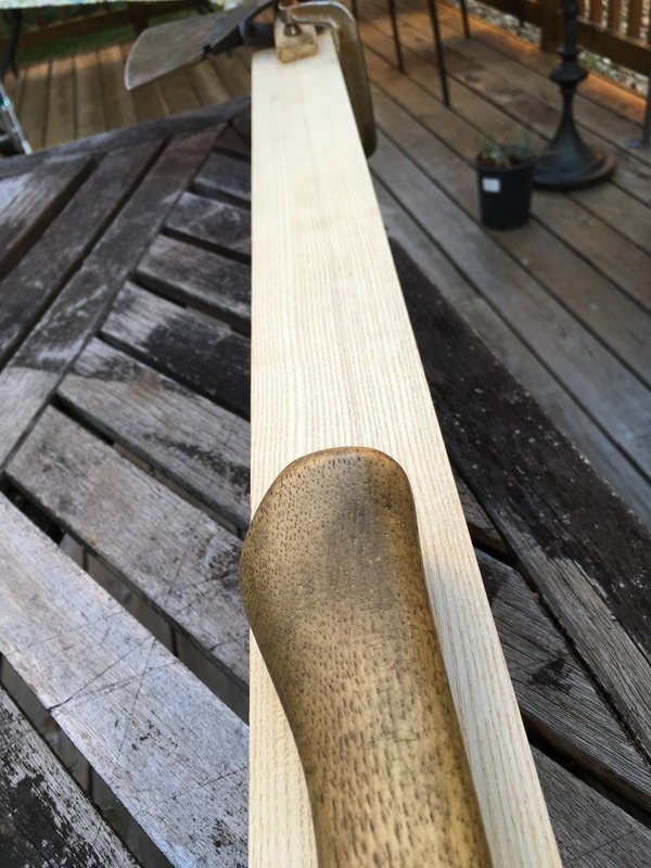

They may not be thick enough for some applications, but take a look at ash wheelbarrow replacement handles. I'd guess they are 1.75" thick by 60" long and are typically very straight grained. No good for curved axes, but maybe great for hatchets. I have used similar shovel handles to get a few hammer handles out of. Great wood, easy to choose the length section that you want, and always perfect grain orientation.
As a matter of fact, I have one piece left, I will try to use it for my next larger hammer.
Jake, thank you for all of that information and your time as well. History, use, composition, resources - all of this is great!
I probably don't need another handled axe for anything but the novelty (to me at least) and the learning process is what I'm finding rewarding. For example, I have not made a finished axe handle from raw wood or in this case a nice blank that is already cut and dried for me. I'm also getting a kick out of the Russian forums - some of the banter there sure seems like what goes on here in this forum.
Even with Chrome's rough translation I see that the "shelf" on the handle behind the eye is considered traditional. Given that they were using birch and I got hold of something harder it probably isn't necessary. I like the basic shape of the one from the forum page you linked here for us.
Some of this is very much "Old Hat" for some (such as our European members) but your guys' input is very much helping. Appreciate it!
JB - you don't have a sickle to go with that hammer, do you?
*Realized I rotated the block out of grain alignment for that last picture. . .
Not sure what is meant by the grain alignment in the block. With that block it seems to me that the grain alignment (if you are concerned about it in relation to the head) isn't particularly important until you lay out the handle blank.
Anyway, I don't see why that block will not make an excellent handle. Looking forward to seeing the finished product. :thumbup:

Me too Bob. I haven’t done it before. Here is what I am thinking. It seems like many of the handles are more square coming out then have some have curves, some really subtle, and some really none at all.
This is what I sketched out using one of my favorite handles as a template then modifying the tongue and grip angle to keep my hand in line with the head.
Too much? The head is propped up on my wallet so it will get on there straight eventually.
