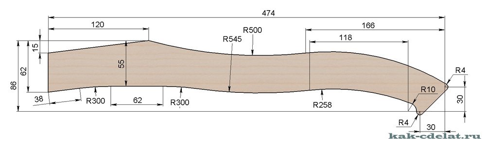

They call it "топорище". Search for images... and you'll get drawings...
Not sure I can get the handle drop out of my wood for that last one there.
Did I mention I appreciate the feedback? :thumbup:
Search for drawings by ГОСТ.
This is a Russian standart...

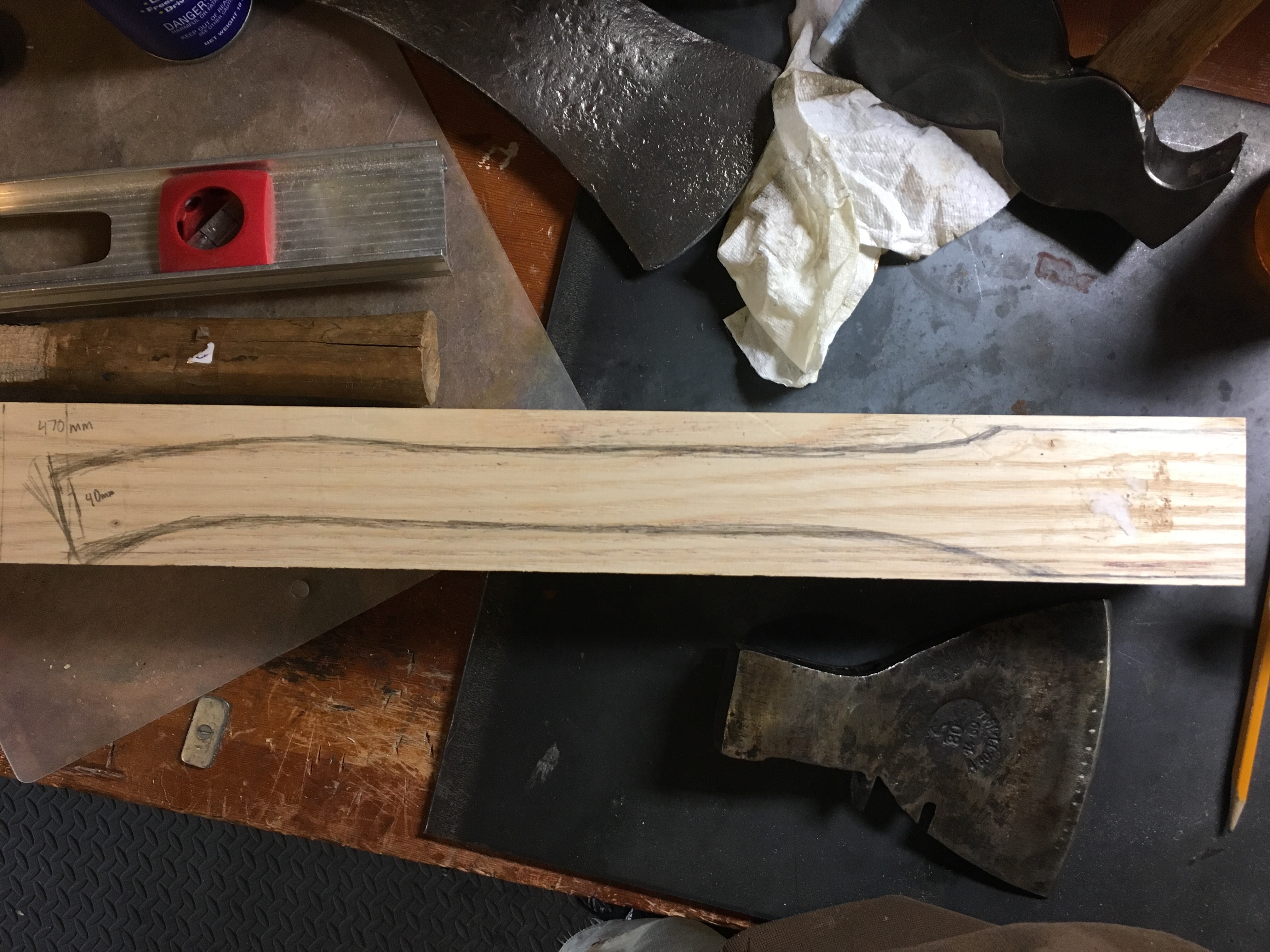

I think I might have to compromise, being somewhere between the two. Most of the measurements that I have drawn here meet the specs for the last one down in that set of three schematics.
My hand eye is decent but in order to do the Russian ГОСТ number by number I run out of wood on the handle drop.
Closer?

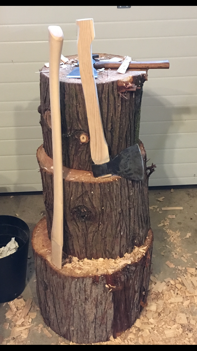

I hacked out the rough shape last night and pretty much have a good hang. That template was traced on the wood’s thicker side. After I roughed it close to the blue scribe, I stood it in my vise and cut it off flat – it’s still thick on that side. While not the best template, it gives me a start in case I have to make a similar handle…
So, I'm goofing around with this Russian hatchet/axe and I think IPT is right about it needing a "Russian" hang. That is something that I haven’t done before and it is different from what I am used to. Trying to reproduce it from some of the diagrams I found left me stumped as how to have the handle drop from the head to the swell. Ours here go on straight in but ours don’t have elongated toes like these. I see why they need the drop. They look a little closed when you hold them up but when you use it, the center of the blade makes contact first. I’m used to hanging an axe that I can sit bit down on a counter and the swell touches with the bit contact pretty much centered.
The Euro handles I see for sale on the auction site we all know have this funny taper cut to them. I am beginning to understand why.
Not having enough wood vertically leaves me without much of the natural drop I’d like. So what I am ending up with is something that strikes in the center of the bit:
Sitting with its swell on a level surface with the bit it looks open but if you lift it up to where the diagrams show – It is dead center. I guess I am going to end up with one that looks like the 3rd one here:
With a hang to make it more like:

I haven’t really had much experience hatchet carving but this is the chopping block. 41” high made from three successively smaller rounds. 15”, 14, and 12” set on each other. Each round makes a step or rest for what I’m working – long to short. I just put the 36inch handle on there for example.
