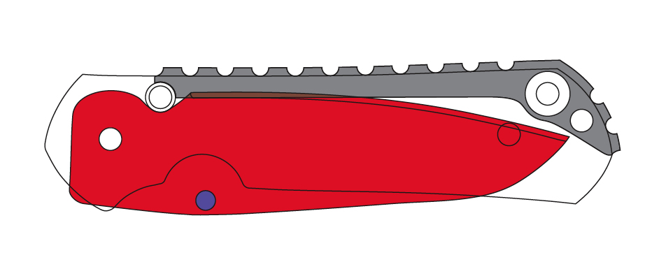

Hmmm... I don't know the answer to that question. The original run of back spacers were designed off of Forum member TTTis's hand made back spacer and his specs. I'm also not at all familiar with CRK knives... but if another Forum member can't chime in with an answer... I think I might be able to snag a straight on side photo of an Insingo blade off the web and trace it in CAD. I can then overlay that tracing atop my existing Sebenza CAD vectors and see if there are any warts.

would it work with an insingo blade?
Yep, made sure it worked with both blades. It was designed off the drop point, but the drop point edge goes much further forward in the handle. So if the slot accommodated the drop point, the insingo is no issue. I currently have two of the originals on my two insingos.

It would be ideal though if he received a drop point for the model. The edge on the drop point goes further along the spine into the backspacer if that makes sense. So the milled slot for the blade to fall has to be longer on the drop than insingo. If the spacer works for the drop, then it automatically works for the insingo.
I really didn't even think about the tanto blade, but I imagine that has the longest edge against the spine of all the shapes. Of course when I had the originals in mind, I was just thinking about the insingo/drop. Just something to think about!

OK... Forum member TTTis answered the question with regards to the back spacers fitting an Insingo. YES they do. He's the authority on this... BUT I went ahead and did the PHOTOSHOP/CAD thing and this is how that looks.
Now here's the caveat... I grabbed the best Insingo full side shot that I could find to do the blade tracing... but with ANY photography there is a degree of parallax error introduced. The closer you are to the subject when taking a photo... the greater the parallax error. The further away from the camera... the the smaller the error.
As TTTis explained... his drop point Sebenza back spacer that I designed has a longer closed blade clearance linear slot in the underside of the spacer spine where the Insingo blade style requires less... so... THEY WILL FIT the Insingo.
Steve

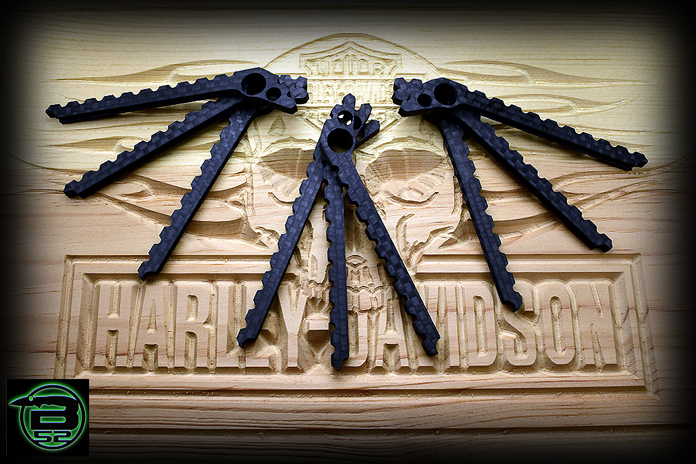

I managed to sneak in some machine time this morning to mill the blade clearance slot in the underside of the back spacer spine. So this batch of carbon fiber back spacers are finished!
Three out of the twelve are already spoken for... so the remaining back spacers will get posted up in the EXCHANGE as soon as they get the Forum bugs worked out and open it up.
I'll also be contacting the individuals that submitted requests via PM... so not entirely sure what the number of back spacers will be once I manage to get them in the EXCHANGE...
