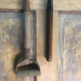

Here is my little project of the day... No before pic so I took a pic of the other. Mr. Wilcox was a WW2 vet a Naval Corpsman who served in the pacific theater. When I was a kid I used to go see him almost every night. He told me stories that a 13-15yo probably shouldn't hear. He also told he about fishing and trapping because that's all he did after WW2.
Anyways Dad bought his place when he had to leave and now I have a place very close on the same creek even. Long story short here is Mr. Wilcox trapping shovel and I wish he had taught me how to trap not just fish.
Sandpaper, elbow grease, vinegar bath.
I now have a very serviceable tool
