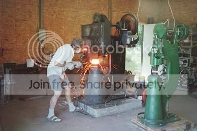

I wonder how much of the extra hitting power that your 100 lb LG has can be directly attributed to the way you had it installed? From what I saw of your shop constructions pics, it has a HUGE amount of concrete under it and it isn't going to move at all no matter what you do to it. From what I have read on here and other places about the Tom Clark hammers, you may get a significant amount of extra hitting power with the 60 kg hammer, more than you would think that you wold get just from 22 pounds of extra ram weight. I'm not sure if that is because of the increased stroke, they heavier anvil/frame or all of the above, but it sure seems like it would be worth the extra $2k if you can fit one in your shop.
Joe, the ones I've talked to who have used the larger Clark hammer have said the advantage is in the longer stroke and didn't seem like the heavier ram was that significant.
The base under mine and having it bolted down (no movement) does give a harder blow and helps move steel faster. When Sid was here, he said he'd never seen a 100 run this good. Knickmeyer and Dippold said the same. 280 blows per minute and doesn't miss a beat. It's a beast! :D
Foundation is everything. When I moved my shop this year, my hammer went from resting on 4 inches of concrete, with three inches of packed gravel, to a floor with 5 inches of vibrated sand and 5 1/2 inches on concrete on top.
The difference in the " stiffness of the hammer blows was very noticeable.

Here is you and the train wreck. lol
Stacy is goin to freak when he sees this old thread on the front page. lol :D
