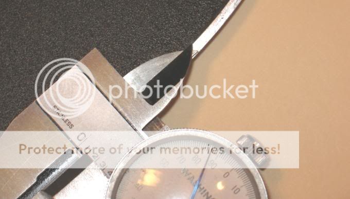

Well i just got my Entrek Merc which comes in 440C stainless and it is the sharpest knife ive ever had it easily blew away my USMC ka-bar which was the knife i measured sharpness against its insane id love to know how what geometry and grit they sharpen it at so i can replicate it with my edgepro (what tool would i use to give me the angle, a mark wont give me a numerical value, im thinking of an actual tool like a protractor, though i doubt that would work).
If you have a good dial or digital caliper, you can calculate the edge angle pretty closely by measuring the width of the edge bevel:
and then measuring the thickness of the bevel right at the shoulder, i.e. at the very back of the bevel, where it meets the rest of the blade (sorry, no pic.)
Let's say the edge bevel measures .040" wide, and the thickness of the shoulder is .020". The math you need to do is first divide the shoulder thickness by 2, giving you .010, then divide that by the bevel width --
(.020/2)/.040 = 0.25
Then using a calculator (or spreadsheet even) find the inverse sin of 0.25, which is about 14.48; this is the angle of the edge bevel on that side.
Note that many times the bevel angle will vary from side-to-side, and/or along the length of the edge, so it's a good idea to measure at a couple different points, and measure the bevel on each side. Personally I'd then set the EdgePro to sharpen at the lowest measured angle, or a little less. Based on quality 440C blades I've had -- and it really can take a nice edge when the heat treat is good -- there's no need to run the edge at greater than 15 degrees/side, and 12 degrees/side (my favorite all-'round sharpening angle) should work just fine and likely noticeably improve cutting ability compared to most factory edges.
Hope that helps ... and if you don't have a calculator, just post your measurements and I or someone else here will punch in the numbers for you.
