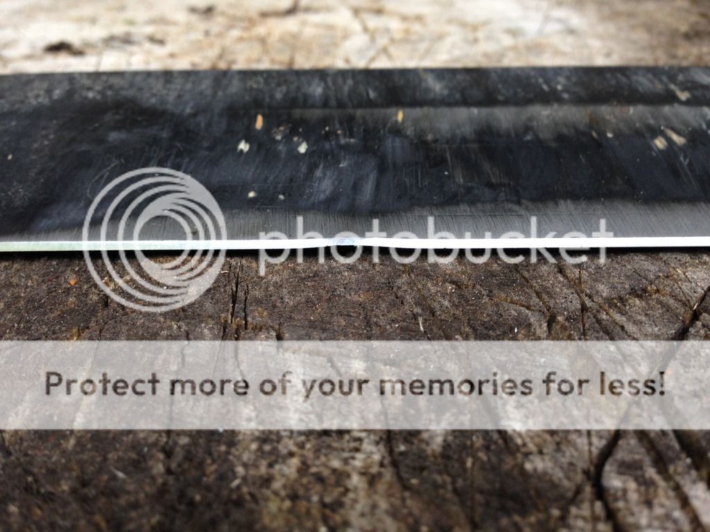

FWIW, I incurred some damage to my 1311 this past summer that appears to be about the same size as the chipped-out part of your blade. :eek: The difference is that the 1311 didn't break, but instead a semi-circular area of the edge took a permanent set. :( This happened while batoning through some pine, and I didn't immediately notice it and continued using the knife. The craziest part is that a week earlier I had chopped up some seasoned mesquite without issue.
A section of the edge about 1" long by about 1/2" high bent to one side, by as much as about 1/8" in the middle of the bend. The edge itself is still perfectly sharp and undamaged (no chips or rolls), and the knife still does its job just fine. For that reason, I have not tried to repair it yet, and I'm not sure if I will because I'm worried that it might chip out like yours did when I try to bend it back the other way. I haven't contacted the shop either, as I don't know if I want to send it in for fear that they'll tell me that it's ruined. :o If it does finally break, maybe I will at that point. At least I can still get more use from it for now, and it is entirely possible it will be fine for a long time to come.
I can take pictures of the damaged area if you'd like to see some.
I've done this to a few blades. Sometimes small ones, and some big enough it can be used like a gouge to peel half moon shaped strips of wood. The smaller ones I've left them alone, and not worried about it as it doesn't really hinder chopping, but I did have to have my NMFSH LE replaced under warranty with a new one as it wasn't regrindable.
So, my damage isn't quite as bad as I remember it. Either it was never quite that bad, or maybe it has bent back a bit during use? Who knows. As measured, the damaged area is about 3/4" long by just over 1/4" high up the blade, and deflected about 3/32". I'm not going to worry about it right now, and won't at all unless it gets worse.
Here's the best pic I could get. Not great, but I couldn't get a better view. The damage is centered at 7.5" from the handle, just aft of the 8.5" sweet spot of the blade.
