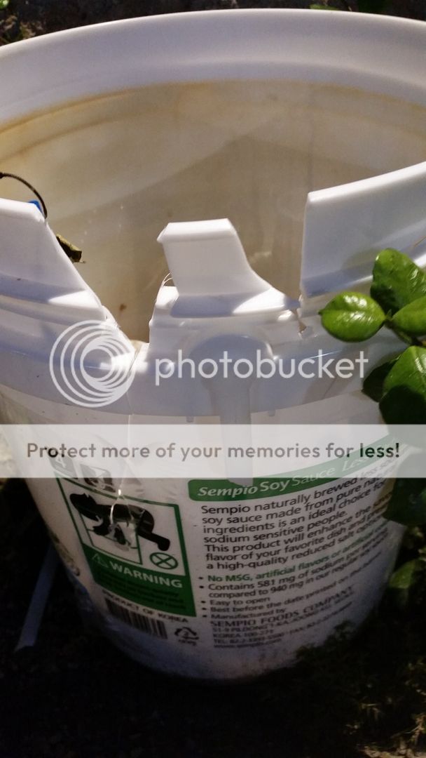

Had a bit to drink at work tonight, took the nmfbm out to destroy stuff.
Took some hacks at a 5 gallon bucket (similar to the home depot buckets).
It ate through the bucket easily, like nothing, but the belly towards the tips, seemed to have chipped. Ugh, gotta bring out the coarse stones...
I'll add pics of the bucket later, can't get pictures of the chipped edge with my phone.

But it is a triangle chip, with rolling on the sides of it. It's very small, but was not expecting it to chip on hard plastic.
I did not hit concrete, it wedged in the bucket.
I'd wager that what damage you are seeing is a result of lateral forces caused by the wedged blade in the bucket, probably had a bit of weakened metal at the edge that needs to get ground away. Sounds like you could resharpen yourself if you'd like, no need to send it in unless you are unable

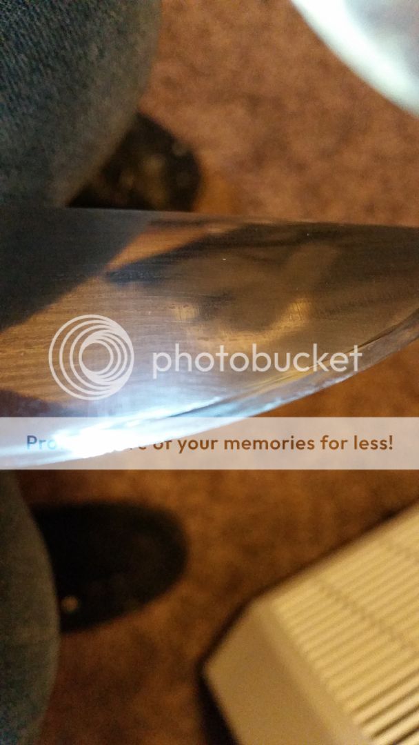

Ok, tried to use a 60x scope but my camera won't focus.
In this picture, the chip occurs where it's brightest on the blade.
You can see the few chips.
Yea --- I would guess Red Angel Dragnet nailed it with the weakened steel --- after sharpening it should be fine. If it continues to chip -- contact Busse right away to see what they say/recommend.
