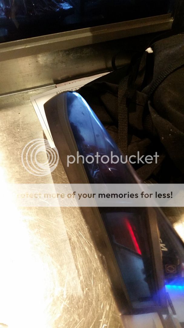

Did some final polishing of the edge, using a chosera 6000.
Also took out most of the chips with a Gesshin 400 and 1000.
Thing is sharp!
I'm sorry, but I cannot make sense out of that pic at all. I'm sure it is just me, but what am I looking at? Can't even recognize the blade shape.
Sorry my photo skills are disgustingly bad haha.
Yeah, edge up and tip away from me. Basically the blue shiny thing is the blade. It's almost mirror polished.
Glad to see it all worked out.
That knife looks beautiful.

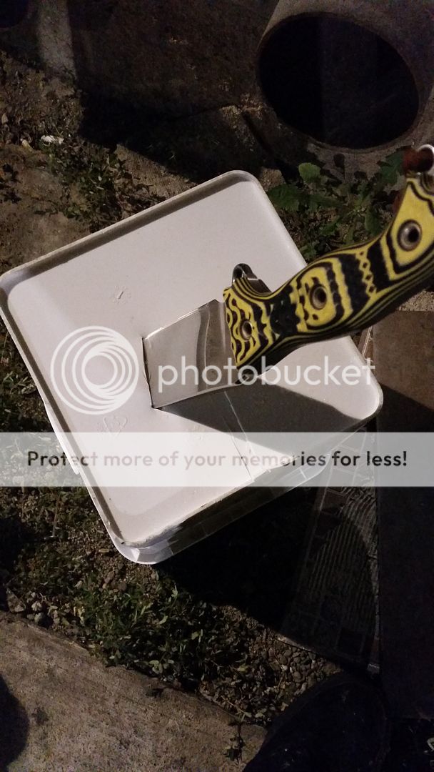

Today I beat on a bucket again, this time the bucket was upside down, figured it offer more resistance.
No chipping this time, at all, took some thinning out. But now it SINKS in.
Someone correct me if I'm wrong, but chopped on this oak branch, about 7 inch. Whoo it's some hard wood!
told ya so! glad you're happy with her now...thinning (a bit) really does make a big difference in "biting" ability :thumbup:
