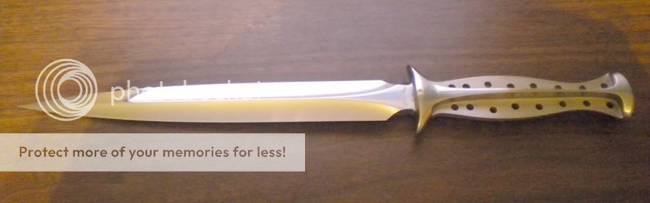

So, I finally got around to polishing this shiv

Or is it a shank? I'm not sure which is correct...
But regardless, it is probably the pokiest thing I've ever attempted. I had Bos do the HT. Not because he is really good at keeping stuff clean and straight and everything, and because everything I touch always gets a kink in it somewhere. No, no. It was because it won't fit in my puny oven. Really.
I think I'll finish the finish in the tumbler with corn cob. That will (I think) give it a nice non directional bright shiny satin finish. It is at 1200 grit right now, but I got some of this 2000 grit "black ice" from Tracy that I think I'll try first. But ultimately I think a non directional finish will be the way to go due to a few strange intersections that currently look a little weird. I can't exactly take it apart to finish individual pieces.

I started the stupid thing about a year ago but got busy doing jobs that pay.
Truth be told, it is probably above my skill level, but so far it is has turned out pretty much flawless. Doing the hand finishing well took a lot of time. I never used my knife grinder at all. I took it from the mill to EDM stones that David helped me out with. It was a interesting process. The next bit is where I attempt to make scales, perhaps from mammoth tooth.

Nathan that's an awesome integral dagger/shiv/shank/toadsticker. Regarding hand finishing, I have the same problem with an integral I'm working on. Every place there's an intersection of planes I can't figure out which way I should be moving the sandpaper. :confused: I like your tumbled finish idea; just make sure that thing doesn't poke through the tumbler! You'll get corncob all over the place. :D

The material is CPM154. And that stuff wears out cutters just as fast as D2. Polishes nice though. Jim, when you take your stab at it, I'd suggest you don't skimp on the cutters or the machining. An hour on the mill is worth probably a day on the bench with those little stones. My fingers cramp just thinking about it.
Jason, you could probably teach me a thing or two about using those stones. I think I took a lot longer than I should have.
