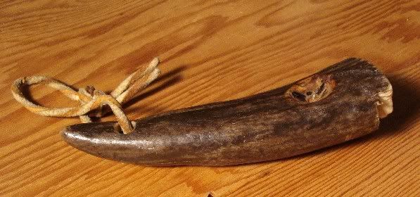

The Headpiece
The headpiece serves a few purposes in the bow drill tool. It protects your hand from the moving, sharp upper end of the drill; it allows you to stabilize the lateral movement at the upper end of the drill (which translates, although to a much lesser degree, wobble at the hearth level), and allows you to apply pressure to the drill, downward into the hearth (this creates the friction).
Headpieces can be made of many different materials - bone, stone, wood, plastic, metal, glass. The qualities you look for in a headpiece are - something that is comfortable to hold, something solid enough to protect your hand and to allow you to apply downward pressure on the drill. You also want material that will create the minimum amount of friction - you want the bulk of the friction at the hearth not the headpiece. I prefer moose antler, others like stone. It probably goes without saying, but there must be a socket or depression in the head piece - in the case of wood, bone, and antler, you can carve it in with a knife, sharp rock, or whatever you have available. In the case of stone, you can either find a stone with a suitable depression (good luck with that!) or create a socket by pecking at a rock with a much harder rock.
For this exercise, if possible, use a shot glass (yes, you'll have to pour your rye and coke by guesstimate for the moment). A shot glass is ideal because most people have one laying around, and the friction in a shot glass is minimal. It is also easy to hold onto.
WARNING - IF YOU USE A SHOT GLASS, HEAVILY TAPE THE OUTSIDE OF THE GLASS WITH DUCT TAPE. THEY HAVE BEEN KNOWN TO BREAK AND YOU DON'T WANT TO DRIVE GLASS INTO YOUR HAND!
If a shot glass is not available, find something else with as little friction as possible and something comfortable to hold and apply pressure with.
The very worst choice is wood, although it will work too. If you have to use wood, use the hardest wood you can find. This will help eliminate friction at the upper end. It also will last a lot longer. You can also lubricate the upper end of the drill to help reduce the friction. In a primitive setting this consists of rubbing the upper end of the drill on the sides of your nose or behind your ears, where natural skin oils occur. The dimensions of the headpiece are not too important, except for the comfort consideration.
Picture of my headpiece (moose antler):

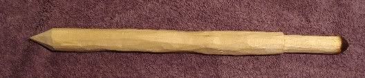

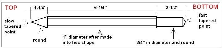

THE DRILL OR SPINDLE - Part 3
The drill is made out of Basswood (Tilia americana). Basswood is a fairly soft, hardwood and it is easy to carve. The wood is grainless or relatively so, and for these reasons, is a favourite wood among wood carvers.
The function of the drill is to oscillate back and forth, creating friction between it and the hearth. As the drill is rotated, and pressure is applied, the wood heats up, small 'grindings' of wood are worn off and collect in the notch in the fire board (more on that later). The more 'drilling' the hotter the 'grindings' become until they get very hot and char (turn black). Once the char is hot enough, and the pile is large enough, a 'coal' will form, a coal, being a small ember that kind of gathers together into a little glowing lump.
So, drill dimensions. Most dimensions for the parts of a bow drill kit are approximate. They are not carved in stone, but for this exercise, let's all make them the same. Length about 10" overall, 12" if you have problems with your back and have difficulties bending over. Now before you say, so and so says they shouldn't be any longer than 6" or whatever, remember:
FIRST AND FOREMOST, THE METHOD THAT YOU ARE GOING TO BE READING AND DOING. IS ONLY ONE WAY TO DO THIS. THERE ARE OTHERS. THIS MAY NOT BE THE BEST WAY, BUT IT DOES WORK!
Just so you understand, one advantage of a longer drill can be that a given amount of lateral movement at the top of the drill, will result in a smaller amount of wobble at the hearth.
As far as diameter, here again we will depart from the norm. This is how I want you to make the drill (and as straight as possible, of course - not straight enough, no fire):
You probably will not always make a drill like this, and it's not necessary, but for this exercise, it is. The purpose of the hexed main shaft is to provide better traction between the drill and the string. The single biggest reason for string breakage is string slippage, so this helps to prevent slippage. That's also why the diameter of the drill, where the string will ride is larger than the bottom end of the drill. The larger the diameter, the better the traction. The smaller bottom end reduces the area over which the friction is applied, making it easier to raise the temperature. Theoretically, by increasing the diameter of the main part of the drill, you will decrease the speed at which the drill oscillates. In actual practice, I find the increased traction between the drill and the string more than compensates for this.
A picture of one of my drills.
Since this is dealing with drills, a note about removing the char. As you can see in the picture above the business end is very black with char. If you were to use the drill like this, you would have problems getting a coal. So, what you do is remove the char. A lot of survival books tell you to take a knife and cut 'facets' at the end, removing the char. I find this to be quite a detriment because, the friction really doesn't start until the drill mates with the hearth, that means before anything productive is going to start, you have to wear off the facets! How's that for counterproductive? What you want to do is get a piece of sandstone, or rough rock, etc. (coarse sandpaper for this experiment) and if your drill is charred, you want to sand off the char and maintain the shape of the end as much as possible but don't get obsessive. This will make it much faster to get back to business.
The top of the drill needs to be slow tapered and very sharp pointed - this reduces the friction at the headpiece. As it wears down in use, you take your knife and reprofile it. Conversely the bottom end needs to have a sharp pointed but rapidly tapering end. (The picture shows a rounded end, but you need to make it sharp. More of this later, when we start putting the pieces together.

4) List the 'Top' and 'bottom' of the spindle in your illustration. It will lessen confusion for beginners.
I will take care of that presently. I added 'TOP' and 'BOTTOM' in Photobucket but it wouldn't change here. I have changed it in my original, though.

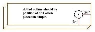

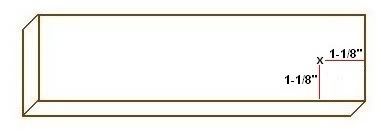

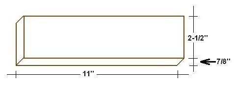

THE HEARTH - Part 4
Part 4 deals with the hearth or fireboard. This is the stationary piece into which the drill is worked to create the friction. The board can be made of many different materials, but for this exercise, we are using American Basswood, the same material as for the drill.
The dimensions for the hearth are not normally too critical, but for the sake of this exercise:
One of the reasons I want you to make the board this size is to provide stability while spinning the drill.
Now use the tip of your custom Charles May knife and make a dimple in the hearth at the 'x'. It doesn't need to be too deep, just needs to provide a place for the quickly-tapered point of the drill to engage the hearth. If it is placed properly and the drill was made to the specs given, the dotted outline in the diagram below should represent the position of the drill, when the tip is inserted in the dimple.
The board is now properly prepared (for the moment).
You don't want the drill to be any closer to the edge than this or it can pop out right when you think you're going to get that coal. If it doesn't line up properly, redo it. Don't try to bluff your way through. That's just counterproductive.

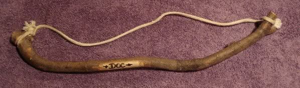

THE BOW - part 5
The bow should be a hard wood so that it can take the stress of a tight cord. Make it about 20" - 24" in length with a bit of a bow shape, but not too much. It must be thick enough so that it can stand the stresses and also not be overly weakened by a slot cut in for the string, at the handle end. A fortuitously placed branch stub would work in lieu of a slot - anything to hold the string.
The more critical part is a fork at the other end of the bow. You want each side of the fork to be a different diameter to allow for greater adjustability of the string tension. This can be accomplished by whittling one fork down with your Busse Battle Mistress.
The end of my bow:
A lot of people tie their strings on the bow, which is fine, but if and when you need to adjust the string for more tightness, you have to untie, and retie, and if it's not right, you have to do it all over again. By using this method, you just change how the cord is wrapped around the forks and/or the throat (C). Also you can carry spare strings, in case of breakage, and since the string at the handle end is also a loop fitted into a slot, you can change the string in a couple of seconds.
Picture of my bow. My bow is quite a bit shorter for my personal requirements. If you can find one this shape, they are excellent. Easy handle-end cord attachment.
