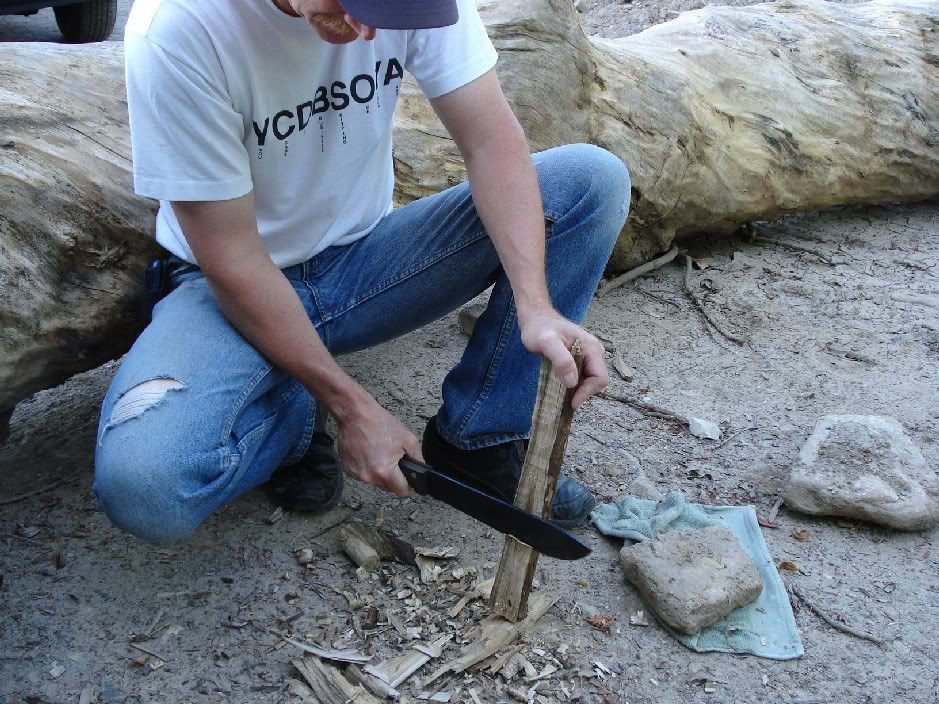

Another wood worth trying would be Butternut (Juglans cinerea) in fact, that may be a project for this weekend.
Well I got out for a hike today with a buddy of mine. My back is still on the mend, so I let him do all the work. Yes, Butternut does work!
Phil preparing the fireboard with the small Linders.

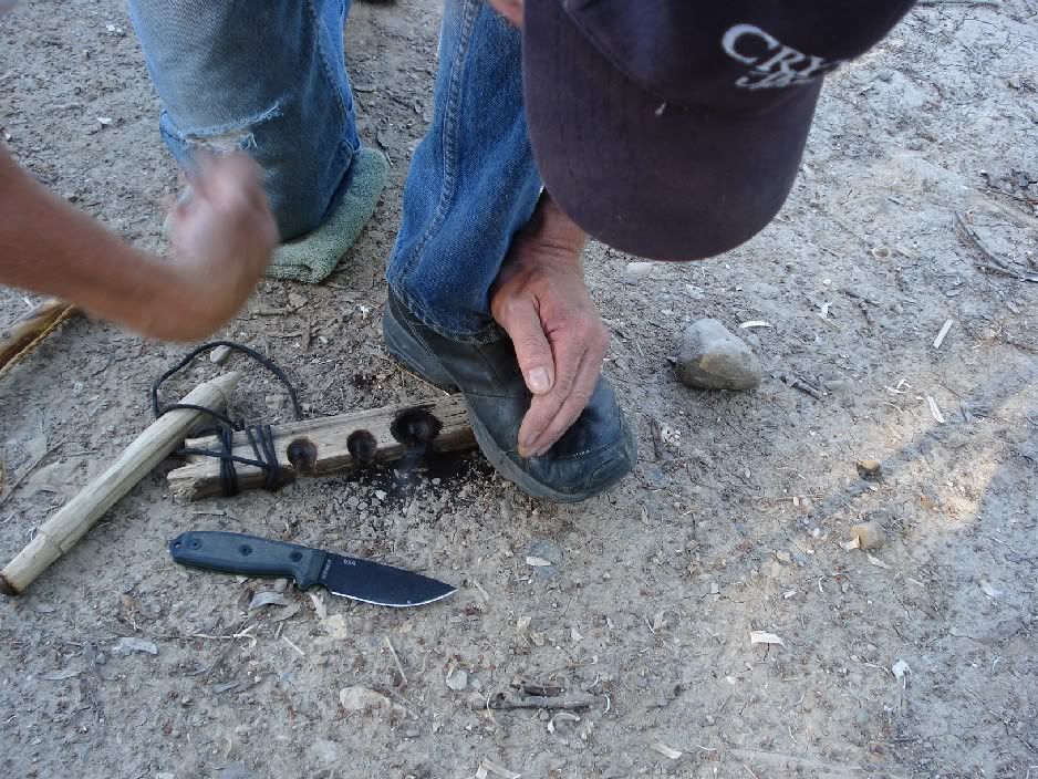

Phil fanning the coal (with my RC-3 in sight, of course :D)

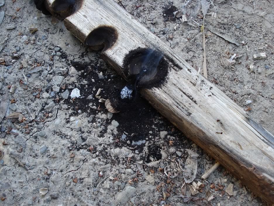

The coal.
