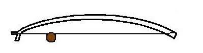

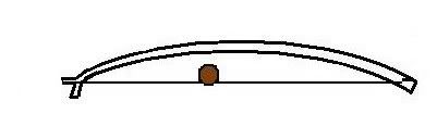

String up the drill. The drill should be difficult to get into position. If it's not, the string is too loose, and you want to adjust it at the forked end. The drill should be on the outside of the string, like this:
Not, like this:

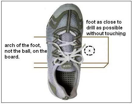

Place the tip of the drill in the dimple, place the arch (not the ball or the heel) of the foot on the board, with the foot as close as possible to the drill without touching. If the drill rubs on the shoe, friction is lost.

Lock the inside of the left wrist against the left shin as solidly as you can. This reduces lateral movement at the top end of the drill. The right knee should be on the ground and back so it's out of the way of the bow hand.
