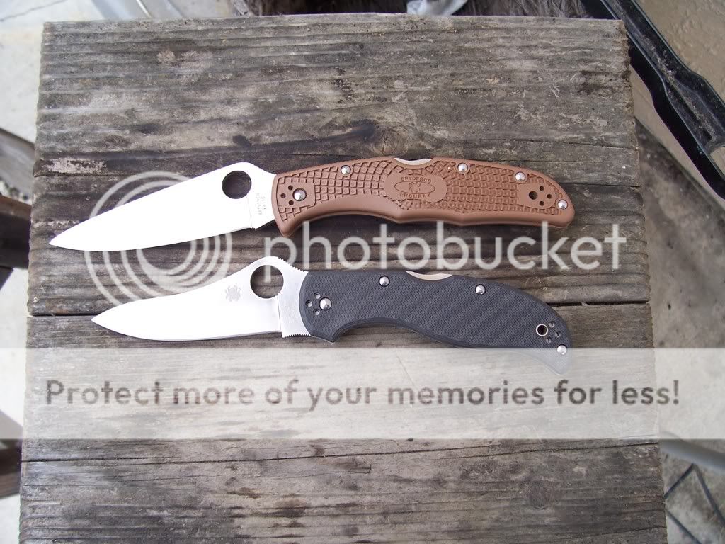

Description of test:
My test is such that the only variables are the alloy, hardness and edge angle. I sharpen the knives to the same edge angle, so that leaves hardness and alloy as the variables to be tested. I make slicing cuts through the manila rope without coming in contact with the supports, then examine the edges for deformations using a 3X hand lens and a high intensity lamp. Phil Wilson has said that cutting manila rope is quite predictive of a blade's performance in real world usage.
http://www.bladeforums.com/forums/showthread.php?t=421773
Blade information:
I started by measuring the Rockwell hardness of each blade. So we end up with this information about the knives.
Spyderco Stretch II: Full Flat Grind ZDP-189__62HRC
Spyderco Endura : __Full Flat Grind VG10- ___59HRC
I measured the blade thickness just above the bevel of each blade. Both were in the range of 0.027” – 0.031” depending on where I measured. (The thickness has no impact on my test results, but it can if you cut cardboard. I include the information for completeness.)
For this test, I rebevelled the edges to a uniform 15° per side and sharpened them using DMT diamond stones (extra-coarse for the angle change, then Coarse, Fine, and Extra fine.) I checked each blade with the lens to ensure that I could not see the edge.
Test results:
I made two complete runs, the results were the same with each, I will summarize below:
I made 20 slicing cuts with each blade through 3/8" manila rope and examined the edge.
For the ZDP-189 I could see nothing.
For the VG10 I could see a few glints.
At 40 cuts I stopped and examined the edges again.
For the ZDP-189 I could see a few glints.
For the VG10 I saw an increased number of glints, and there were sections where I could see a length of edge. I could not tell any difference between the two regarding the force required to make a cut.
After 60 cuts
A very faint line was visible along the ZDP-189.
A shiny line was definitely visible on the VG10. I could not tell any difference between the two regarding the force required to make a cut.
After 80 cuts
The faint line on the edge of the ZDP-189 was more visible, but not shiny.
The line on the VG10 was shinier than it had been at 60. I could not tell any difference between the two regarding the force required to make a cut.
After 100 cuts. Same as at 80
After 120 cuts. Same as at 100
After 150 cuts. VG10 still showed more shine.
At the end of 150 cuts I alternated between the two, making a cut first with one knife, then with the other. While the VG10 still cut the rope easily, I could feel a slight difference between the effort needed to cut with the two knives.
Conclusion:
So ZDP-189 actually does hold an edge better than VG10, but you have to do A LOT of cutting before the difference becomes noticeable in this type of cutting. If you needed to retain an absolute scalpel edge as long as possible, the difference would appear sooner. I'm not sure that I know what type of cutting that would be, but I'm sure somebody somewhere has such a need.

Great review, Frank! Thanks for sharing your investigation with us. And thanks, Dennis, for loaning out the knives.
Love the picture at the end, too - both knives are classy in their own ways.
