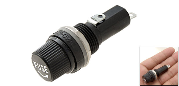

Jared, how did you resolve the input power line fuse?
I used one of these for a 110v input, 220v you would want two - one for each hot line in.
I notice that nobody seems to mention adding a fuse, but it seems worthwhile to me.
I used all my predrilled holes for switches, but It's pretty easy to drill holes in the case to add that fuse.
There is lots of room inside the case to add it to the front half.
The front cover lifts off the hinges and the wires are all on quick disconnect spades; so there is no need to get the chips in the electronic guts.
Phil, I went with Travis' suggestion and headed to the local auto parts store, which in my case was an O'reily's. I bought an in line fuse holder rated for up to 30 amps and then bought a pack of 25 amp fuses. Total cost was something like $4. Easy to install and works like a charm.
