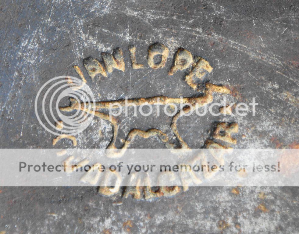

I think your "J" and "Z" are there - as part of the stylized ends of the anvil in the logo. :D
Yeah, the majority of the J is missing, the lower part can be seen touching the anvil, the top of the Z is missing.

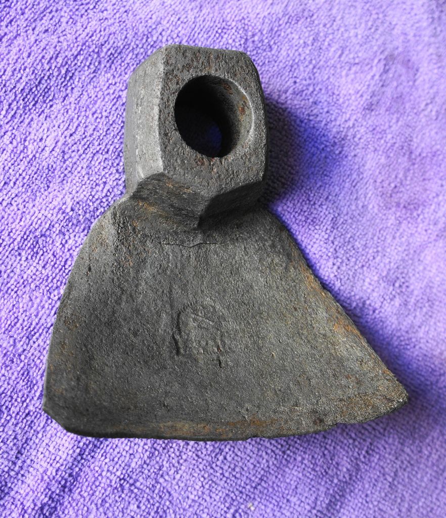

Some pics of the cleaned adze. What looks like a crack below the eye isn't, it's just how it's been forged.
The stamp looks like crossed keys over an animal of some description.
Blurred :rolleyes: but showing the darker hard line or bit, strangely not showing on the other side above... Not much left but enough to get it sharp & have lots of light sharpens.
Not very highly defined but seems to be wrought, I've tried to catch the "grain" in this pic. Grind & handle next.

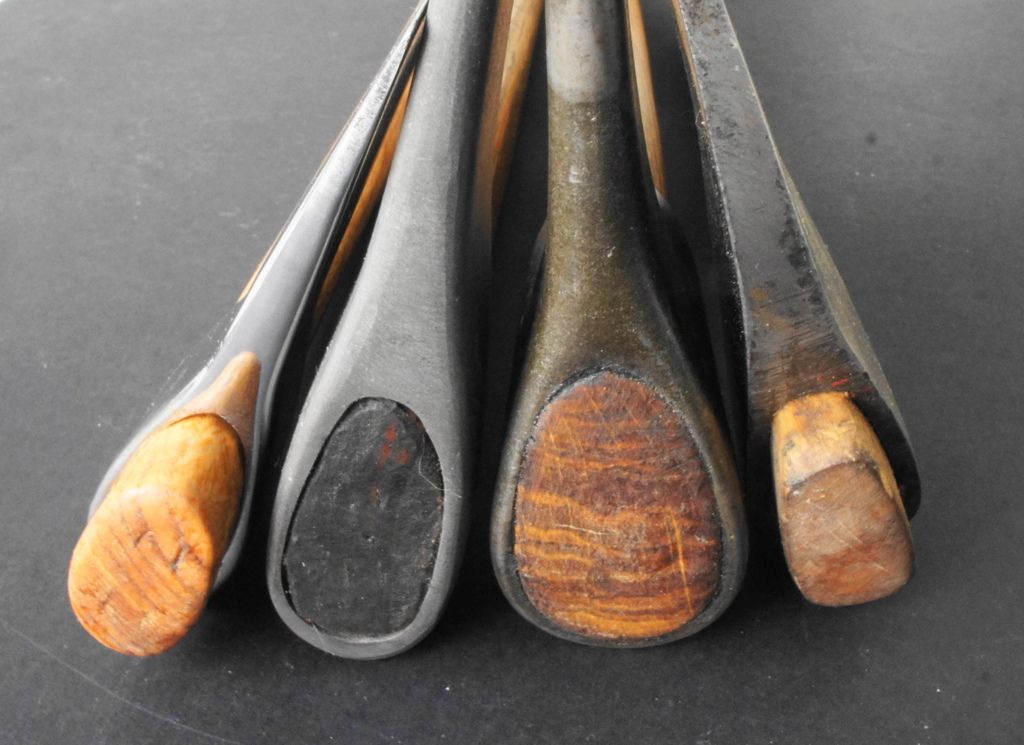

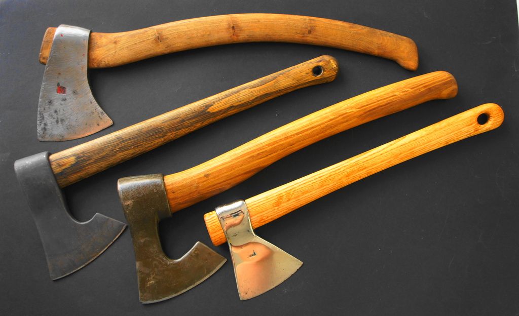

Some of the "slip through" handle hatchets/hawks, two middle heads I modified & etched, the bottom tidler head 9oz/250g I polished, just because.........
No wedges in sight.

That adze is definitely wrought, its steel laminate just a strip on the one side of its bit.
A cheap & easier manufacture, over a full insert steel bit, but lacks durability. Might explain such little steel remains on that bit.
Beautiful photo, though the offset of the handle on that top one goes the opposite direction I'd set it. Love the head on it, and that polished one looks great, too!

I'm not so sure about this one. Are we looking at 2 steels or 3? The seam in the photo above could indicate that the entire bit is high carbon steel forge welded onto a wrought iron eye. It may be that only a small amount of hardened steel remains at the bit. But it could high carbon steel all the way back to the eye. It's just needs re-hardening.
I'm not certain of this but it's one interpretation of what we're seeing.
If the carbon steel is actually a laminate then that's a helluva long forge weld to make.

FortyTwoBlades, yes it'd make more sense the handle curving the other way, but then it wouldn't be different :)
Surprisingly it doesn't feel bad in the hand.

Yes, thanks for that it does explain what I'm seeing. I haven't come across such a thin bit (1mm/40 thou ish) but that's certainly what is welder on this.
Square_peg you can see a tiny bit of the hardened area on the "inside" of the adze, this is indeed either how thick it was originally or what's left of the higher carbon bit/edge. The whole adze has evidence of " grain", I just used the pic of the side of the eye because that's where it's etched the most, so the whole thing is wrought with just a slither of a bit.
As an aside, it just goes to show how very old steel tools benefit from careful cleaning & why I prefer a weak acid such as vinegar or ferric, to show what you have to work with. The big drawback is it's very slow, as in days.
There is nothing wrong with a wire wheel in an angle grinder on some tools, but it needs to he a straight wire brush, sometimes I see things like this this cleaned with a knot brush capable of removing rust rapidly, & metal!
In this case there would be no way of knowing if it had a hardened edge or a bit, & if it had a thin bit like this it'd be easy to grind it away.
Even axes & hammers made of a single piece of steel show a different color where they are hardened, so it's a great way to know if an axe still has a hard edge & how much, a file test can tell it's hard but not how far.

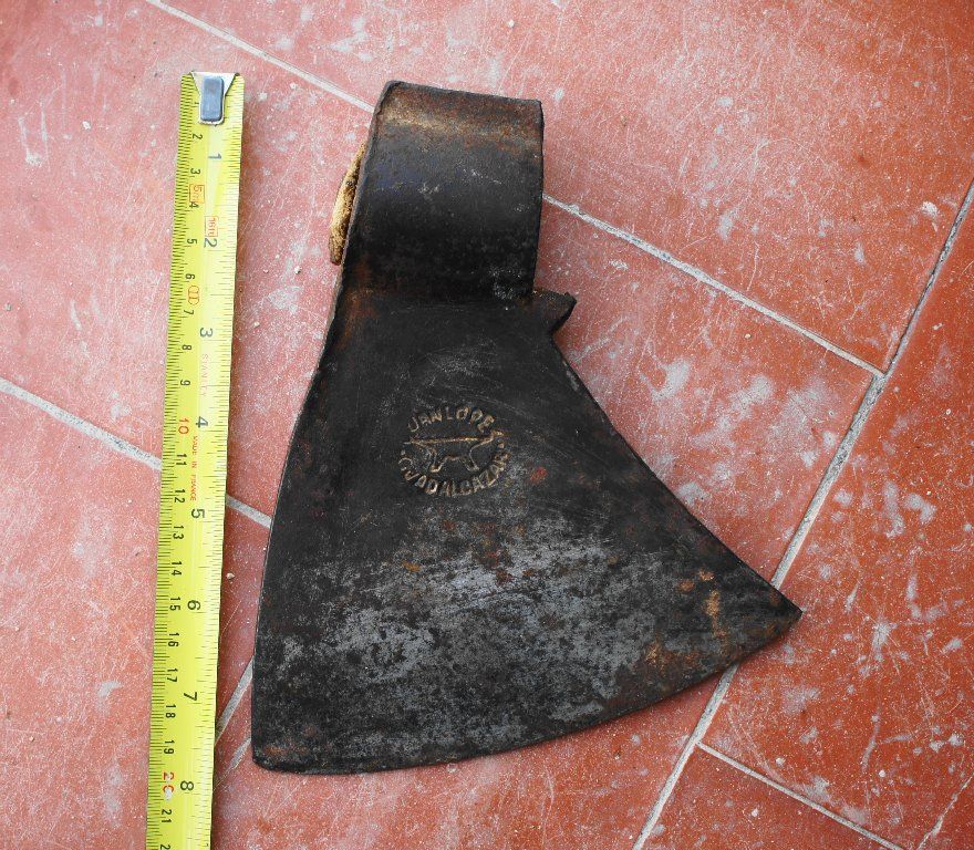

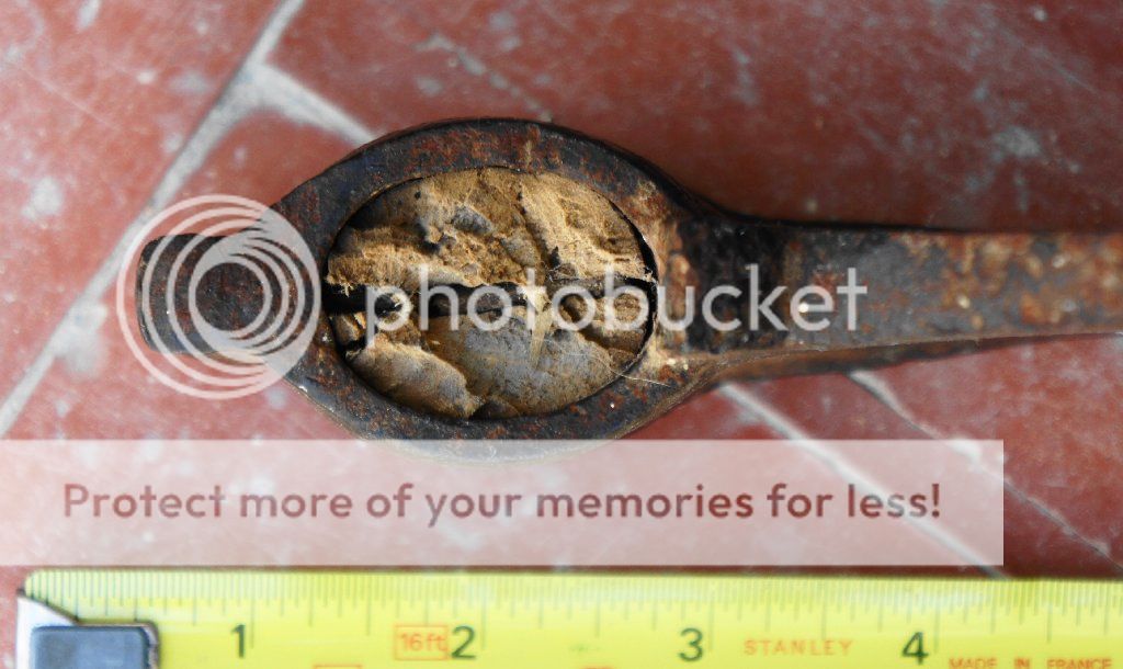

Another interesting shaped head I thought you might like to see, nice deep stamp "Juan Lopez, Guadalcazar" which isn't too far away from me in southern Spain.
2lb 9oz (1.16kg)
J + Z missing I assume.
Not sure about the handle this would have had.
Pictured with another smaller hatchet head of similar style 1lb1oz (0.5kg).
