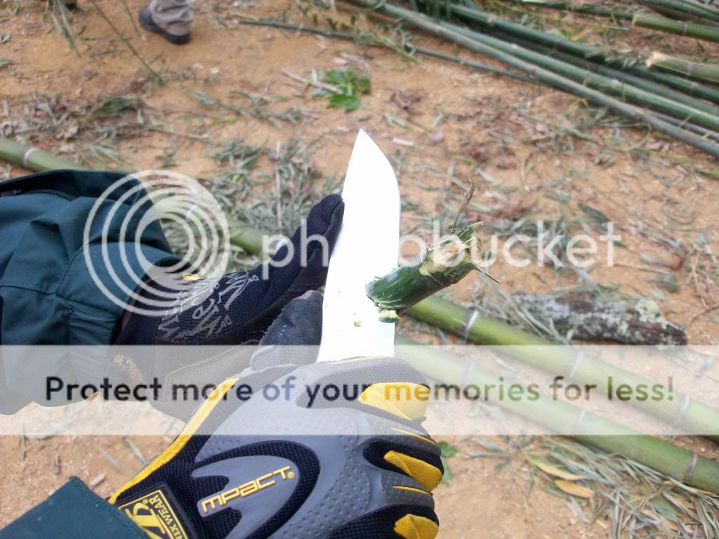

The knife will need to be a bushcraft/camp knife, 4.5" to 5.5" blade geared towards slicing. It will be used for food prep, bushcraft tasks, etc. everything else is open to the maker.

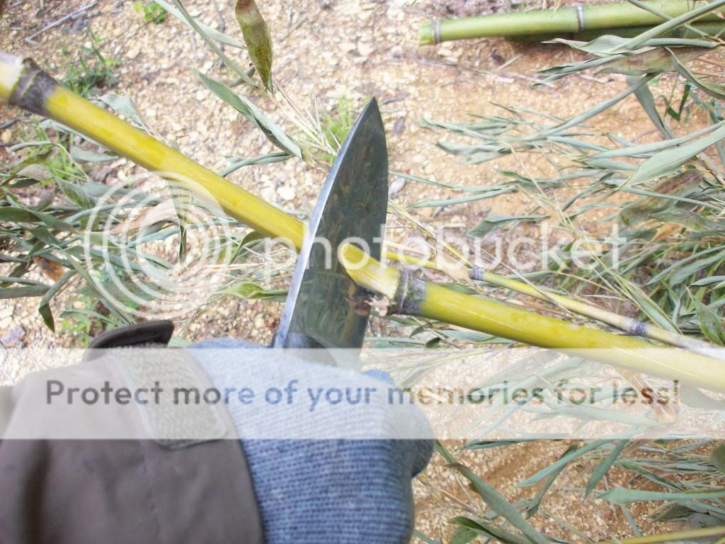

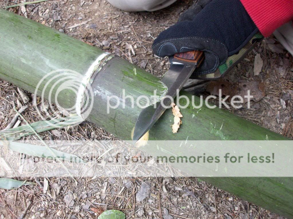

Based on this statement, Ethan and I decided that fresh cut green bamboo would be our medium of choice for the bushcraft/camp knife. Slicing was considered a secondary function, that fell under the guise of carving/cutting. With that, we setup our challenge.

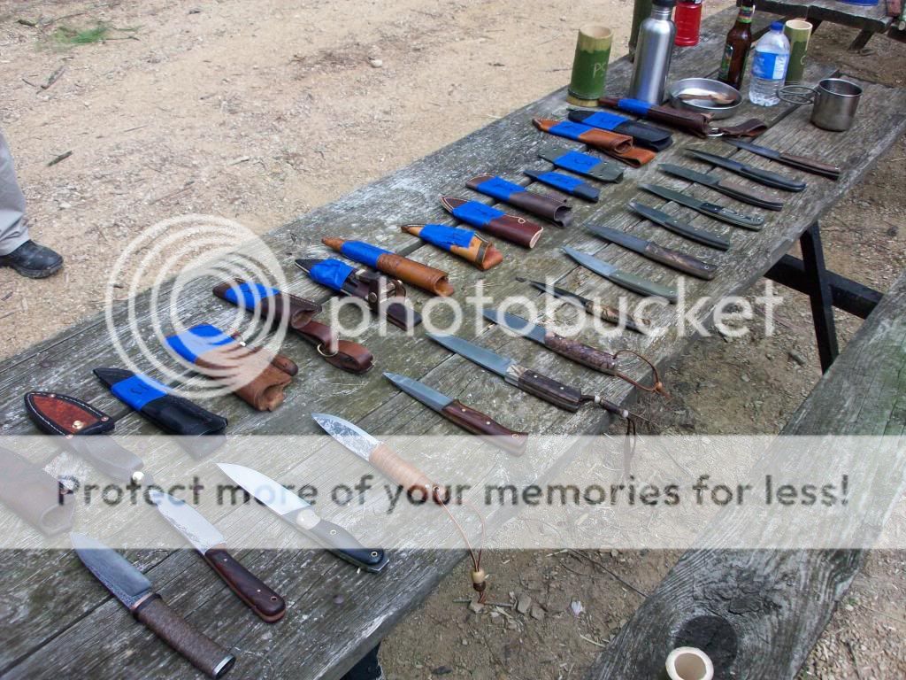

Our testers and people onsite had a wide variety of backgrounds, as well as physical builds. How does this transfer to the Challenge? Some guys would rate a knife ergonomics a 5, others would rate the same knife a 1. Each person is different, and we tried to incorporate that diversity in the testers. The background ranged from weekenders to retired 7th Group Special Forces, to 30 year veterans of knife designs. As broad as a spectrum as I could arrange.
Each knife was individually numbered, with each maker's name being left off the identification of the knife, some were known instantly on sight, some were not discovered until we set down to discuss each knife in our round table meeting.
We basically tested each knife in two categories, Form and Function. How it looked, and how it worked. I broke each category down into sub sections, which are as follows:

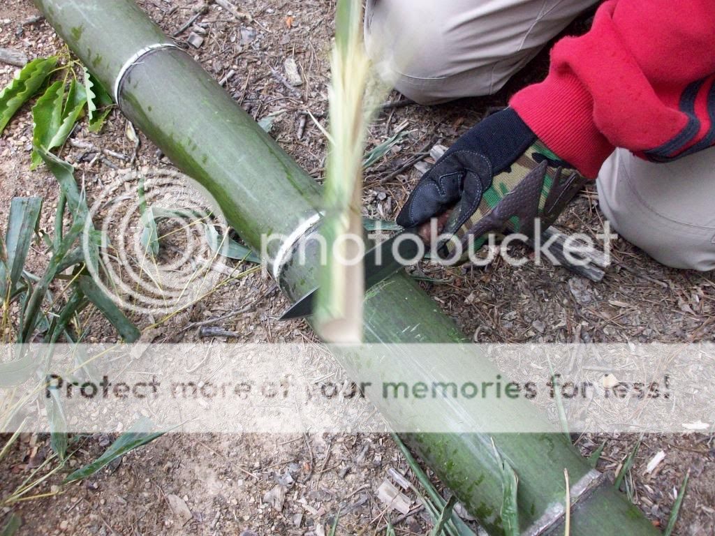

Each knife was set out, used for two days, by all testers, for various tasks, with the most strenuous being used in the construction of a green bamboo bed/platform/shelter. Some knives were batonned, lightly, and by lightly, I mean used to score the bamboo rounds. Only 4 knives were "beat", and that came at the affirmation of the maker. We had 3 makers onsight, and the fourth was a friend of mine, that I could speak for in regards to the use of his knife.
We tried to cover the most basic of cuts that are used in bushcraft, push cuts, lever chest pull, snap cuts, and tip boring. I could not be everywhere, to take pictures of everything, and that is my greatest regret.

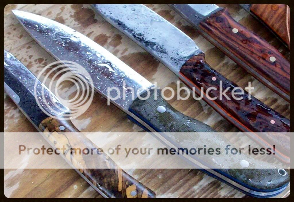

Regarding the pictures that will follow, as I said, my biggest regret, was not being able to photograph every knife doing everything. With 8 testers, 16 knives, and around 25 people on the hill, there was much going on, everywhere, everyplace, all the time. That is my fault, there were several people taking pictures throughout, and I will be in contact with them, to get as many pictures of the knives as I can.

I used your stock photo's, mostly because I suck at taking pictures, and I failed to get individual pictures of each blade. That is my fault, and I apologize.

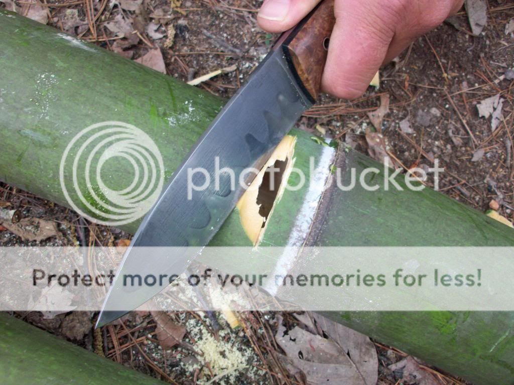

Dave Behrens
Form
Aesthetics/Fit/Finish (AFF) 5,5,5,5,5,4,4,5 Total 38
Very well done symmetric package. Fluid lines, even grinds on the handle, and blade. The micarta was left a little rough, which just grabbed in the hand. No gaps. The handle just fits the hand perfect, creating a natural comfortable grip.
Overall Package (OP) 4,5,4,3,5,4,4,4 Total 33
Stunningly tooled and stitched sheath, with double threading. Wide loop on the back for variety of belts. The knife sits deep, with stiff but smooth retention. The knife came in a package that could have been punted into the yard, and not moved the knife.
Design (D) 5,5,5,5,5,5,4,5 Total 39
Simple design, simple materials. Even convex/saber grind, with a strong tip. Slight relief behind the blade, allowing for a comfortable choke up on the blade. Contours of the handle are well placed and even.
Use
Comfort (C) 5,5,5,5,5,5,5,5 Total 40, aces
Prolonged and strenuous use was easy on the hands. A very natural grip.
Edge (E) 5,5,5,5,5,4,5,5 Total 39
thin edge, but nicely contoured to a microbevel. Created good seperation on splits, and held up to boreing holes.
Edge Retention(ER) 5,5,5,5,5,5,5,5 Total 40 aces
Never sharpened, still slices paper cleanly
Overall (OAL) 4,5,5,5,5,5,5,5 Total 39
Just a solid built knife and sheath, that can take some use, but slice thin veggies. The comfort and edge retention really made this one a pleasure to whittle and carve with.
Final total 268

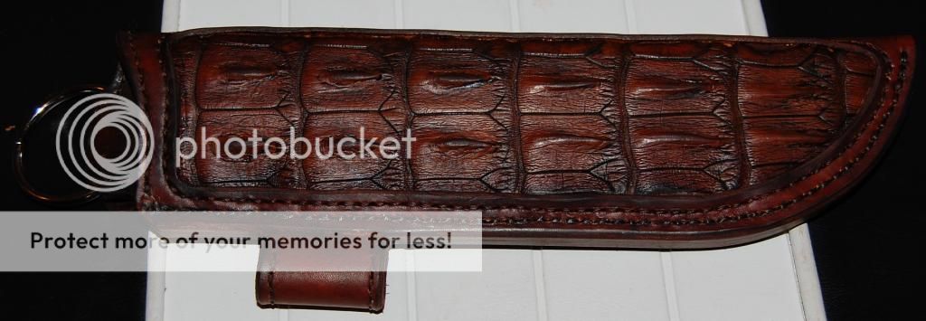

Matt Tackett
Form
AFF 5,5,5,4,5,4,5,5 Total 38
No gaps, symmetric grinds. Handle was even, with a grippy finish on the wood. Pin placement and color choice, were well thought out. The hamon line is eye catching.
OP 5,5,5,5,5,5,5,5 Total 40 aces
Um, BaldingEagle sheath, left nothing to be desired in a knife scabbard. Excellent craftmanship, combination leathers, and an aged dye job. Really brought the right attitude with this knife. Knife sits deep, with a smooth draw. Very smooth.
D 5,5,4,4,4,5,5,5 Total 37
Simple, basic bushcraft design, with a good balance and well proportioned handle.
Use
C 5,5,5,5,5,5,5,5 Total 40 aces
No way, no how was this knife a chore to use. Very comfortable in the hand, powerful grip potential everywhere. No hot spotting on the front hollow pin. Thick blade, with a good high grind, and well balanced.
E 4,4,4,4,5,5,5,5 Total 36
Thin edge, but robust shoulders. High grind, and a strong tip.
ER 5,5,5,5,4,5,5,4 Total 38
Never sharpened, was still scary sharp at the round table.
OAL 5,5,5,5,5,5,4,5 Total 39
Colonel Defender picked this knife up, first thing, as soon as I set it out of the box. Once it was numbered, he put it on his hip. The only time he took it off, was for the the rogue's gallery photo, then it went back on. We had to go ask to use it. As soon as the round table was done, he paid Matt.
Final Total 268

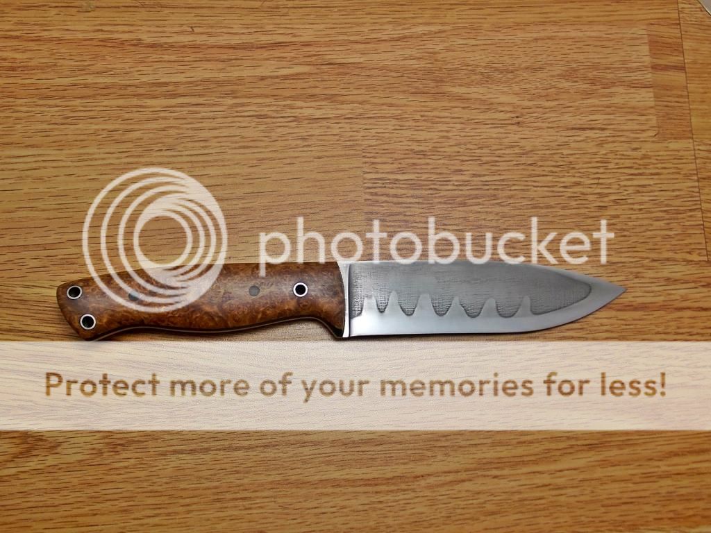

Todd Hunt
Form
AFF 5,5,5,5,5,5,5,5 Total 40, aces
Todd's entry was a nice build. The added corian was nice. Flowing lines, symmetric grinds, no gaps
OP 5,5,5,4,4,4,4,4 Total 35
The sheath was simple, robust, waterproofed, with even stitching. Held the knife low and secure, with a smooth, but firm draw.
D 5,5,5,5,5,4,5,5 Total 39
Very utilitarian point, with a thick edge grind. Balanced well in the hand
Use
C 5,5,4,5,5,2,5,5 Total 36
Very well contoured handles, no hot spots at the corian transition. Bird's head makes tight grip area.
E 5,5,5,4,4,5,3,5 Total 36
Thick edge, but symmetric. Had to work the blade into the media sometimes.
ER 5,5,5,5,5,5,5,5 Total 40, aces
Hair popping sharp when it came, and left.
OAL 5,5,5,4,5,4,5,5 Toatl 37
Very solid, overall package. Simple sheath, fancy blade. The added corian over black, made for an eye catching combo. Nice, comfy handles, with a stout blade. Highly sought after throughout the entire ordeal. It left with Todd. :grumpy:
I did pick up a Yuma, though, and I do believe the final name for this blade, was the Tradewater.

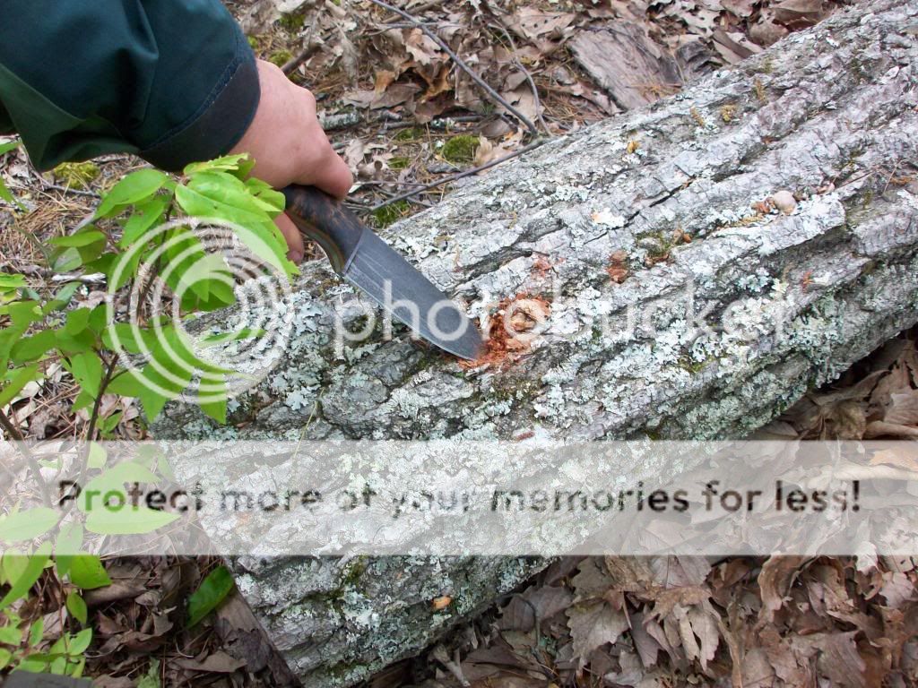

Battle Creek Knives
Form
AFF 4,5,5,5,5,5,5,4 Total 38
Even grinds, no gaps. Nice selection of wood. The mosaic looks like a correction, but is well done. Slight raised areas on the pins and material transitions.
OP 5,4,4,4,4,4,4,4 Total 33
Simple, but rugged sheath. Knife sits deep with loose retention. Nice even stitching, but matching firesteel.
D 4,4,5,4,4,3,3,4 Total 31
Basic bushcrafter with some flare. Round "broomhandle" style handle, and pointy tip.
Use
C 5,5,5,5,5,5,3,3 Total 36
Broomhandle style handle was first met with criticism, but grew on the testers for a comfortable cutter. Rear weighted and balances well.
E 5,5,5,5,5,5,5,4 Total 39
Scandi grind with a stropped microbevel. Cut like a laser
Poppin' hairs coming in, and going out.
OAL 4,4,4,5,5,4,4,4
Taken from the bushcrafter basic design, Rob hands off a tough, no nonsense package. Rugged scandi grind, with round, filling handle, and a basic sheath that till take you right to the woods, right out of the box.
Total 251

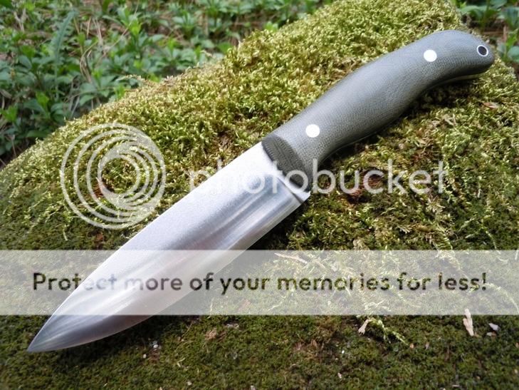

Adam Gray
Form
AFF 5,5,4,5,5,5,4,4 Total 37
Beautifully rendered wood over micarta handle. Symmetric grinds, flowing lines, brass hardware.
OP 4,4,4,4,4,4,4,4 Total 32
Simple, pouch sheath, but well done. Sinew stitching, "bushcrafter" squared bottom, with a dangler belt loop. Knife sits deep, with a firm grasp of the knife
D 4,4,4,4,5,4,4,4 Total 33
Saber grind, with a dramatic point. Reliefs cut at the top of the handle, with a wide bottom at the lanyard hole. Slightly "boxy" feel to the handle.
Use
C 5,3,4,4,5,4,2,4 Total 31
Squared off corners at the reliefs cut at the top of the handle, wore on the hand some. Smooth finished wood got slippery when wet. Fills the hand well, with slight contours
E 4,2,4,4,4,4,3,4 Total 33
The edge require an effort to get it and start cutting, which is strange, its a rather thin edge. Wasn't hair popping sharp, but had a toothier edge, which worked well in the bamboo
ER 5,4,5,5,4,4,3,4 Total 34
Drags hair off the arm, but it don't make it jump off
OAL 4,4,4,4,4,4,4,3 Total 31
I was surprised the scores weren't higher on this knife, as, my opinion was, it was well done. I do know that there were mixed feelings about the handle, and the edge geometry.
Total 227

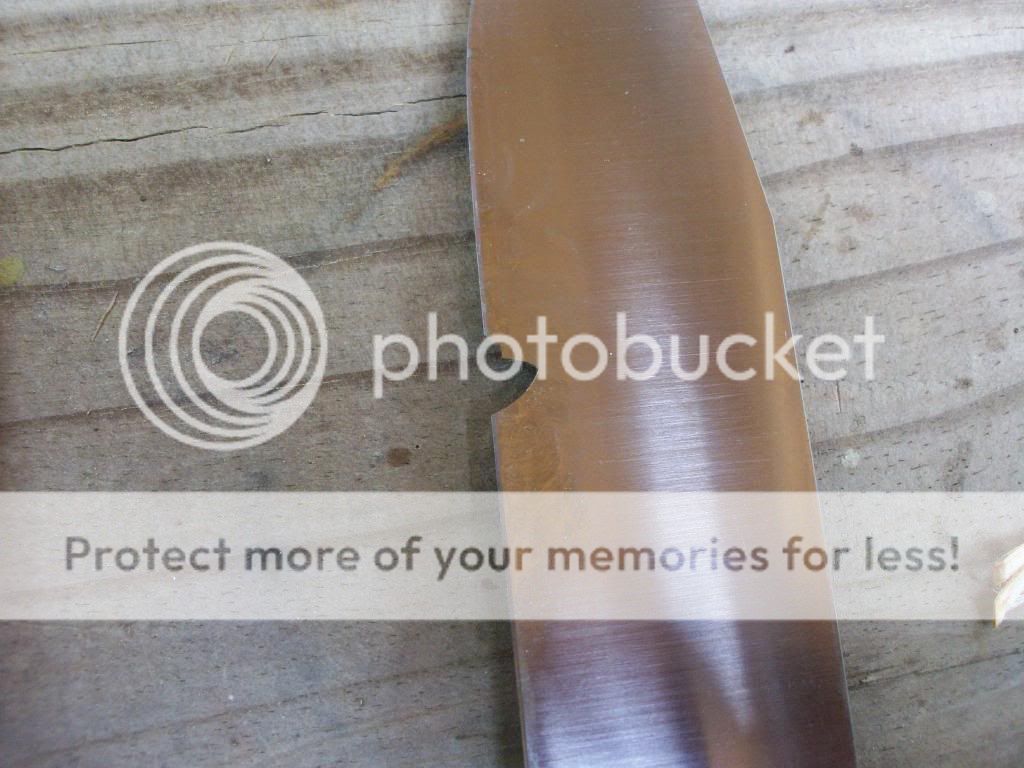

E 4,4,4,4,4,4,4,4 Total 32
Thin edge, but with a deformed edge grind. Looks underground about an 1 1/4" out.
ER 3,4,4,4,5,4,3,4 Total 31
Won't cut hair, but will rough cut paper
OAL 4,3,4,3,3,4,4,5 Total 30
Nice blade, but the edge deformity and blunted tip are hard to overlook. Comfortable handles though.

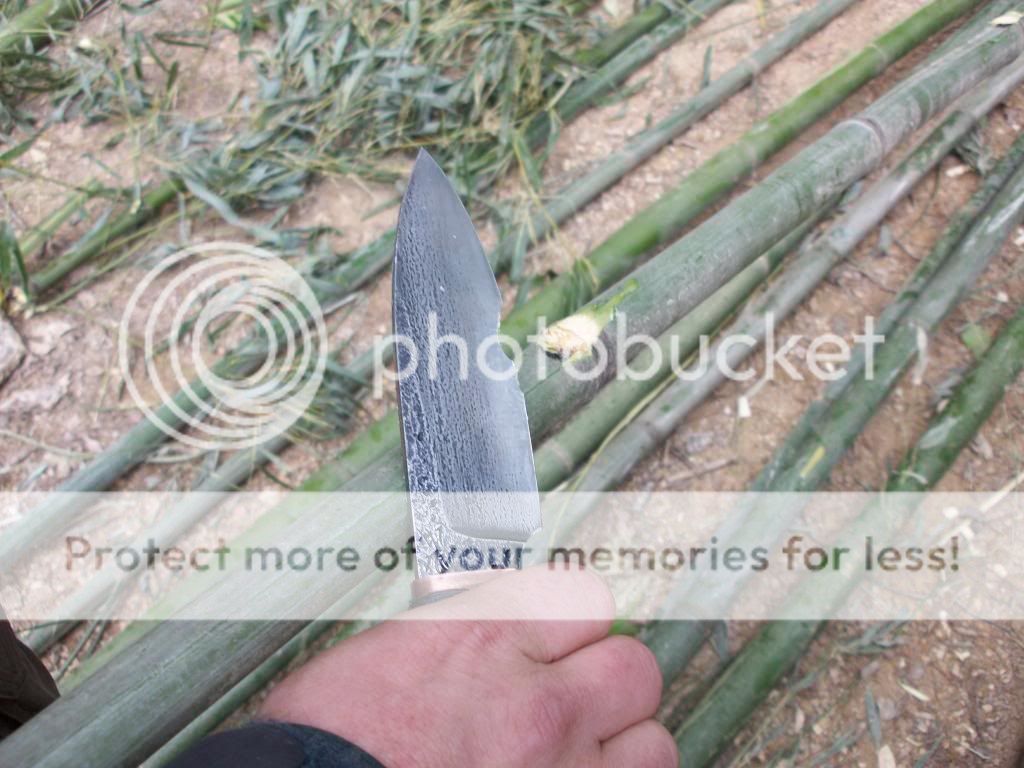

Chris Berry
Astoundingly beautiful knife, with excellent fit and finish. I mean, the micarta grain on the handles matches perfectly. No gaps, with even, smooth flowing lines. The word sexy comes to mind.
The entire blade was very thin, with a whisper thin edge. Slicing through the bamboo, was a breeze.
For the purpose of slicing, which is what the maker had in mind, there was only one other to be counted in the same category.
Well well one kydex sheath, with no belt attachments, but excellent retention, and a smooth easy draw.
I loved this knife, and I showed this knife especially when I told the guys no rough stuff with the thin knives.
This was the first one to go, then another, then another, and then another. We lost 4 knives in 15 minutes or so. I was literally sick to my stomach.
Chris makes a fantastic knife, this in no way should reflect poorly on his work.
Donald Lawson
I loved this knife. It was one I was really wanting to use. The burlap micarta is magnificent. The handle is a little square, but with the thin edge, thin grind, and thin stock, this one was the slicer. Nice coutours on the handle, and plenty of real estate to find a grip.
The edge rippled, which sucks. Honestly, you were able to really get a lot of leverage with that robust handle and get plenty of power in to the cuts.
No gaps, the hardware was well hidden in the color pattern of the burlap. The grind had one spot near the height of the plunge.
What a great knife, and Mudbugz007 will be getting a call from me in the future.
Rick Marchand
Easily the most sought after blade at the Gathering. I wanted it, Ethan wanted it, Derek wanted it. What a gorgeous knife.
If it hadn't chipped out, I do think it would have one. The handle is simply breathtaking, comfortable, and had plenty of real estate for your mitts.
It had a thin edge, with a robust convex grind behind it. Sticky sharp, and had some heft.
The sheath was a work of art. I'm not sure how he does it, but the leather is brilliant.
There was nothing about this knife I didn't like. Cut like it had a motor on it.
Damn.
Daizee
My knife. I threw it in the mix just because. Obviously, I'm gonna be biased, so, I'll spare you.
Thick high grind, with a thin edge. A grip that fits like a glove.
The edge chipped out on it, but it was so small, it will be gone on the next sharpening.
The guys were instructed to cease and desist immediately up noticing an issue. Once it chipped, it was taken out.
