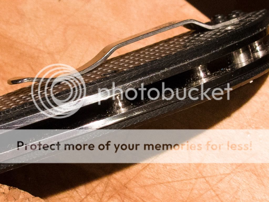

That's a nice pic clearly illustrating LAMINATE carbon fiber. See is single shiny wavy layer on the very outside of the scales? That's the carbon fiber. The rest is g10, which is also layered.
No, you're seeing the bevel (dark outside) and the non-beveled portion.
Try this for a slightly better view:
Or are you just being argumentative??? ;)
Here's a pic. Lighting is not great, so the bevel looks darker, but you can see that the scale is uniform all the way through.
Brother, that picture clearly illustrates the laminate. The layers you see are standard fiberglass layers in G10. I know it's not what you want to hear, but that's quite clearly a laminate just like all other GBs/sage 1s. :)
Ok, I'm going to have to make a video to show you the difference between CF and G10. Those scales are G10 with a SUPER thin laminate CF layer on top. You're confusing the striations of fiberglass with CF. :)
Nope, I see the bevel, it's beveled g10. The cf layer is literally just the very outside layer, about the thickness of a sheet of paper.

I love it how nobody in here is a composites engineer, and everyone seems to think they're right. Lets clear a few things up:
First and foremost my Gayle Bradley is clearly just a layer of carbon on top of G10. I can't speak for all models out of Taichung, but all models out of Taichung I have seen posted here also are predominantly G10 with simply a top layer of carbon fiber.
Is it as strong as carbon fiber throughout? Well if you look at it from the more limited engineering definition, strength in this case would be defined as tensile and compressive strength, and thats a no. Additionally you have to look at production processes. A composite thats been bonded as a sheet (remember this is made of layers of quite literally fiberglass/carbon fiber cloth which are combined with resin and generally cured under pressure and controlled temperature) has very different structural properties from a sheet which has been bonded separately after curing. If you look at composites failures they occur, almost without exception, along lamination lines. Bonding a thin layer of carbon fiber to the top of a, hopefully, carefully finished layer of G10 simply will not be as strong. Even if you do everything perfectly, you inevitably come up against the fact that you're creating a slightly thicker resin layer which will be the weakest link. Long story short, from a technical standpoint its not as strong, and the picture posted by 5.56 is a clear demonstration of exactly that. There are two other things to consider here though. G10, generally speaking, has a higher toughness than carbon fiber. This is because glass fibers, again there is some complexity I'm glossing over but "all else being equal," have a greater elongation prior to failure than carbon fiber. This makes G10 better able to tolerate abuse eg as a knife scale. Anyone who has abused their carbon blades has probably noticed the carbon has a higher propensity to chip than their G10 ones. ;) There is something else too: knife scales, particularly in knives with liners, is essentially a non-load bearing application. If you think that four screws, most of which are toward the edge of your liner and countersunk most of the way through your composite, are making your knife hugely stronger you are in for a big surprise. If knife strength were an issue the composites would be bonded directly to the metal, not just slapped on with a few tiny little screws which also grossly violate the fibers. Its almost purely aesthetic, and if you want a cute little demonstration of that you can always substitute your G10 for paper or cloth micarta and realize the knife is functionally unaffected.
