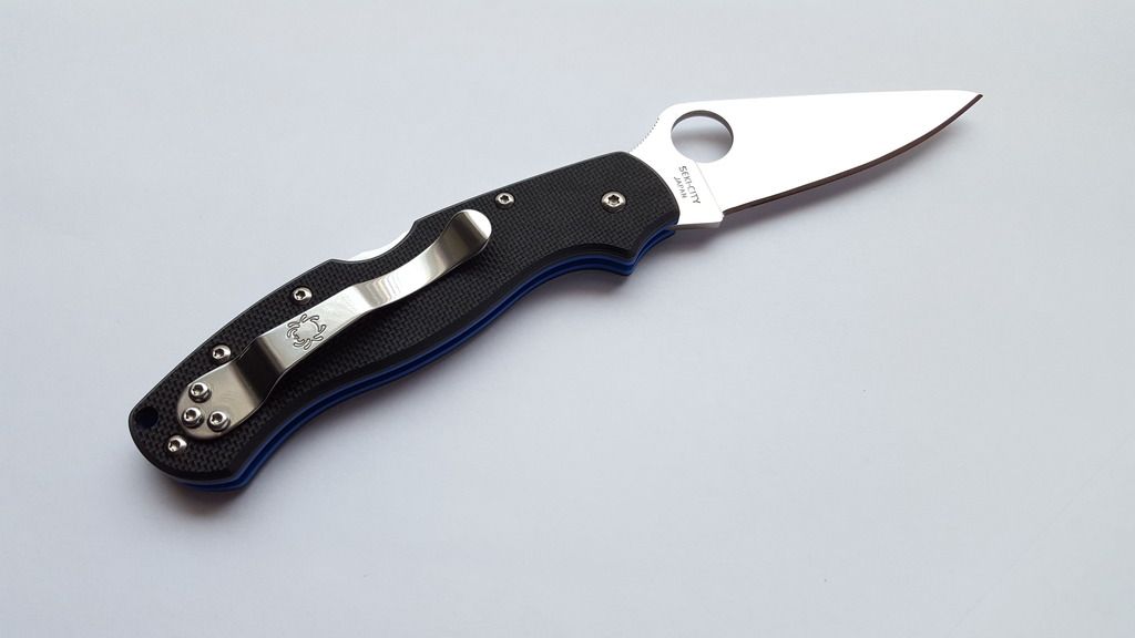

Finally got around to grinding down the tip of my Delica liners on the Hap40. This was my first time even taking a knife apart and it was easy as pie.
The scales turned out perfect, they were an experiment from Boomer but it ended up exactly how I wanted it to. Now it needs a Casey Lynch clip.

Wow! Looks great!!
I just got home from vacation and had a set of the G10 scales waiting for me in the mailbox. I'm looking forward to converting the donor Delica I bought into a Lil Para.
i just put it together and can get better light pictures tomorrow and adjust screws but very happy with the look.
I think the scales turned out great!! A big shout out to Steve for doing fabulous work!

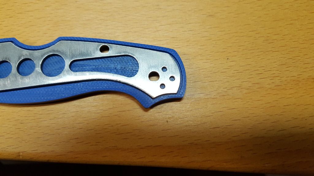

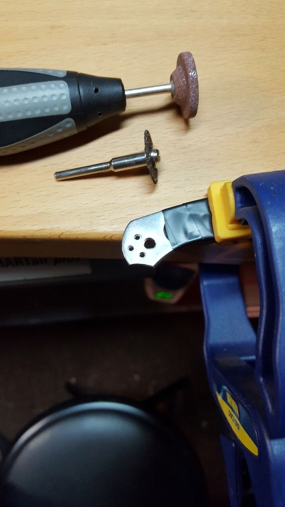

For those interested in the grind mod version of these scales but are hesitant to cut the corner off the liners for the choil, it's very easy. All I did was lay one of the uncut liners in the new scale and pushed the d-pins through holes in the scale and liner to line everything up. Then I took small scale ruler and laid it on the liner and drew a line from corner to corner of the liner recess in the scale below with a fine-point Sharpie. I taped both liners together with electrical tape and used a couple quick clamps to hold it to the front of my work bench. I cut the liners with a cut off wheel on my rotary tool then I used a 7/8 dia. grinding wheel to grind the radius. You can cut the liner straight but I'm a bit of a perfectionist and wanted it to match the contour of the scale inside. Modding the liners only took about 15 min total including prep work.
