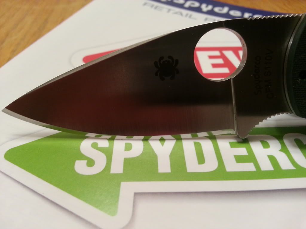

It came fairly sharp too, but way too toothy for my liking, so onto the wicked edge she went for a reprofiling and polishing. Took it back to roughly 25° inclusive (we're gonna see what this steel is really about) and put a mirror polish (okay, so very near mirror, s110v sure doesn't like to polish up nice) on it up to 0.5 micron diamond spray on the balsa wood strops and now she's an absolute laser. I'm curious to see how s110v holds a fairly acute, extremely fine edge, whether it will hold a razor edge well for a long time, or whether it will lose said razor edge quickly like s30v, but hold a very serviceable working edge nearly indefinitely. Despite my urges to habitually sharpen every knife I can get my hands on, I'm gonna try to hold off on sharpening this one for a while and see just how well this steel holds up.
You put a 12.5 degree per side edge on it?
Yessir.
Please excuse the crappy cell phone pic...
Nice MK, I haven't got to it yet been busy since I received them but I plan on having a sharpening night with the S110v and K390 with some Maker's Mark to help me out.
Yessir.
Nice work. I can hand sharpen decently but can't get anything to look like llike that. The WE is out of my budget but I've thought about getting the Lansky but its limited to 17, 20, 25, and 30 degrees. I'm assuming that when the Lansky is used at the 20 degree setting its actually 40 degrees inclusive?

The S110V blade is amazingly shiny..it could almost be used as a a mirror.

Correct, the 20° setting on the Lansky would be 20° per side, or 40° inclusive. The wicked edge, in combination with a digital angle cube, really is the best system out there for reprofiling, but to tell you the truth, once I've set my initial bevel, I usually do touch-ups freehand.
