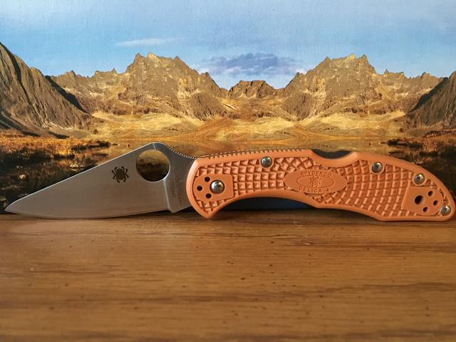

Loving my HAP40 Delica, it's been riding shotgun in my right front pocket since I got it, about 3 weeks ago. I'm not going to pretend like I know anything about steels but this stuff is amazing. Holds an edge very well, only touched up once on the sharpmaker, with 3 weeks of moderate use. I work in the produce business so I am always cutting up fresh fruit for "quality control" purposes (and I get hungry) and hasn't developed any patina. Maybe one day I'll force a patina.
The Delica 4 was my first spydie and is what lead me down this rabbit...errrr spydie hole of addiction. I don't see anything kicking this out of my pocket anytime soon. Well, maybe a hap40 dragonfly!
Here's a pic I took when I first received it, set against the back drop of a...tissue box? Yes, the coolest tissue box I've ever come across...
