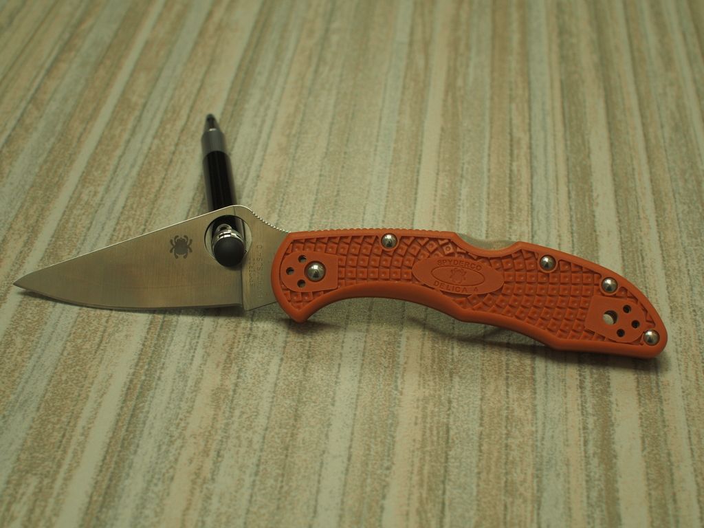

Well, I did some more grinding on the spine of my stretch yesterday. I ground the hump down flat as soon as I got it and ended up with this.
It was perfectly functional but I never really liked the way the tip looked so I decided to smooth the angle out and blend it into the curve. This is what I ended up with. Excuse the scratches...I did some heavy corrosion resistance testing in my kayak and had to clean the rust off with some abrasive. Used heavier stuff than I would have liked but whatever. I'll polish it out one day...maybe.

Looks good. Scratches don't bother me.
Next time you are taking pictures can you get a pic of the top of the blade. I woukd like to see what it looks like after grinding. Thanks.

Hi Johnny, I'm too lazy to get a picture right now but it is very easy to make the spine look like it has a factory finish. I find that 180-220 grit paper will give you a finish that matches the factory grind well.

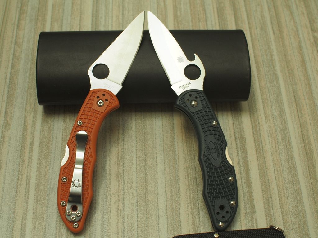

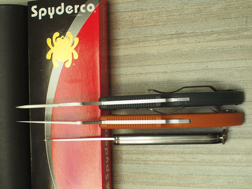

Snagged one Delica while passing the time at the mall...
It's lighter than my waved Delica
But the blade tip is LEEKishly;) thin (Alox Cadet at the bottom for comparison)
