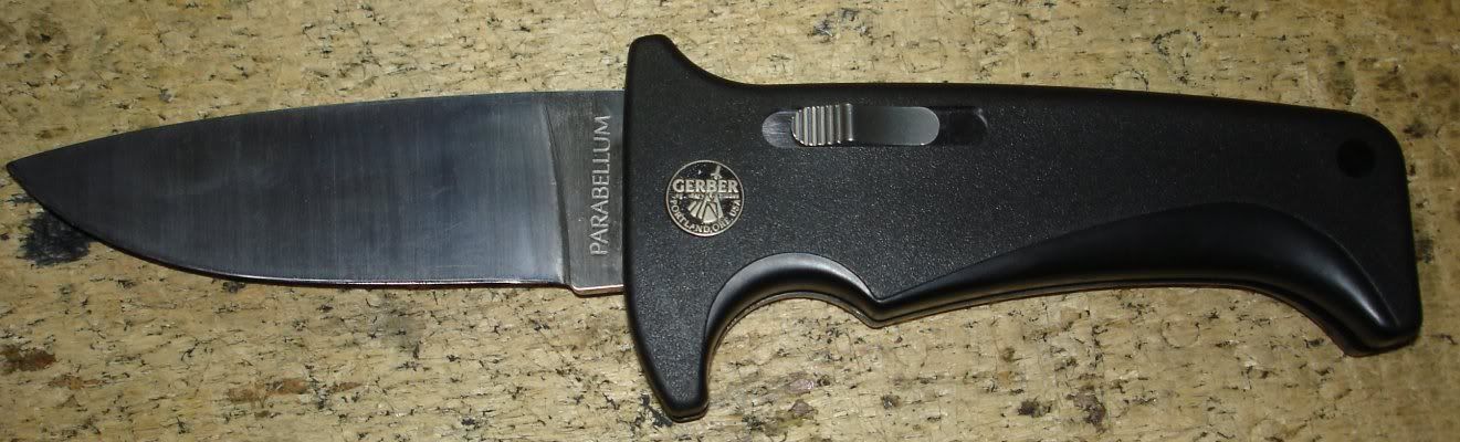

Sal, how about a first run Bolt Action? I'll dig mine out and get it in the mail tomorrow.
Is there a schematic? (Curious about how this works - is there a patentee name I can use to search online?)
Blackie Collins designed it, and as far as I know, Gerber implemented it first. I don't know who got the patent, as this one was before and the only other knife I have with that lock doesn't say.
I have to say that looks very nice and I'm interested to see it in a Spyderco.
Yab's, is it a nice lock in use, tight lockup, easy to disengage etc?
It has a tiny bit of vertical play, but I carried it for a work knife when I was in the mobile home service business years ago, and it got used pretty hard. Easy to operate with either hand for me (I use my middle finger to pull the bolt back and my index finger to push the blade down when using it left-handed). It's still a pretty solid piece even after all these years (I bought it back in the mid-80's IIRC). Now that I've thought about it a while, it may have been called the Parabellum, but I couldn't swear to it.

Found this, so yours may (or may not) have been called something else.

You're right as usual, Paul. I thought mine was just called the Bolt Action, but I haven't seen the box in twenty years.
By the way, Paul, although this particular model was right-handed, it could easily be made ambidextrous by adding a slide to the other side.
I have a Parabellum, same lock, but bigger knife. From the good old days of Gerber. I think you could wack the back of it all day and it wouldn't let loose.
Patent number on my knife is 4451982 if that helps.
The only issue I have with the "bolt action" lock is the blade stop is the plastic of the handle. On the one I used hard, the blade developed a bit of wobble as the self adjustment was used up.

As far as "flickability", my Bolt Action doesn't have any. Even with the bolt held back, the blade doesn't swing free, even after years of use. Two hand open, one hand close.

Yab are you sure that's your knife. It hardly looks used.:D

Yeah, that one is from way back in the day, when Gerber ran their steel harder than Buck. It held up pretty good.
