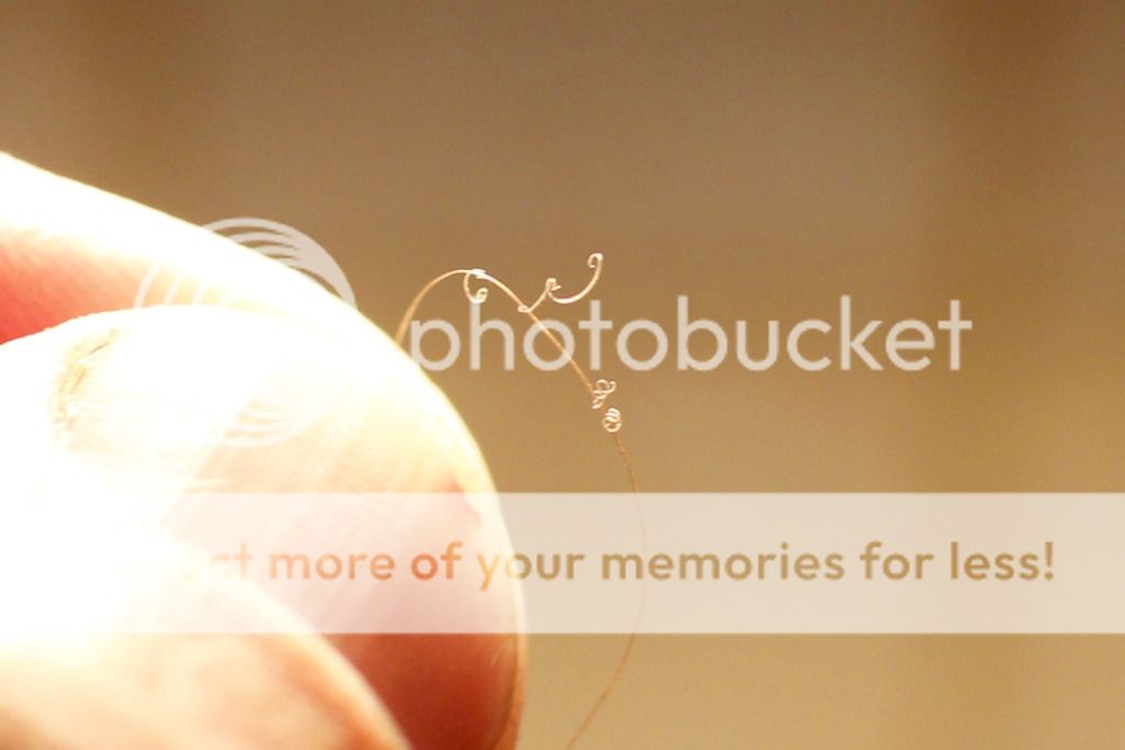

By step down, do you mean finishing with a finer grit? The short answer is yes, it can be a bad thing, depending on the intended use of the knife. A highly refined edge is great for pushcuts but does not make a great slicer.
If you are looking to shave your face then the more refined the better. If you are looking to cut string, rope, cardboard, zip ties and most of the other things we cut on a daily basis, a more aggressive edge will work MUCH better than a highly refined edge. Try cutting a piece of polypropylene rope with a polished edge and watch how that edge will just slide across it as if it's not even sharp. Trying the same with a more aggressive (lower grit) edge and it will "bite" and cut right through. Just depends on what you're cutting. For my uses I find the finish I get off the flats of the medium rods to be almost too refined for most of my uses. I can bring most any steel to hair whittling sharp off the medium sm rods.
In fact, here' a pic I took just a couple of days ago for the hap40 thread. This edge was finished with a 40 degree microbevel on the medium rods. I suppose I could have taken it all the way through the UF rods, but why?
I'm not trying to tell you the uf rods are worthless. Absolutely not! They are lots of fun and will help you get some of the sharpest edges you've ever achieved. They also work well to maintain serrated edges. I just don't find them necessary for my everyday edges.
