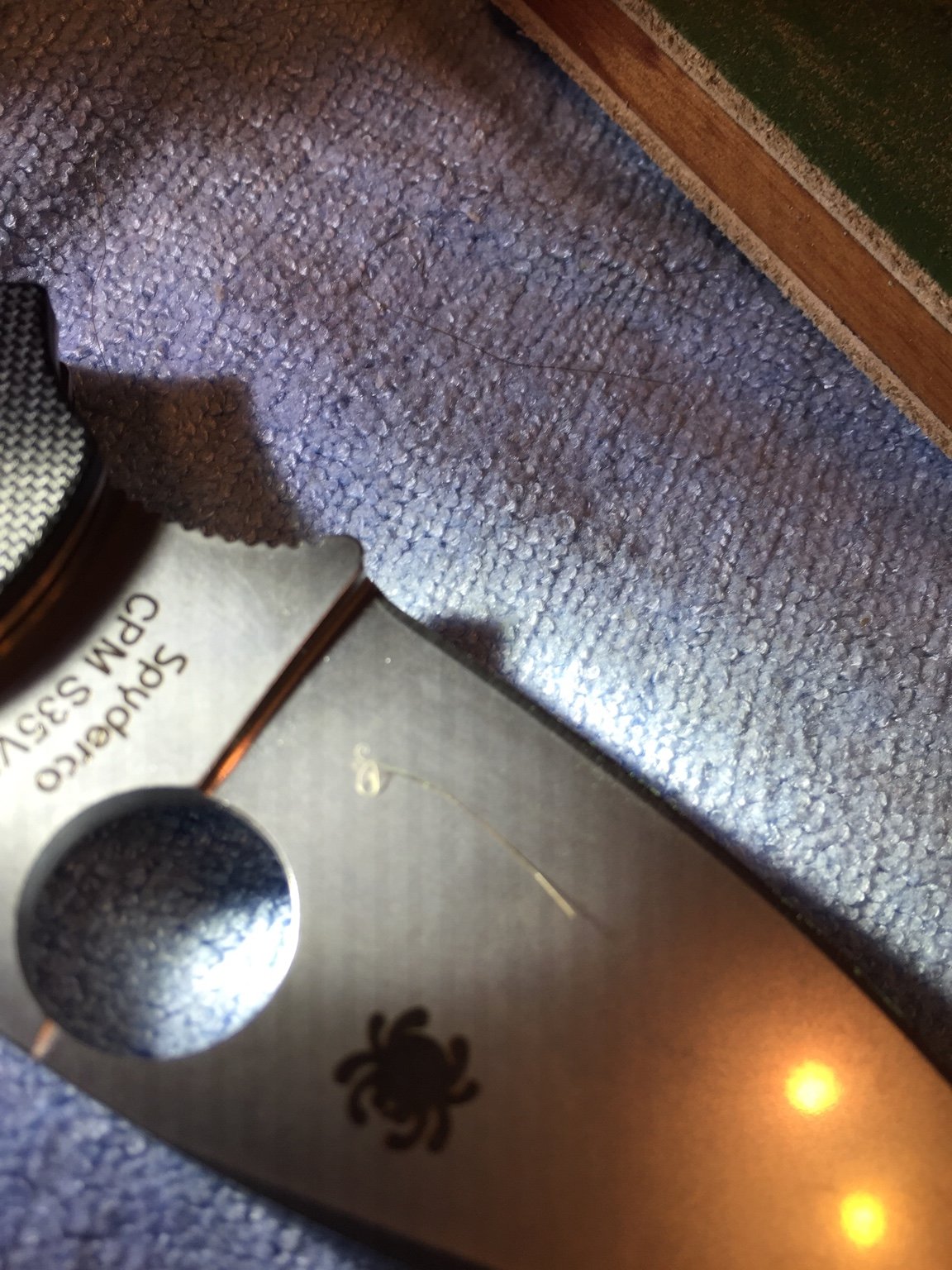

I did it guys! Hair whittling edge with a sharpmaker and strop.
I'm a complete amateur. I've sharpened maybe ten knives in my life, all on the sharpmaker. I went all the way to the uf stones and then stropped it. Until today I wasn't even sure if I was stropping correctly.
I realize it's far from a good hair whittle. I'm not even sure if it counts. Mostly I was just slicing the hair in half but I finally got it to shave/curl a little bit. I'm also 95% certain this was luck. Thanks for reading my excitement.

Well there you go. You can't expect to be making feather sticks on day 1 but if you have made it that far you know what you're doing is working! :) Now you will get faster and more efficient and your results will continue to get even better. Once the novelty of polished edges wears off you will likely revert to finishing at a lower grit as that type of edge performs better for most tasks. The good thing is once you apply all the technique you are practicing now, even your low grit edges will be insanely sharp!
