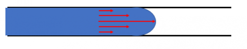

But, the discussion around just the pore throats (and surface tension) misses another potentially important point: even if you are able to “push” resin through a pore throat, it takes time to allow the resin to flow through the pore system.
Think of this like flow through a pipe or garden hose. Typically, the flow looks something like this:
(technically I have taken some liberties here, and so this picture is not totally correct – but lets just use this for now). Here, the black lines are the outer surfaces of the cylindrical “pipe” the fluid is flowing through, the blue is the flowing liquid, and the red arrows are meant to indicate the speed of flowing fluid at that location in the tube. You see that the fluid flow is fastest in the center of the pipe, and slowest near the walls (and is actually zero at the walls themselves). Technically the shape of the velocity is a parabola. The liberty I took in the picture above is that I implied there is an “interface”, or meniscus, at the front of the flow … but even if the pipe is completely filled with fluid from the entry to the exit, this “parabolic flow” is the case.
It is perhaps (hopefully) intuitive that: if you increase the pressure, the fluid will flow faster; that if the fluid is more viscous it will flow slower (for a given driving pressure); that if the tube is longer, there is more friction at the walls, and so the fluid will flow slower, etc. In our wood, for very small pores, and a pretty viscous fluid, that flow could in fact be pretty slow….
Under certain circumstances, which we can reasonably take to be the case here, this flow is described by a well-known and highly accurate equation called the Poiseuille Equation (I wont even go in to how to pronounce that!):
Average velocity = (driving pressure * radius-squared) / (8 * viscosity * length of pipe)
(I have rearranged a little from the typical way this equation is written to focus on the velocity through the pores). Here we can assume the pressure is just the outside pressure, because there should be a near-vacuum inside the pores. We know the radii of the pores, and we know the viscosity of the resins. The only remaining piece of information we need to calculate velocity is the “length of the pipe.”
As an assumption, which I would propose is “worse case”, I would propose that we assume the length of the pipe is equal to the largest dimension of the piece being stabilized (just in case there is a pore near one surface, but happens to not be connected to that surface – but instead is “filled” from the far side of the block. Seems that most people cut wood for drying into 2” x 2” blocks – and I previously confirmed that a 2” x 2” block is the largest piece that K&G will stabilize. So I will here assume that the “length of pore” to be filled with resin (as a worse case) will be 1”.
We can use all that to calculate the velocity of the resin penetrating the pores of various size – and thus the time needed to completely fill those pores. I don’t know what the answer to that is yet – but will post this piece now, then do those calculations and post the results.

this is a post of penetration time calculations assuming resin primarily penetrates along the direction of the wood grain, which is typically in the long direction of blocks/scales cut for handles. Assumption here is a 6-inch long block/scale being stabilized.
Apologies it took a while for me to get this re-posted ....
for viscosity, the BVV PC504 is labeled with a viscosity of 2 centipoise
the cactus juice is labeled with a viscosity of up to 6 centipoise (three times more viscous that the PC504)
BEST CASE:
using PC 504 to fill the 10micron and 1 micron pores
time to fill pores:
51 s (PC504, 10 micron pores, 1 atm pressure)
147s (~2.5 min) (PC504, 1 micron pores, 1 atm pressure)
