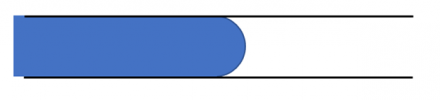

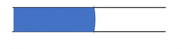

This is pretty visually intuitive: in the following picture:
The interface has a large radius of curvature, and so the pressure difference across the interface is low. On the other hand, in the picture below:
The radius of curvature of the interface is small – and so the pressure on the left side is much higher.

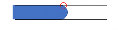

Another thing to know is this: there is something very peculiar about where the interface meets the walls around it, that location indicated by the red circle below:
Blown up to a larger scale, that location is a single point that represents the common meeting of three different materials, “fluid 1”, “fluid 2”, and the solid surface bounding them:
Now … the peculiar thing about this point of contact between three materials is that the thermodynamics (really the free energies of the materials) strictly defines the contact angle. That angle is fixed – and it does not depend at all on the pressure from one side of the interface to the other.
The result of all this is that – for an interface (like the interface of acrylic resin and vacuum on the pores) to be stable – both the curvature relationship of the Young-Laplace equation and the contact angle must be simultaneously satisfied. If they are both satisfied, then the interface will stay right where it is. The only way to change that – like to move the interface deeper into the pore system, is to create a situation where the Young-Laplace equation can not be satisfied.

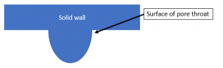

Re-enter into the picture the “model pore system” I started with (I warned you we would be coming back to this……):
Now, there is something truly unique about those “pinch points” I called pore throats. Lets take a really close up look at the one above indicated by the red dashed circle:
Because of the extreme curvature present at that very small point, it is geometrically possible to continuously satisfy the interface contact angle, even though the radius of curvature of the overall interface changes drastically. Three cases below illustrate this (hopefully).
Low pressure across interface:
Higher pressure across interface:
High pressure across the interface:
As the pressure across the interface goes up, the radius of curvature of the interface goes down (satisfying the Young-Laplace equation), contact angle continues to be satisfied because the small curvature of the wall at the pore throat allows that with very, very small movement of the actual contact point. The interface essentially is “stuck” at that pore throat, even though pressure from the outside is going up.
The interface is said to be “pinned” at the pore throat.

That changes, suddenly, when you increase the pressure so much that you get a situation like that depicted below:
The interface has been “pushed through” the pore throat. In this case, the contact angle continues to be satisfied, BUT the Young-Laplace relationship is NOT satisfied (the radius of curvature has gone UP, which should imply a lower pressure across the interface, BUT the pressure difference across the interface has actually gone UP. This is a physically unstable situation …. So the system will change to “find” a stable situation. That situation will be found deeper in the pore system at some smaller pore throat. The interface “jumps” forward (quickly!) and will then settle at some smaller pore deeper in the system (this process is called a “capillary jump”). The people getting oil out of the ground know this well – they use water to “push” oil towards a collection well – and they run in to the same issues regarding pressure and pore sizes in the rock).
One thing to note here is important: the minimum radius of curvature that the interface can take (and thus the pressure it can sustain before it “jumps” deeper into the pore system), is physically defined by the diameter (actually radius) of the pore throat through which you are trying to push that resin. Below that threshold pressure, you get no movement. Above that pressure, the interface jumps forward, and you get to fill more of the pore system (but not all of it – because the next smaller pore will require some higher pressure, etc, etc).
