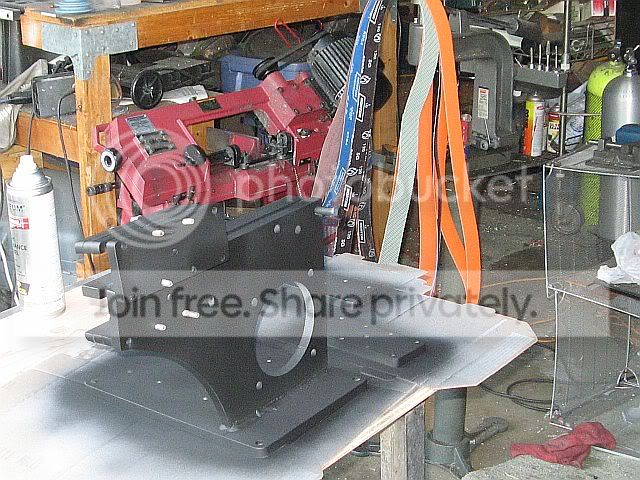

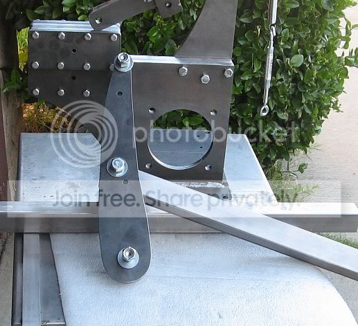

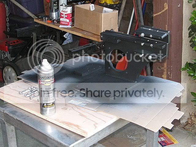

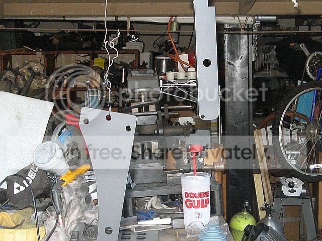

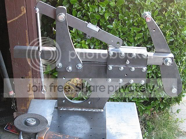

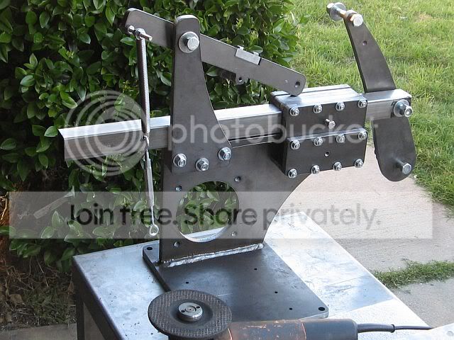

So the GIB came shortly after ordering it. It cost $260 shipped and comes in a priority box in a wood case. The parts are well made and built like a tank. They are all laser cut and the laser leaves a very, very rough edge that looks like it was chewed on by a rat. There was no way I would leave all those edges rough, it would drive me crazy looking at it over the years so I took out the angle grinder and ground down all the edges smooth. It took about 3 hours to get all the edges smoothed out. I took the upright and the base to the welder and had him weld it up. I tapped the holes but found a 50% thread engagement much easier to tap then the 75% it was predrilled for.

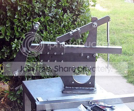

I cut down the multi platen so I could use the 4" and 2" wheel combination I want. I need to make flat platen for it and tool rest.
If everything goes right I have a plan to mount the motor and grinder and have it pivot to make it a horizontal grinder as well as an upright.

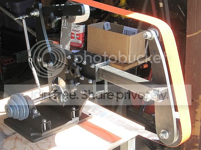

So here are a few picts of what I have completed and I will post as it progresses over the next few weeks.
Cost so far is $260 for GIB
Wheels, shaft and pillow blocks from Beaumont $402 shipped
Update and heads up..... Skip buying any spring for a screen door. It will not give you the tension you need. Go to lowes or Home Depot and buy a 69lb spring from the spring section. You can see the spring in the latter pictures in this thread.

I suggest you get your base and upright welded. It is far stronger then the bolt on option. Today Fedex is suppose to deliever my wheels, so hopefully I can get some work done on it today

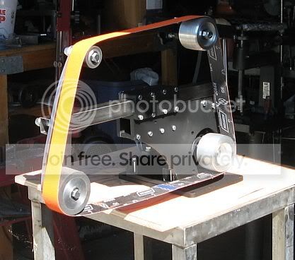

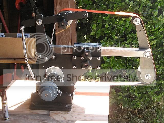

Fed Ex came and had some much needed parts:D This is kinda how I think I am going to mount the pulley-power wheel set up. I plan on mounting the motor behind the grinder on a hinge that can be adjusted to keep tension in a horizontal position. Time to go to Lowes and pick up some of the hardware to get everything mounted
It looks great. fyi - I have a single speed step pulley KMG, I am a neophyte at this stuff, the single speed works great for me and its SIMPLE. I like SIMPLE.

I went to TruGrit today and picked up some belts. It is a great thing to have them locally and they are real nice and helpful to deal with. I then did some priming and painting on the frame and it is now sitting and drying. Tomorrow I will assemble the entire thing. I still need to order a motor and have a couple of leads. I know as soon as I pay full price for a motor one will show up at 1/2 price...lol
Here are some picts
I did some assembling today. It all went together well. I need to work on the platen and figure out how I want that. I am going to get a stronger spring as well.
