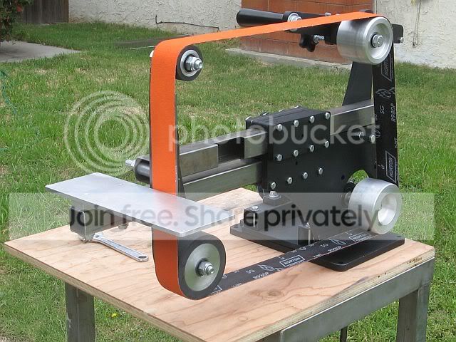

I thought I would put up what I ended up with washer and spacing wise to get the wheels lined up and tracking straight.
All of my wheels are from Beaumont and probably the spacing may differ from other wheels.
My 4" drive wheel is 1/2" from the face of the stand up
Idler 4" idler wheel is spaced with five 7/16" washers and one 1/2" nut.
The 2" wheel and 4" wheel are space with one 1/2" split lock washers
Two 7/16" washers equal the width of one 1/2" split lock washer.
This might help give someone a starting point on their grinder.

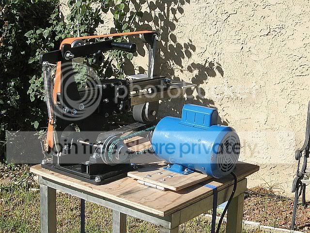

I received my motor the other day. The box looked like it had been rolled down a hill and hardly held it shape. I opened it and found the motor intact but with a dent in the shroud and a couple dings in the body. I wired it up and it worked fine so I am good to go. I have recieved steak packed with more styrofoam then the company used. The motor just blew through the styrofoam. They are lucky it was only a couple of dings. Anyways the motor runs smooth as glass and is pretty quiet so I am happy.

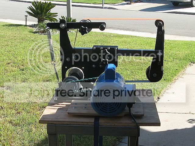

I finished cobbling the grinder together and made some changes. I had a wobble in the belt and had to do some tinkering with getting the drive wheel aligned to help diminish it. I had the belt tracking perfect with slack belt position but when rotated into platen position about an 1/8" of the lower wheel would show on the inside. So I went over and did a variety of tweeks and no matter how many things I might try the belt still would not cover that lower wheel completely while the belt was aligned with the upper wheel. After going over it with levels measuring angles and alignment. I decided to through a washer on the lower wheel then the alignment was perfect but of course when moved to slack belt postion there was a gap on the other wheel...lol
I went and got a 123 block place it on the tool arm and against the "Multiplaten" and the platen was not square. The "Multiplaten" was not flat. And of course the further from the axis of rotation the more it is out of square. So I need to take and either get the platen surfaced ground or maybe on a slow day I will put the mutiplaten on the linisher and then lap it to get it flat. For now I can live with a washer.

Here are some picts of the build
How much is it off? I don't expect it to be perfect (it is cut from a 5'x10' sheet) but I've never heard of anybody having a problem with it being warped like that. I just checked the ones I have here, and none are too bad.
Otherwise, that is a really nice build. Thanks for sharing it. To my knowledge, you are the second person to use pulleys with it. Would it be ok if I saved the pictures and added them to my website gallery?
